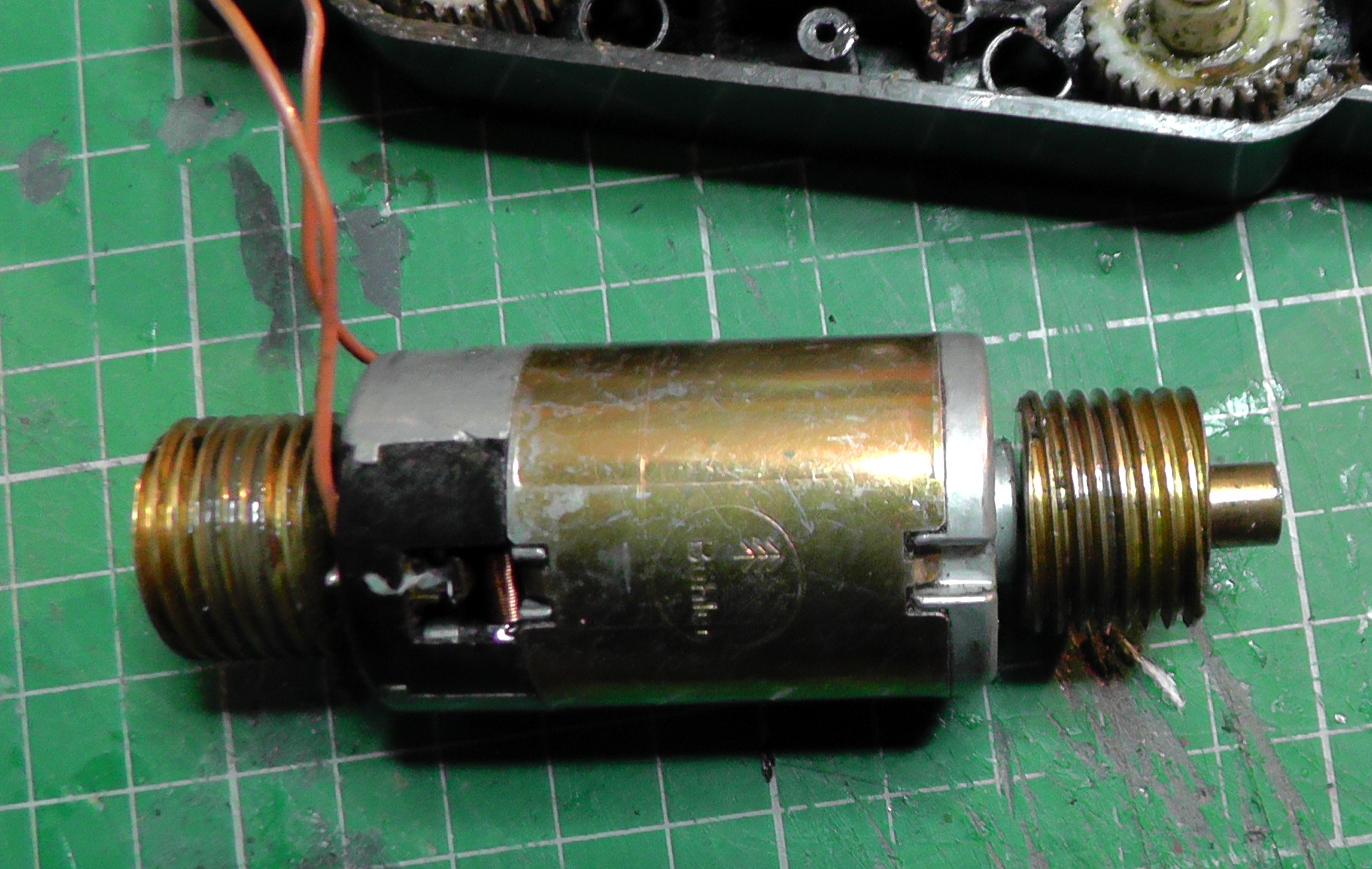

- Posts: 7983
Re: Weak Bachmann Lyn motor
Here's that the insides look likege_rik wrote: Mon Mar 01, 2021 3:54 pm .... the wheels are mounted on stub axles with a square profile designed to fit into a nylon moulding which includes the worm wheels. Not sure if I will be able to use them with a different type of gearbox arrangement.![]()
Might be tricky to mount the wheels - unless I can find a worm which meshes with the existing worm wheels

Well folks! Thanks very much for all your kind thoughts, suggestions and contributions - both in words and, in one case, in posting me a replacement motor - which I maybe won't need to use. I think I have identified the problem and fixed it (let's hope that's not famous last words!).
By cleaning everything up and then closely scrutinising all the bits I figured out that the motor which was installed in the motor block was actually a replacement to the original. The original mountings for the motor had been filed away and the corners of the motor had also been filed to clear the worm wheels.
BY watching carefully, I discovered the motor twisted slightly (by only a couple of mm) when under power. This was sufficient for the motor can to rub against one of the worm wheels. I inserted a self-tapping screw through the clamshell housing to engage with a slot in the side of the motor can. This seems to have done the trick. The loco now runs as well (or as badly) going forwards as it does in reverse.
My next task is to design and 3D print a bespoke clamshell housing which include lugs to hold the motor more securely. The plastic of the original housing is so brittle that all the pillars for the self-tapping screws holding it together have either split or completely disintegrated.
