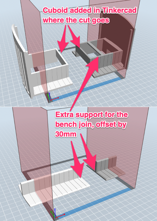

I've come up against the bed size restriction a few times. It's not a big problem - for example with Rik's short wheelbase van I had to cut both sides, but I just chose a suitably simple place to disguise the join - and because I printed in ABS it welded back together nicely.
I've been printing the Thingiverse bug boxes and there are more parts there that need cutting, the join needs to be good because it affects structural strength, and since I'm now printing in PLA I'm having to do it with superglue (ugh). Since there are variations on these I'm reprinting the same part(s) several times, and improving my cut-n-shut technique as I go: specifically I have modified the files slightly in Tinkercad to increase the surface area of the joint, which is very easy to do. Hopefully this picture explains it a bit better:
I've positioned a new cuboid and then sliced right through it, greatly increasing the surface in contact when I glue the parts together. I've also chosen to cut the frame and the bench in different places, so that each one strengthens the point where the other is joined. Again, to increase the surfaces contact at the join in the bench, I added a strut across the frame immediately below it. I think I'll start a separate thread for my builds of the bug boxes - there are several variations on these I've now got in progress...

That great to know Simon. How do you alter something from Thingiverse though. All I can do is alter the scale/size.
Meaning length, height and width.
SimonWood
Posts: 787
Re: Adventures with a Flashforge
Post by SimonWood » Thu Feb 04, 2021 9:10 am
FWLR wrote: ↑Thu Feb 04, 2021 9:00 am That great to know Simon. How do you alter something from Thingiverse though. All I can do is alter the scale/size.
I did these in Tinkercad which lets you import an STL file, it then treats it like any other shape, in this case I'm just very simply combining with additional cuboids but you can also use 'hole' shapes to chop bits out or whatever you like, really!
