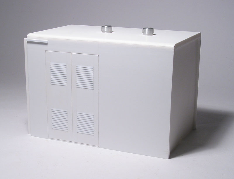

The first issue was that the chosen prototype had a very liberal supply of louvres scattered over most of the body access doors, so that was the starting point for body construction. The next photo is a composite and shows the first attempt at louvres on the left, which didn't work and the second method on the right that did.....
The first method is one I used in the distant past in HO. A sharp chisel is pushed into the polystyrene sheet to raise a louvre, then step and repeat. This was going to require a jig of some sort to line up the louvres and ensure even spacing. Even with all that, the edges can still be ragged and with something like 500+ individual louvres to make, this wasn't a very good idea.
The second method I've also used before in HO and involves insetting a louvred panel into each door panel. Luckily Evergreen make a suitable sized weatherboard sheet and I had some in stock, so this was the path forward. The photo is a test piece and you can just see the joints where the door has been assembled from various size strips, in much the same way as a traditional wooden louvre door is made.

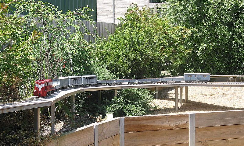

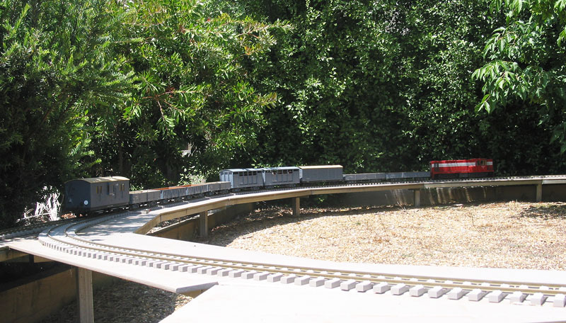

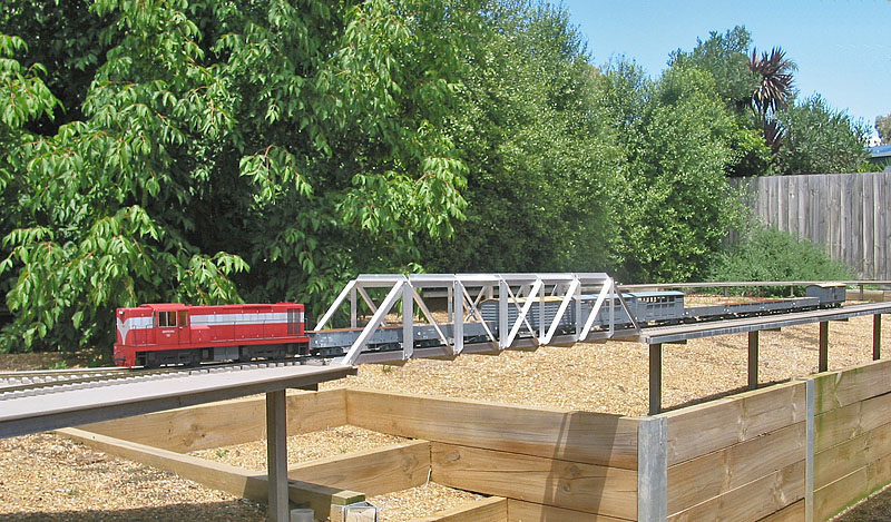

With the weather improving here the latest TVT motive power has entered service, taking the line into the diesel era.

We are now well into summer here and La Nina is fading, so the weather is more conducive to a bit of train running.
A couple of days ago the temperature was a balmy 20C, the few clouds were white and fluffy and the secateurs have been deployed. So there is now a train size hole through the greenery again and the new diesel has gone into service on the weekly goods train.
The through goods load is ten bogie wagons for a total of 40 axles, but well within the capabilities of the loco. I don't think I've got enough rolling stock to really load up this loco, as the rolling resistance of this goods train even on curves is only about 1/4 of the drawbar pull.
The first photo shows the train waiting for the off. I had to wait for a cloud to pass in front of the sun to take this photo, as the camera angle is pointing at the sun at this time of day and the lens flare overwhelms the camera electronics........
Next shot shows the train departing for the southern end of the line, which to confuse matters is actually the up direction on the TVT, via the great pittosporum forest.
Emerging into the sun again from the green tunnel along the back straight formed by the maple and the pittosporums.
Further into the run crossing the river flats and the girder bridge.
Approaching the end of the run through the curves between the junction and the yard.
Sitting in the shade at the end of the run, while the crew have wandered off in search of liquid refreshment. I still have no idea how long this loco can run with a heavy train and a full battery charge, but I do know it is significantly longer than my attention span.
Th-th-th-that's all folks.
