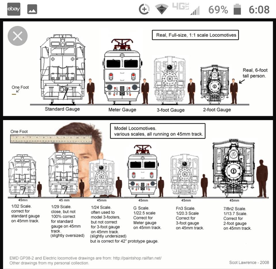

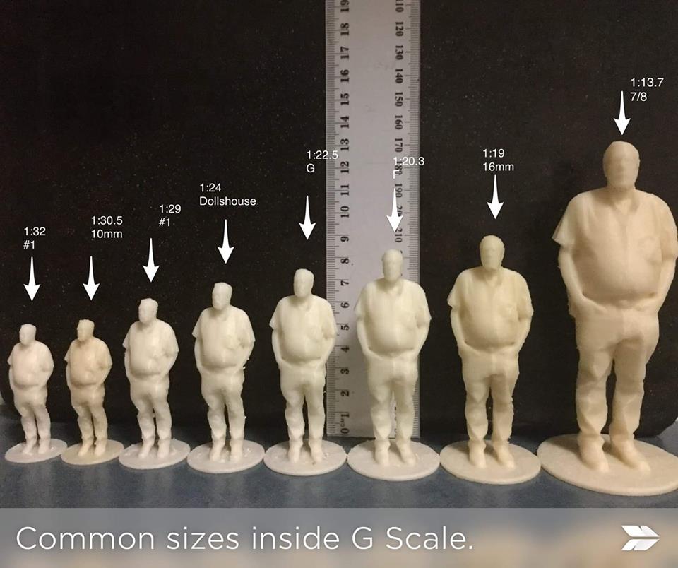

I find these helpful...
- Attachments
- Scale Men.jpg (79.1 KiB) Viewed 11698 times
- Scales.jpg (113.21 KiB) Viewed 11698 times

Re: Trying to get the various gauges and scales straight...
That's really good. Is there an equivalent for 32mm gauge, preferably including 16mm scale?
See viewtopic.php?t=8024CSL wrote: Sun Aug 09, 2020 10:14 amThat's really good. Is there an equivalent for 32mm gauge, preferably including 16mm scale?
