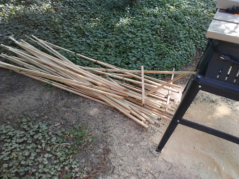

Today being a holiday I picked up some lumber to rip on the table saw. Hot & humid as Hades here... but fifteen minutes later it was completed though I was bathed in sweat and sawdust.
These will be used to construct the new switches as most of the old units ended up having their ties lost when I pulled them up from the previous layout. I hadn't treated those previous ties so the lifespan was good for only a few years.
Once the turnouts are built they'll be immersed in the treatment solution that I now use for ties which is a cocktail of used motor oil and diesel fuel.

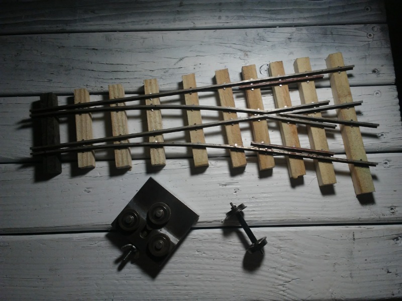

Alrighty then... spent some time fussing with the first of three right-hand switches. Temporary test fitting in the photo.
Previous switches were of blade design. In keeping with the mining theme of the new layout these will be of 'stub' design.

Nice work again. I like the stub point idea. It's a good start. You're making better progress than my current turnout build - it's been on the bench for well over a month now! I'm looking forward to seeing your track start to grow on the new railway.

Thanks Andrew. I've knocked out three over the past three evenings. The goal is to do one each evening.

Dwayne I am in envy of your turnout build. It a joy to see. Can I ask, is the rail bender made from wheels. It is a brilliant well made item. I am thinking if they are turned upside down they could be used for pipe bending.

Rod, here are two photos of my railbender. It was built by a late friend of mine who was a machinist. He machined the rollers to work with the code 250 rail I use. Each roller rides on bearings for smooth rotation. It is a great machine.

Excuse my ignorance, but how does your stub point work?
I can see that the converging end must move by a few mm to allow the rails to line up for each of the diverging and straight routes.
Does that mean there is some 'pivot' point up at the other ( divergent) end? If so, does that mean the whole point is screwed down to a 'baseboard' at that end?
Are there rail joiners on the 4 rails at that end?
A pic of one installed would probably answer all my questions.

Greg... these are the primary component of a stub switch. The rails that lead into the switch that move side to side will be installed when the switch is positioned in place. It'll be a bit before I actually begin laying track because of the weather.
