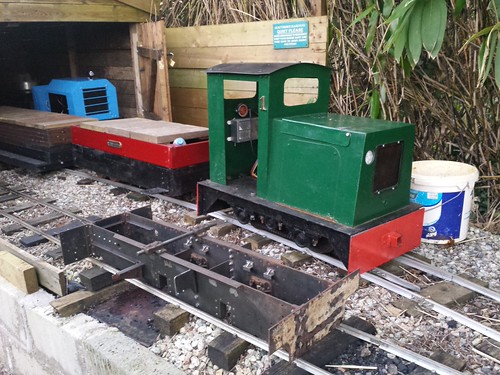

The frames as bought;
Image20180225_175348 by simon mace, on Flickr
Image20180225_174951 by simon mace, on Flickr
You can see the level of detail in these pictures. The model really does have every nut, bolt, and rivet of the prototype. Also, even though this is a relatively "modern" engine, there are still quite a few castings involved.
I cleaned up the frames, welded up a few unwanted holes, and drilled new ones for couplings of my choice (a typical multi-height industrial type on the front, and a simple link & pin type for the rear - both of these were bought as sets of laser cut parts via specialist suplliers on eBay).
After a coat of paint, things look a lot better:
Image20180307_190504 by simon mace, on Flickr
I like to use Rusoleum brand paints, mostly brush applied.
For the chassis, I used satin black and gloss red, applied straight from the tin. This paint takes quite a long time to dry fully, but goes on well and seems quite tough.
