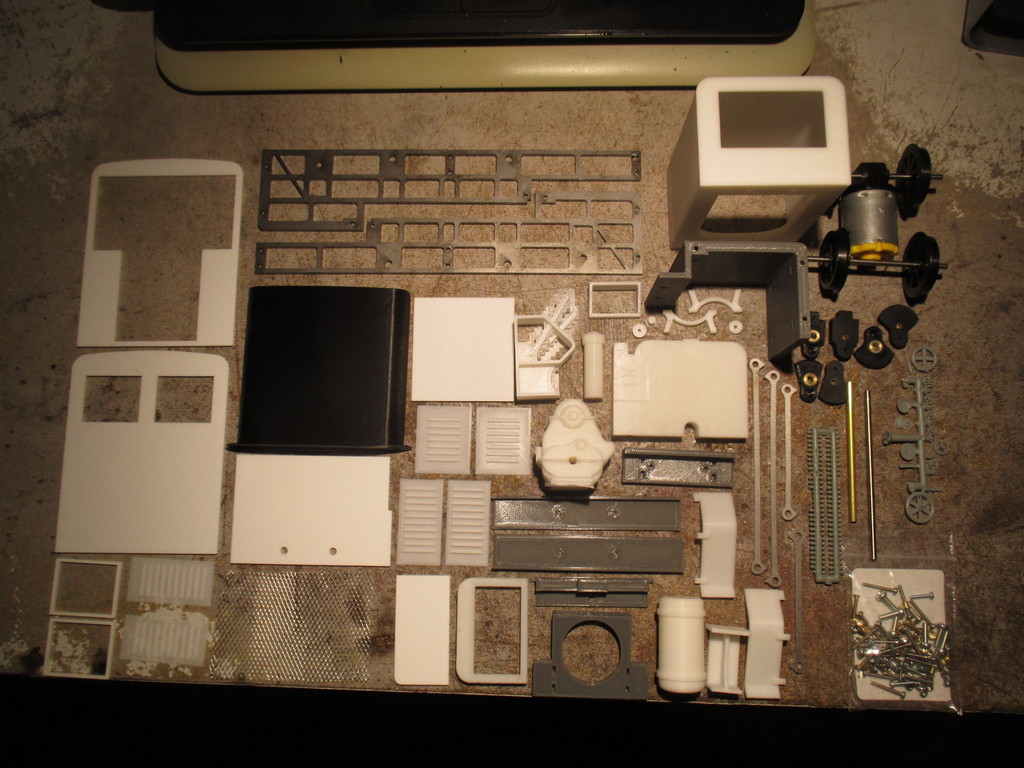

The kit arrived complete and undamaged, which was very fortunate - the box hadn't been taped shut prior to dispatch! Quite understandable, what with the current workload that Peter and Leanne are facing. No harm done. I was particularly impressed with the wheels (Slaters?) - judging from photos until now, I thought they were Binnies. (Nothing wrong with Binnies of course, most of my stock rides upon them)

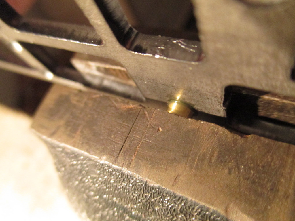

The instructions state that the frames' axle holes are to be drilled out to 3.8mm. Well, I don't have oddly-sized drills, so I thought I'd just try a 4mm bit, and see how the bearings fit. Worst case, turning new bearings to fit oversized holes wouldn't take long.
As it turns out though, 4mm rendered an excellent press-fit to these bearings. A bit of retaining fluid was applied with a screwdriver, simply because I had some.
The mini vice was quite handy for this.
As this is the newer version of the kit, with rather nice laser-cut frames and rods, the frames' screw holes are no longer countersunk, and phillips-pan-head screws are provided. Preferring hidden screws, I countersunk the holes with the 4mm bit, and have ordered new screws to suit.
Few kits I've assembled screw together, so it was a nice change to be able to easily run a dummy assembly to see how the completed loco will look. Unsure weather to paint it green or yellow, but either way, it'll look just right as an early I/C loco in the canefields. Given that a number of Hunslets, Baldwin tanks and Simplexes of the Great War were later sold to Queensland sugar mills, the prospect of a Baldwin tractor in the canefields is plausible.

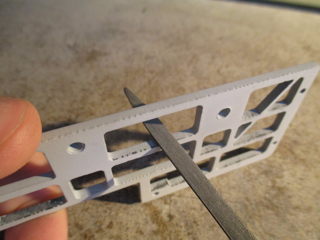

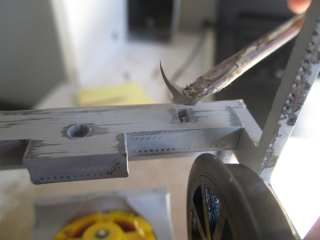

A coat of filler primer helped in smoothing the slightly rough laser-cutouts. The burrs left from countersinking were also filed away. The primer was cleaned from the bearings with cotton buds dipped in thinners.
Some very minor bowing was straightened, in readiness for assembly.

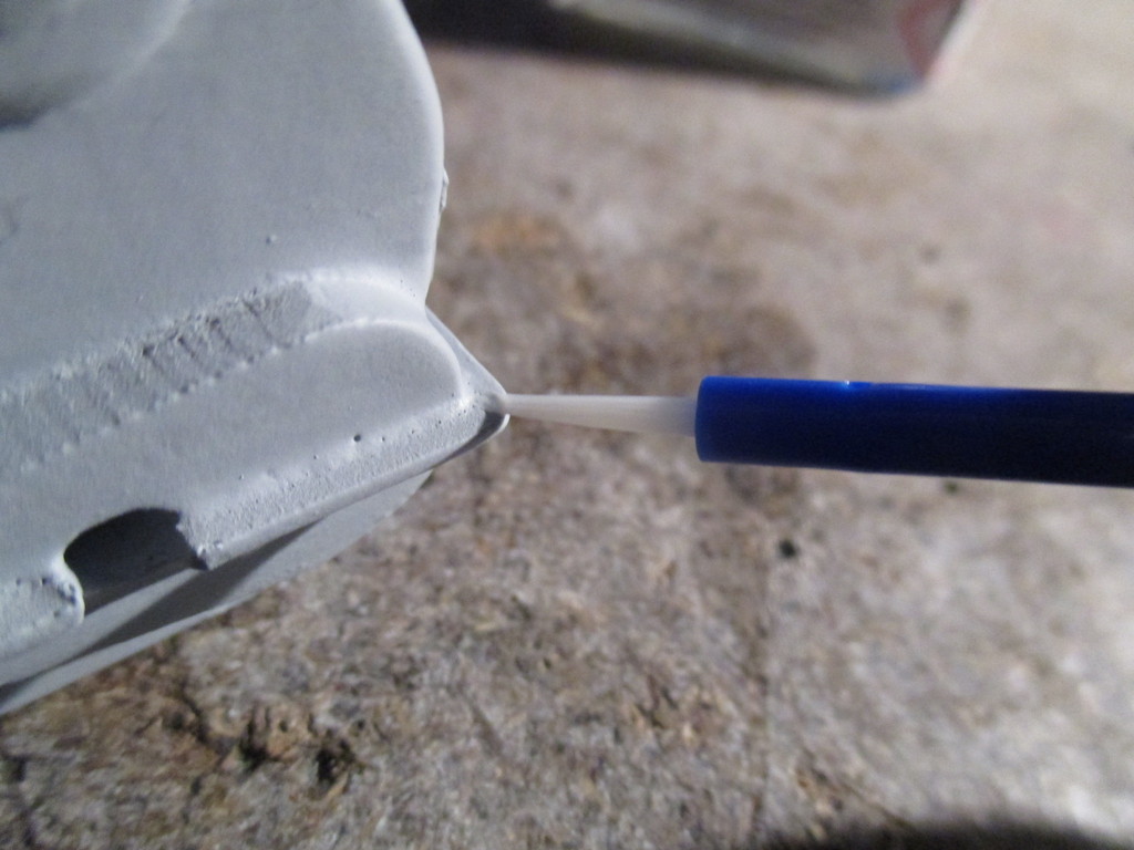

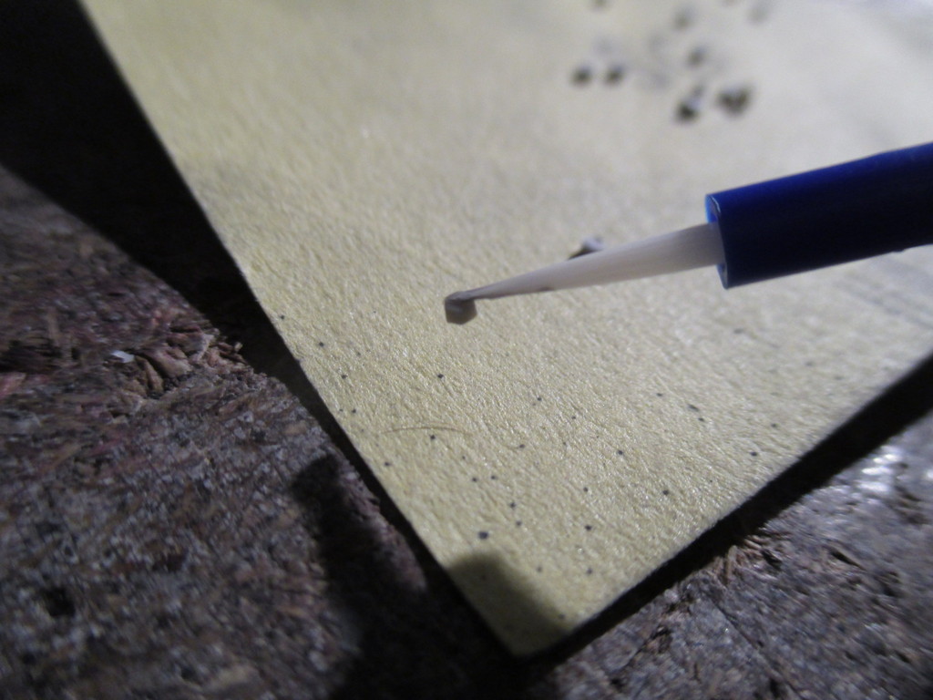

I hadn't used these "MENG" bolt heads in years. Very nicely moulded, but a sh*t to apply. In hindsight, using tweezers and a fine-tipped glue applicator wasn't the right way to use these.
This time, I thought I'd try solvent weld - and what a difference that made. A small drop was applied to the gearbox.
Whilst the brush was still wet, it could be touched against a bolt head to pick it up, then placed into the puddle of solvent and dissolved filler-primer on the gearbox. The head then sticks into the puddle, and the brush can be withdrawn.
Letting it dry for a minute, followed by a light re-application of solvent to where head and gearbox meet, helps them stay stuck together.

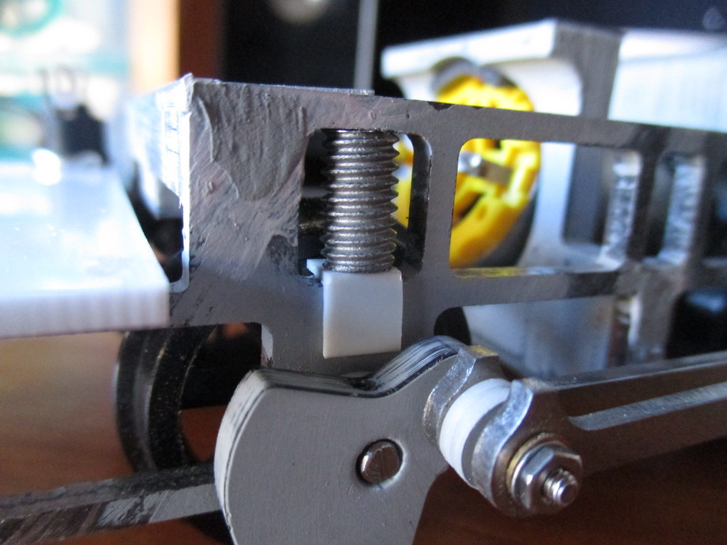

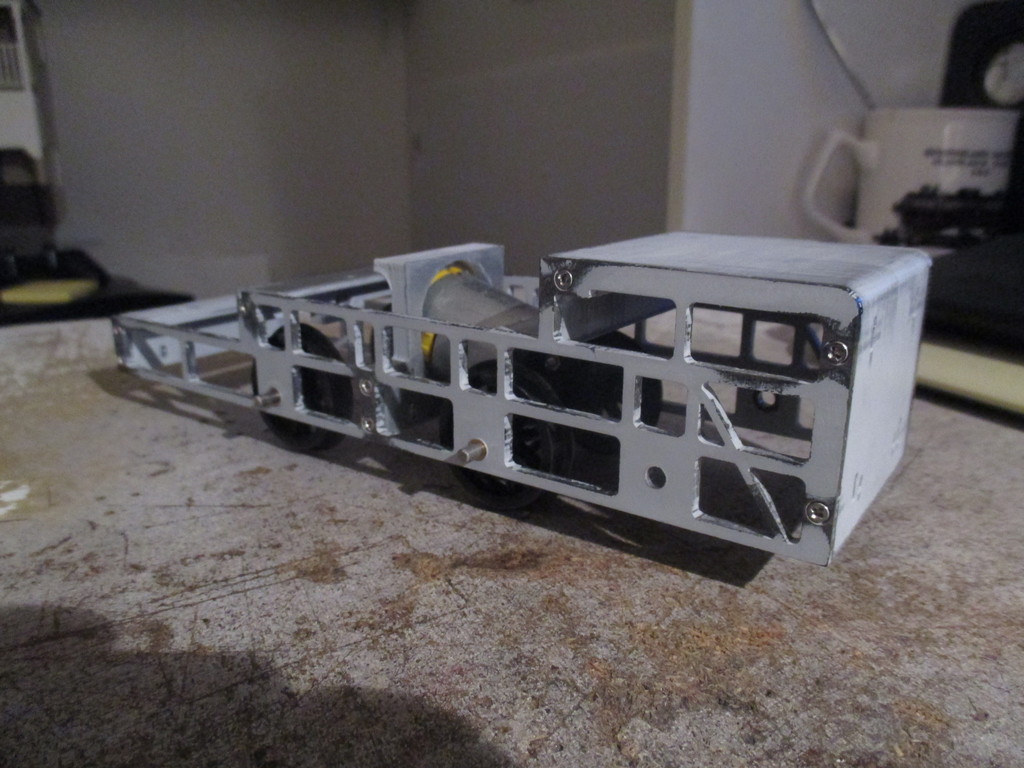

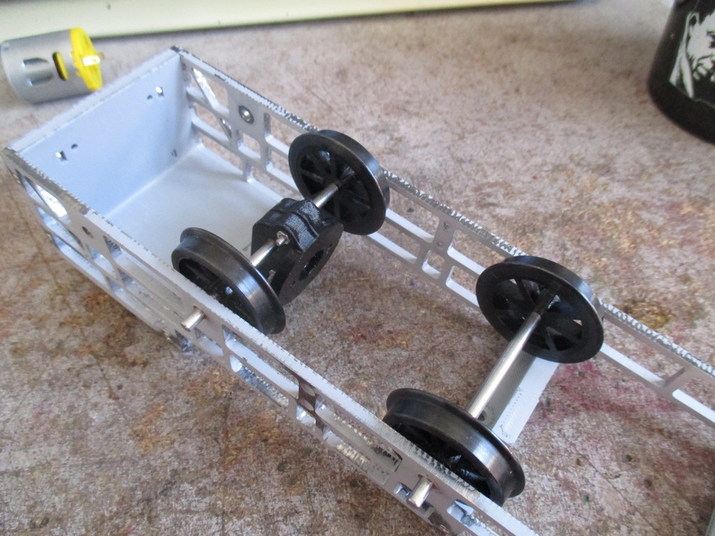

The countersunk M2 screws arrived surprisingly quickly, allowing the chassis to go together. Emery boards were quite good for finishing the visible surfaces of the frame stretchers.
Whilst the front axle was a nice, free-spinning fit in it's bearings, the rear was quite stiff. Checking the assembly revealed nothing untoward, so I opted to simply bed the axle into place. A little light oil applied with a flat blade screwdriver, and twenty minutes with a cordless drill, had the axle running as smoothly as it's counterpart. I'll have to remember to de-grease around the axle with cotton buds and alcohol, before painting..

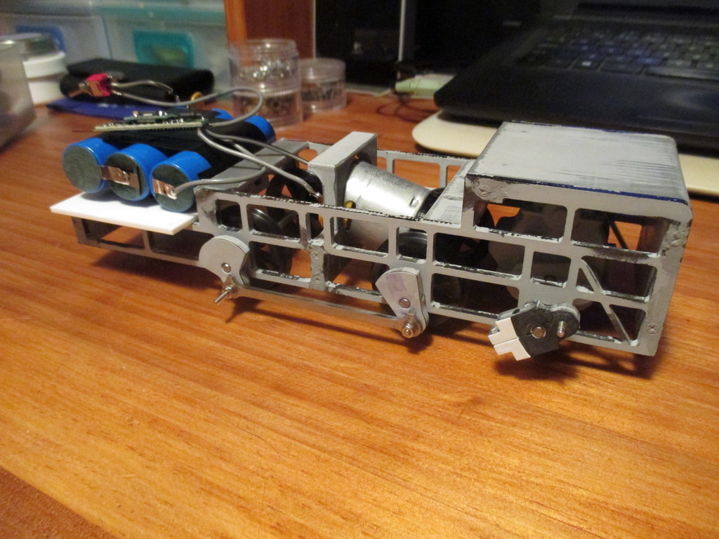

I realised that soon, I'm going to need all of the electrical components on hand, to work out where they'll fit, so I've ordered an Mtroniks soundcard from Chuffed2Bits. It sounds uncannily similar to the prototype, though I'm no fan of the card's horn, so that won't be used.

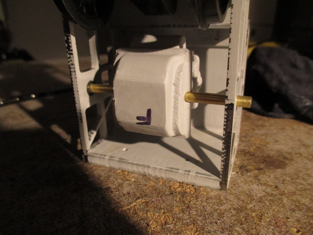

This morning, before proceeding with fitting the gearbox, I figured I'd best remove the motor, and make absolutely certain the front axle spins freely. It runs so nicely in fact, that it's shown me the rear axle still needs quite a bit more running in with the drill before proceeding..
I know there's plenty of ways to quarter a wheelset, but I don't plan on quartering enough locos to warrant building or buying a jig. I think I'll go for the simple method of using shims and a 3" engineers' square. Will get to that soon enough..
Checked the wheels an axles with digital verniers - axles are ⅛", wheels are 30mm dia. The wheels are a tight fit on the axles. But if one only rarely wanted to switch gauges, one might get away by just holding the axle with vice grips, and twisting the wheels along the axles to change their gauge. That said, the spoked centers are only plastic, so they might not hold up to repeated twisting. Just my thoughts anyway..

After another spin with the drill, I realised the gearbox cover's nut slots needed filling, before I impede access to them with the gearbox itself. Might as well fill the rest of the slots whilst I'm at it. I've been hearing a lot of good things about Squadron putty, so figured I'd give it a go. Very nice to use, though I never realised just how quickly it hardens. I suspect using it when our 40° Summers roll around, will be interesting..

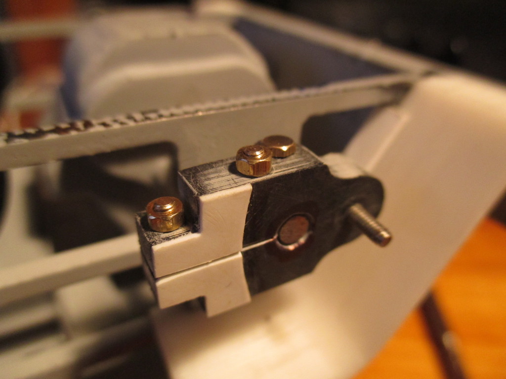

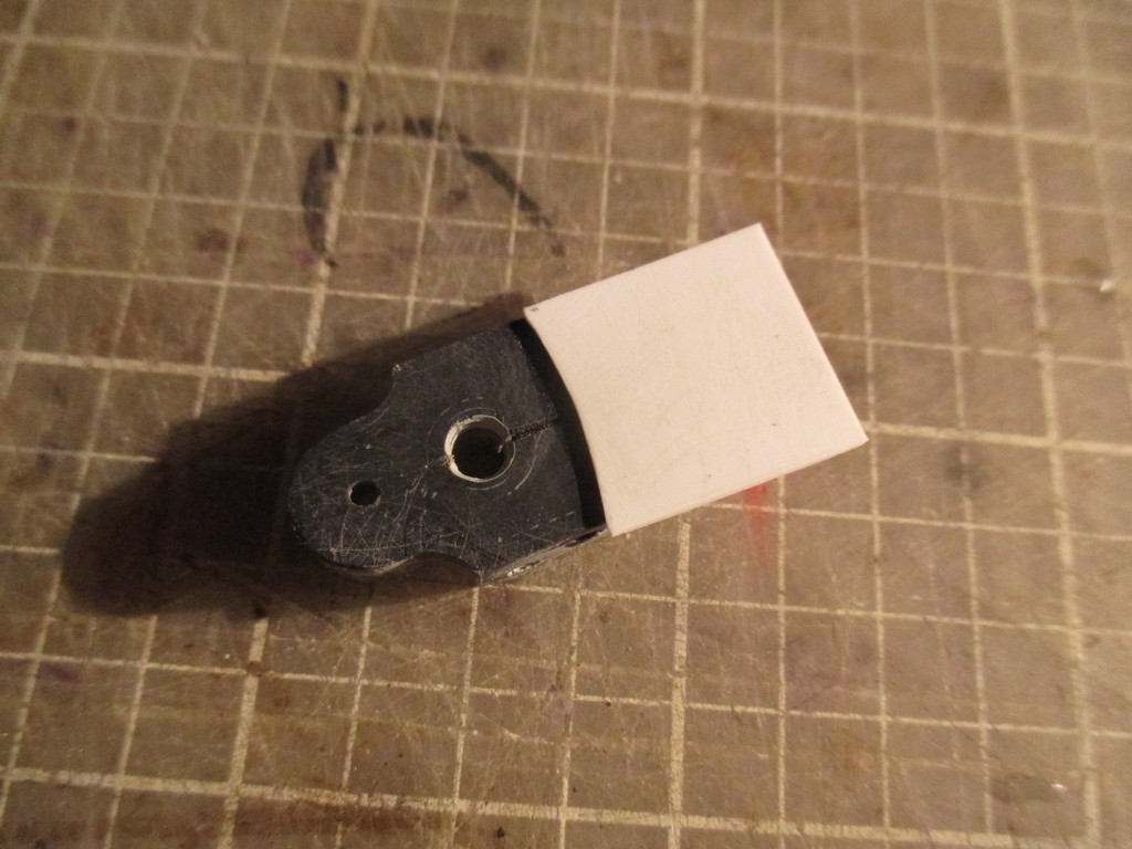

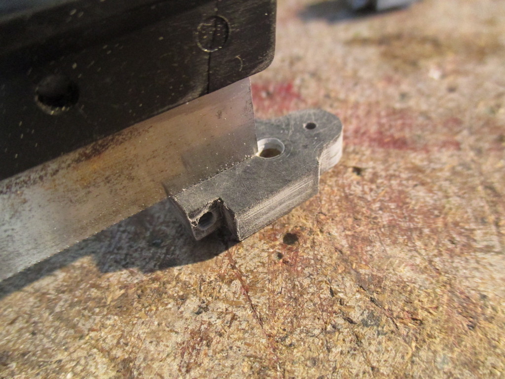

After sanding and filing the cranks, the splits in the front cranks were started with a razor saw, then opened out a little, with a triangular file. A razor blade is very good for removing the burrs left behind.
Replicating the prototype's second crank clamping bolt is a good opportunity for extra detailing. I should've started the hole closer to the center-line of the crank, but didn't want to obstruct the grub-screw hole with the dummy clamping bolt's head. The hole was drilled about ¼ through the crank, to 1½mm dia. A spare M2 screw was then screwed into the hole.
The crank was then flipped over, and the M2 screw could then be used as a guide, to align the hole on the other side of the crank. Why not just drill through in one go? Too much hassle to set up in my cheap, sloppy machine vice, which would likely have ended up holding the crank on an angle, making for a crooked hole. I'll get to cutting and fitting the dummy clamping bolts later.
To make the the "stepped-out-bit" of the counterweight, a radius was carved into scraps of ½ millimeter styrene, which were then fitted with solvent.
The excess material was then removed, and the slot cut as before.

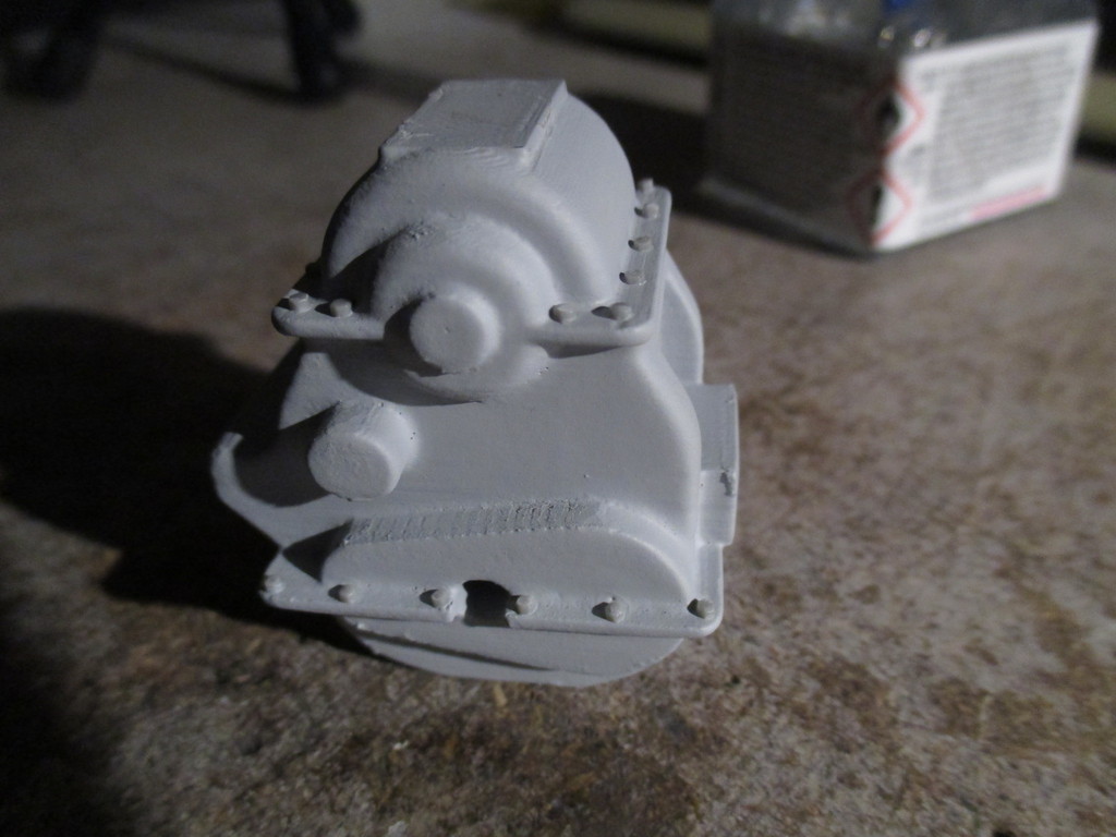

After sanding and filing the putty, the gearbox was finally fitted in place. I thought about using retaining fluid, but as this axle just flops around, I opted for superglue.

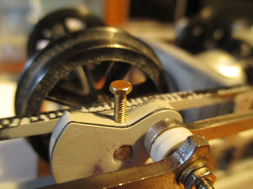

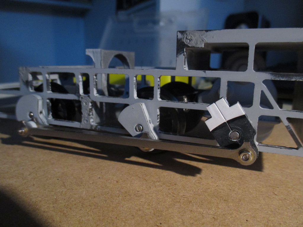

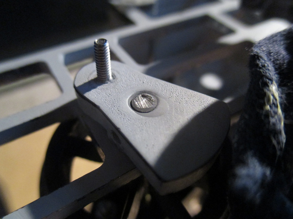

26/06/20

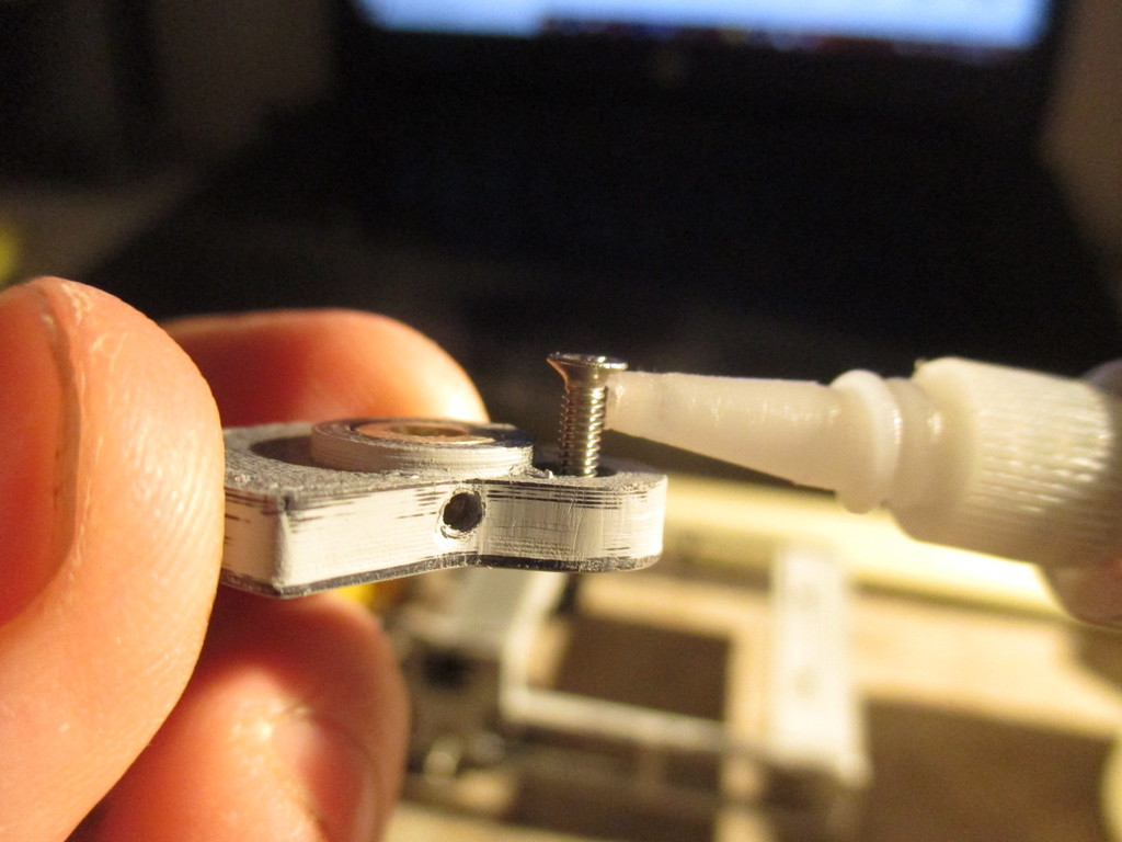

The crankpins were reinforced with superglue - I'd have preferred threadlock, but I don't believe that works with plastic threads. We'll see how it holds up..
Be gentle when screwing the crankpins home; the thread in the crank is easy to strip. The crank was then temporarily fitted to a spare ⅛" axle, to check by eye, weather the crankpin was parallel to the axle. None of mine needed adjustments.

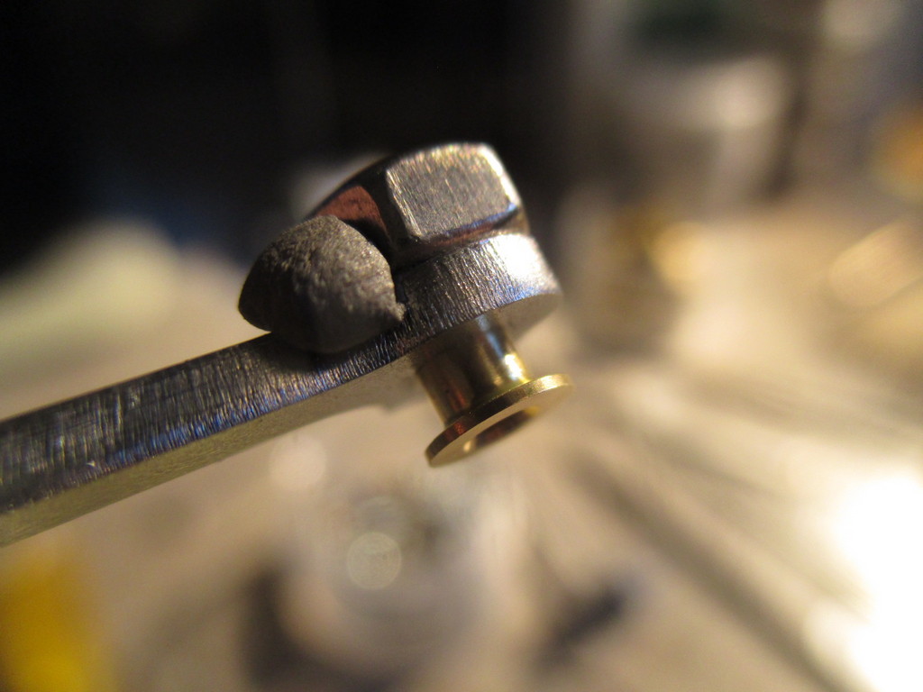

27/06/20

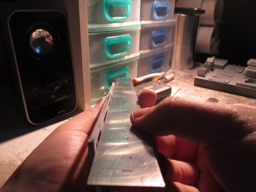

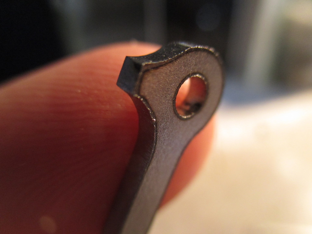

The rods all needed some straightening. Again, gentle is the key.
Minor burrs left on the rods were removed with needle files. I don't remember if I had to enlarge the holes to fit the bushes.
As the bushes are longer than the rods' width, an M4 nut was blu-tacked over the bush hole as a spacer, prior to applying retainer and pressing home.
28/06/20
The connecting rod was fouling on the front wheelset's crankpins, so a pair of M2 washers were fitted to the jackshaft crankpins, as spacers. I couldn't even fit the rods without drilling out all of their bushes to 2.2mm - that's a fair chunk of slop, in my book. Wasn't my first choice, but I couldn't find any issue with the assembly thus far.
With the motor still disconnected, the quartering was done. The "set square and shims" method was a farce, so I ended up using the "twist, tighten, check for binds, twist, tighten, check for binds, etc." trial-and-error method. Predictably, this took some hours over several sessions. The coupling rods were done first, and once they were no longer binding, the connecting rods were then fitted, and the jackshaft cranks quartered.

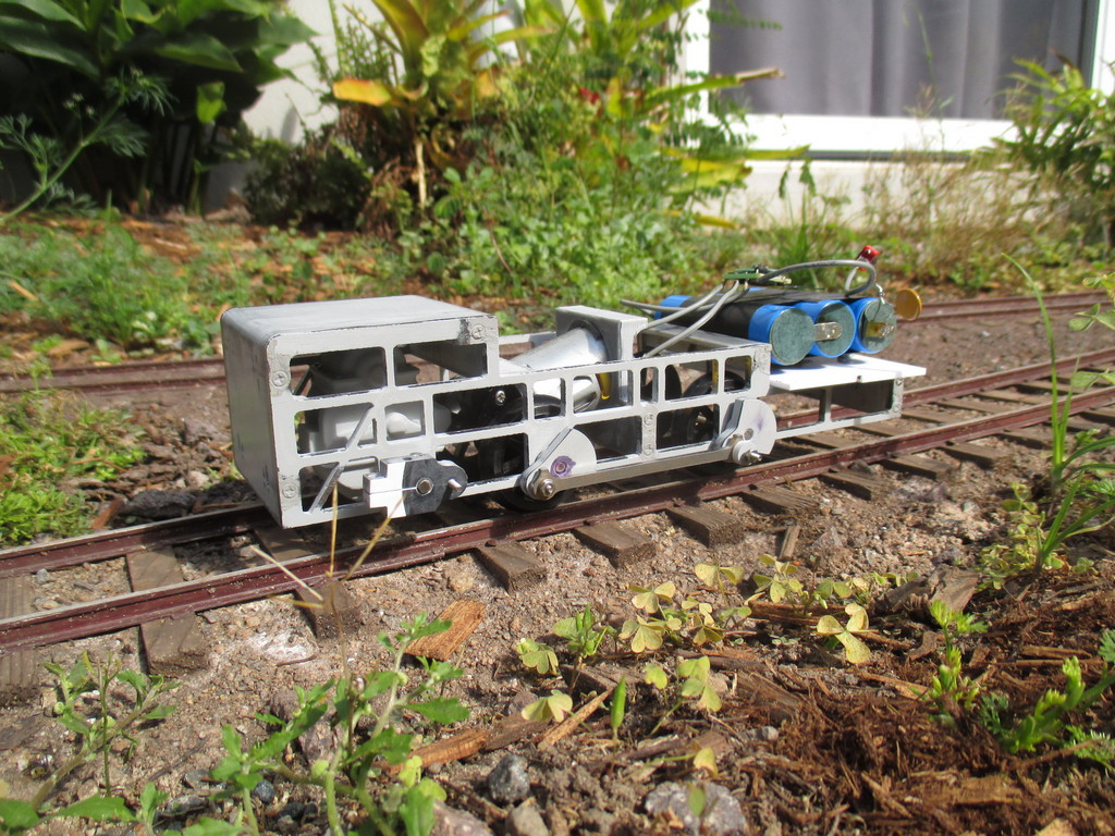

01/07/20
The chassis can be pushed freely by hand in both directions, with no binding. After roughly seven hours over three days, I don't want to have to do this again and I don't trust a single grub screw to hold the quartering. To reinforce, a drop of superglue was applied to each axle end, allowed to run into the joint, and the excess quickly wiped away. It'll be trickier to paint now, but all it really means is some extra masking.
After allowing to sit overnight, the motor was refitted, and temporarily wired up with a Deltang receiver to re-check the motion. The difference in running by motor rather than hand, was day-and-night - absolutely awful, terrible binding. I don't believe the quartering has been disturbed, so I'll have to try and make some sort of homemade quartering jig to make certain each axle is identical.
I for one, would be content to pay a little extra for a printed quartering jig to be included in each kit - or even as a separate item. Feeling a bit gutted over all the wasted time and energy spent quartering, I put the kit away and resolved to finish the new workshop before returning to the Baldwin.

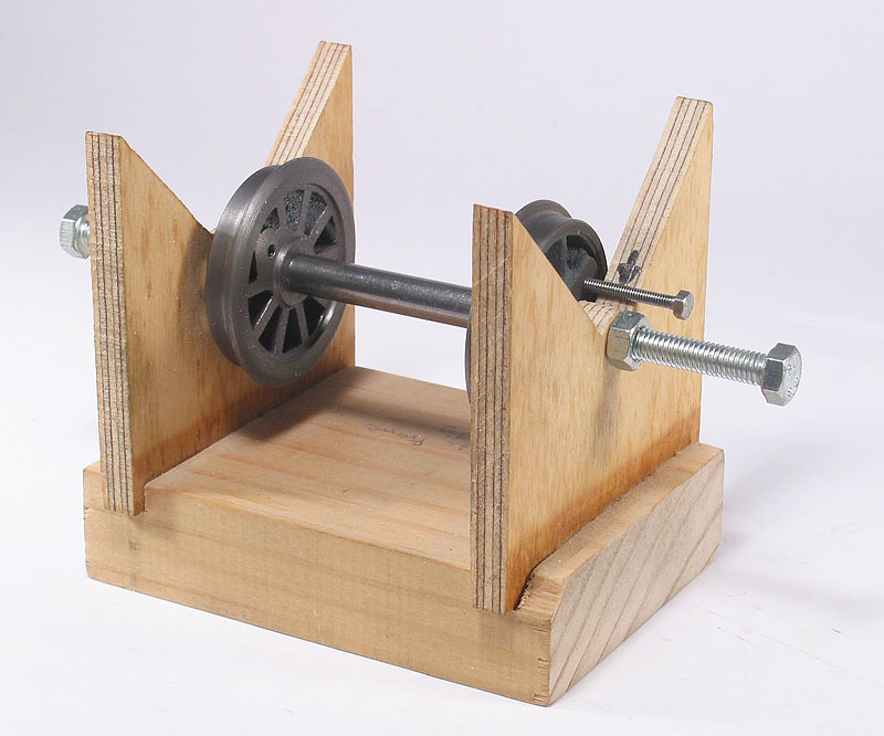

FWIW, the photo shows one of my quartering jigs, based very loosely on the old NWSL HO scale one, which was mostly plastic.
This one is for inside frame wheel sets and I later made a wider one for outside frames. It was knocked up 10 years ago when I was rebuilding my Argyle Philadelphia, which had led a hard life before I got it.
I centre drill all my axles for aesthetic reasons, but that also means they can be supported in the jig by the large plated screws, which have a 60 deg point turned on them. I made special long shouldered crankpins for use when quartering, but the ones I needed for the photo have gone AWOL. The screws in the wheels give the general idea on using it though.
The jig is completely open in the middle, as the loco this jig was initially built for had valve gear eccentrics on one axle, preventing the axle from being located in a v-block. Using the centres also means it works on any dia. of axle.
I have an allergy to complex jigs and don't use them unless absolutely necessary. This one is simple and took maybe 1/2 hr to make from scraps of ply and wood in the workshop and an overnight wait for the glue to dry. Routing out a trench for the ply sides makes the whole thing much more rigid than just glueing them to the surface of the base block.
Not a flash toolmakers job, but it works fine and has now successfully quartered three scratchbuilt steamers with inside frames and will be doing a fourth before the end of the year. The outside frame version has done two locos so far.

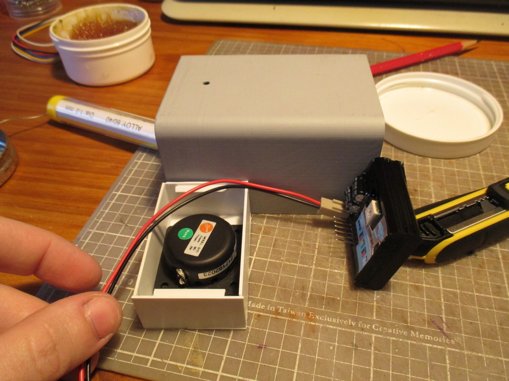

04/10/2020

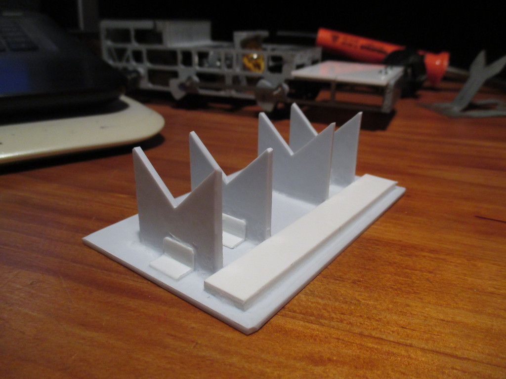

Having completed the workshop some months ago, (minus a bookshelf I keep forgetting to build) and the test tramway mostly built, I found myself delayed in upgrading an existing part of the fleet, for want of an ultrasonic cleaner. Whilst that's in the post, I decided to (at least) get a quartering jig made, for the Baldwin tractor.

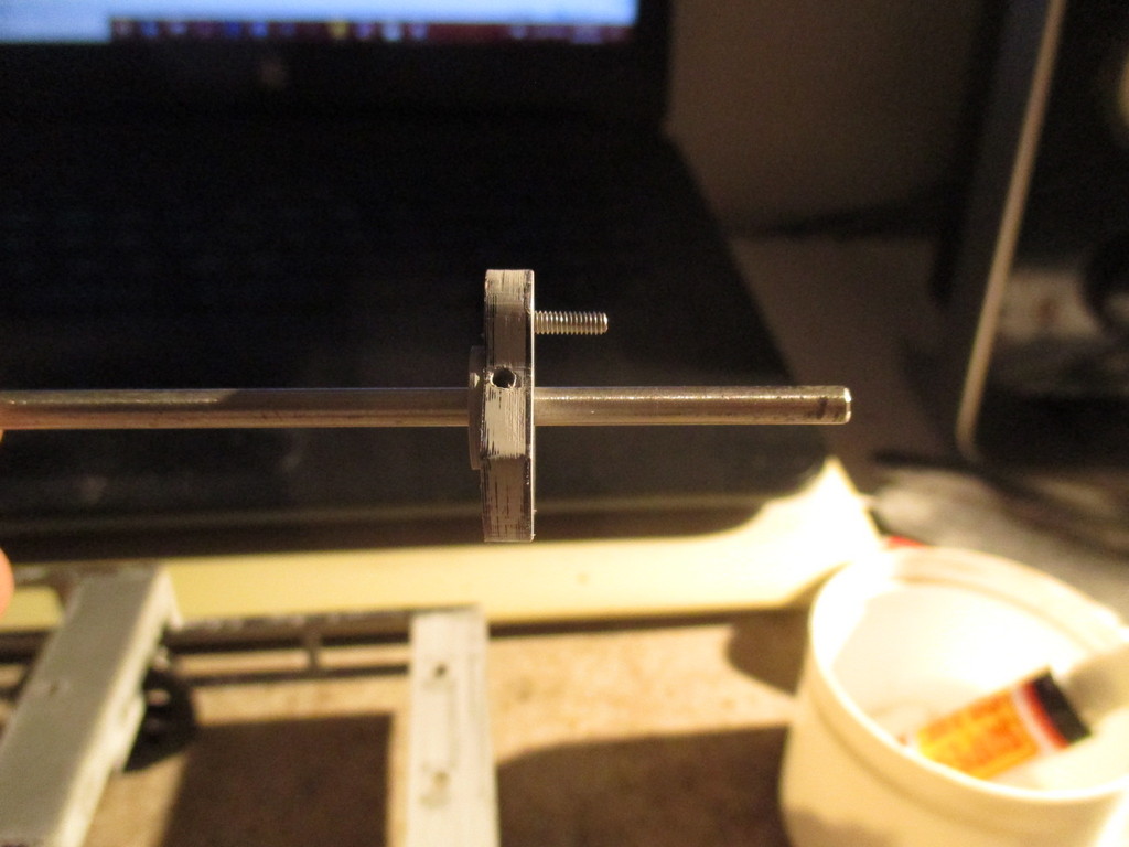

Graeme got me thinking about removing the axles, facing and center-drilling them in the lathe, but I couldn't be bothered removing the gear from the front axle. Writing this though, I've just remembered I have a NWSL gear puller which would've made that job much less painful. Ah well, weathering hides all!
I digress..

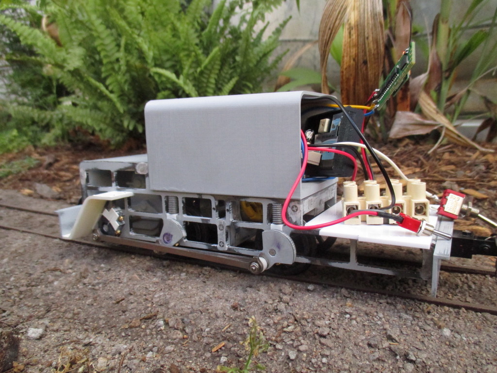

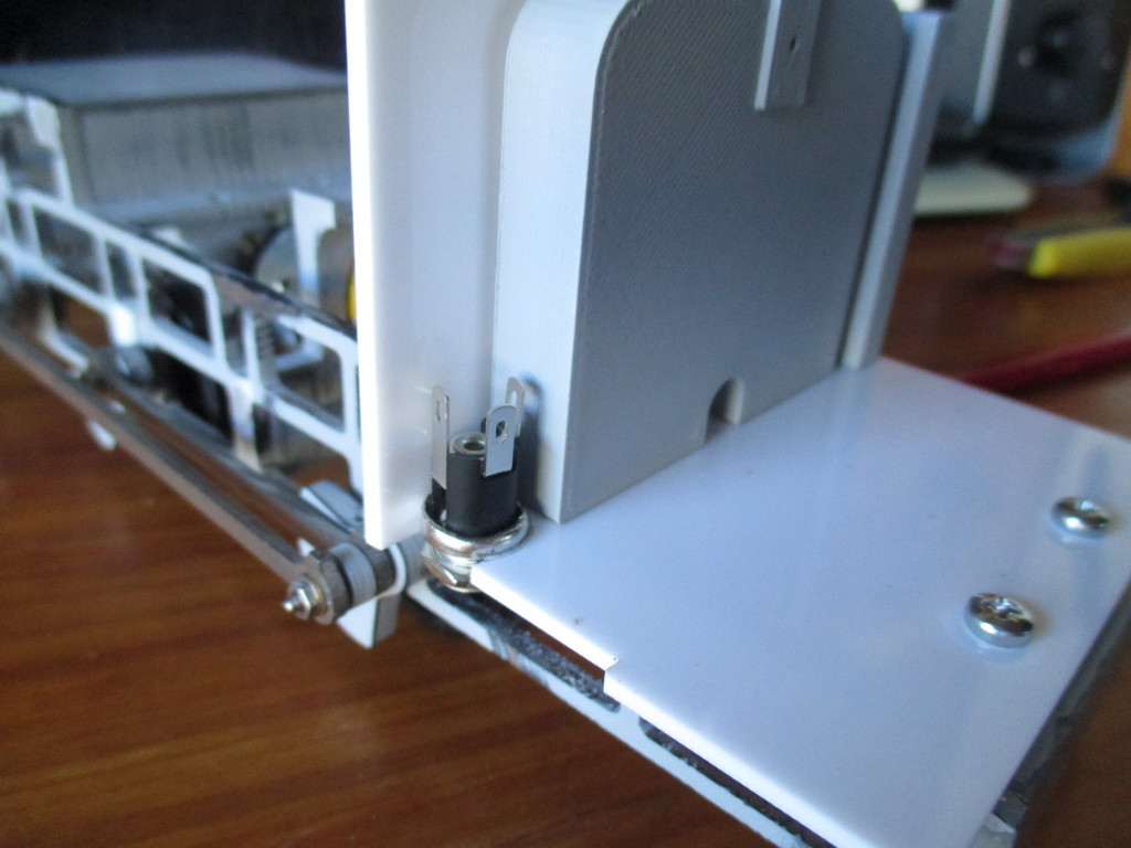

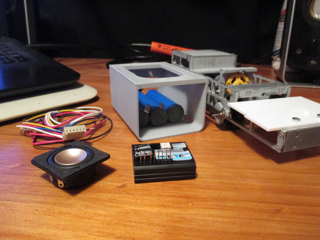

Ideally, I'd have made this jig from 6mm ply, clamping the pieces together and cutting the "V" with a bandsaw, using a fence to keep the cuts straight. No space for such a tool though, so hand-cutting some 2mm styrene had to do. The 3mm foamboard offcut was used as a fence to keep the axle supports in line. Very crude, but it worked.

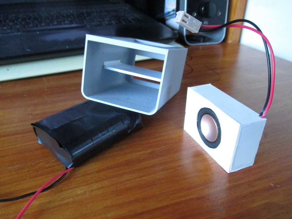

As the batteries I'd previously used for testing the chassis under power were now installed in the track-sweeper wagon, I had to individually charge the 18650 Li-Ion cells I'd bought for this loco, and work out where everything would be fitted in the bonnet. This would determine the layout of the batteries, and allow me to assemble them into a pack. Then I could check the newly-quartered chassis under power. Not shown here is the Deltang receiver, which will likely also be mounted in the ample bonnet.
With the temporary wiring re-connected, the loco now runs quite smoothly - for two or three revolutions, as the crankpin nuts tighten themselves and clamp the rods solid on one side of the loco, whilst the other side self-loosens. I've double-nutted the crankpins but none too well, as I don't have a 1mm thick spanner to properly hold the nut closest to the rod. Seems okay now, running along 3ft of workbench.. I'll loctite a single nut on each crankpin and test again tomorrow.
Another bench test over morning coffee was successful. But one thing needs attention before a track test - The motor, sitting in it's hole through the frame stretcher, has a little wiggle room, and lightly rattles against the stretcher when running in reverse. Some thin foam rubber was found in the pertinent scrap box in the garage, then two small shims cut and inserted above and below the motor, to take up the space. A tiny drop of superglue on the stretcher ensures the shims don't work loose.
I digress..
A very brief track test (as all bearings besides the pre-lubricated gearbox are dry, and will remain so until painting/weathering are done) showed that the loco runs smoothly and quietly. No doubt this will improve as it runs in, but that's a ways off.
Writing this now, I've just decided to have the loco running for the up-coming open day in just under a fortnight, at the AMRA club's track in Brisbane. Should pass the time waiting for the ultrasonic cleaner for my Fowler, anyway.. Regards,

Before the speaker enclosure can be sealed, the wires of course need to be trimmed and connected. Having the bonnet behind helped determine the wire length. The speaker is a nice little unit from Jaycar. I'm looking forward to seeing how it sounds with the Mtroniks soundcard.
06/10/20
With the speaker enclosure done, a shelf was fitted within the bonnet, upon which the batteries will sit. One of these days, I'll remember to buy an assortment of large heat shrink, and stop holding my battery packs together with electrical tape..
07/10/20
As the cab and bonnet both screw to the chassis, I would like the wiring not to permanently tie these modules together. After a lot of umming-and-ahhing over wire routing, I decided to hide the charge socket within the left-side sandbox. Whilst the right-side sandbox is printed along with the driver's console, The left-side box isn't included with the kit. This suits my purposes well, as a printed sandbox would be filled with internal supports, which would've had me fabricating a hollow replacement anyway.
The U-shaped "spring-bearing-axlebox-pusher-downer-things" (You know when you have the proper name of a part at the tip of your tongue?) were represented with cut-down pieces of ¼" styrene angle. The springs were cut slightly over-length from spare M6 bolts, then filed to fit and retained with superglue. The filler over the countersunk screws in the frames was filed flat and re-applied where needed.
Mudguard time. For whatever reason, I didn't spray these with filler-primer when the other parts were done, so they took quite a lot more sanding than they otherwise would've. Even then, the top sides were left raw, as I decided to fit overlays of .005" styrene. Don't have any drawings of the prototype, but photos were adequate in working out the rivet locations, marked in pencil. Twisting a small Phillips screwdriver makes a decent rivet head in this thin material.
I had to make this overlay twice, after making the mistake of fitting the parts together with solvent - which caused areas of the overlay to shrink and leave hollows in the surface. Superglue to the rescue again.
I was however, able to use solvent when allowing myself to get carried away in detailing again. Having done the mudguards like this, I've shot myself in the foot - I Doing anything less to the bonnet and cab would likely look bad in comparison..

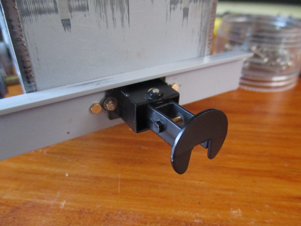

Quite some thought was given over couplings. Cant be bothered soldering up brass angle to make proper scale jobs, so I'm opting to use a spare pair of Accucraft chopper couplings. (I'll admit those are pretty good, if a bit long)
My excuse is that this loco was sold after the Great War to some other line that ran with low-slung choppers. The loco was later sold to it's current owner (Fictional Unnamed Sugar Mill Co.) which had slightly higher couplings, around 22-26mm above railhead. In typical industrial fashion, they simply flipped the buffers upside down to move the buffer faces a little higher, better-suiting the local stock. It's still a bit low, but I'd like to slightly lower all of my couplings to a height more befitting a cane tramway as it is.
I experimented with permanently-fitting a chain to the chopper "blades" pivot bolt, but during a test too brief to photograph, this tended to pull wagons off the line over tight pointwork. For now, I've flipped the buffers the "right" way up again, but will likely replace the main pivot bolts with the "hook" type pivot pins.
The headstocks were sanded and drilled to fit the couplings, assembled with M2 hex bolts and some very nice one-size-smaller nuts.
Another issue the brief test revealed was that the grub screws holding the quartering were unsurprisingly not to be trusted. I have a special hatred for grub screws, especially when they force me to half re-do the quartering again, but by hand, because the rods were retained with loctited nuts, preventing re-use of my jig.
So I did what I should've from the start - binned the grub screws and cut down some spare M2 bolts to be as un-obtrusive as possible, and use those as a compromise of appearance and retention. I doubt even I will notice these extra hex heads in operation..
At the same time, the dummy clamping bolts were added to the front cranks.
06/10/20
07/10/20

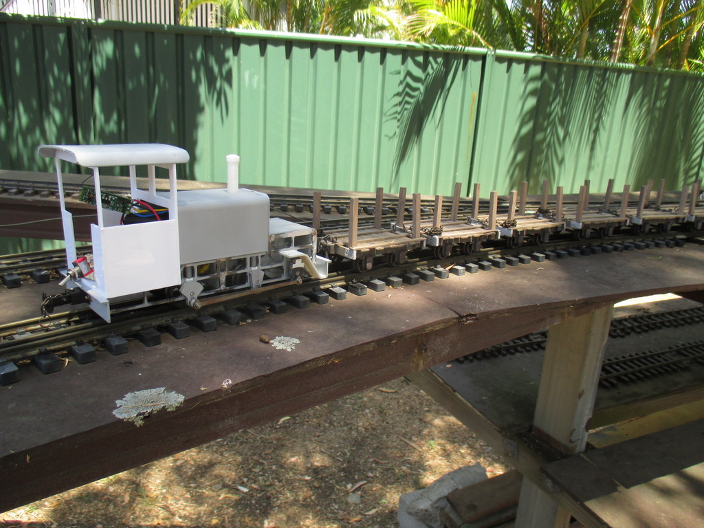

Thanks Peter, it was a good and very busy day, due to earlier train shows in 2020 being cancelled.
The Baldwin managed alright with the wholestick trucks at home, but it struggled and slipped very badly at Zillmere. I'll put this down to oily residue, but even so, these trucks are far heavier than they need to be. They were weighted to 270g each, to negotiate a terrible S-bend imposed by a tree on my first tramway, which is thankfully long gone. They were brought to be sold off anyway, and the planned replacement rake of thirty cane trucks, will be much lighter than these.. In any case, I'll have to discreetly pack some lead into the loco. The cab was mocked-up with Blu-Tac, and a cutting disk in the dremel was used to cut a hole in the front panel, to allow the temporary wiring to pass into the cab. Whilst I'll keep the roof, the walls will be replaced with something fabricated from angle and sheet as-per the prototype.

After almost five years, (and many times' considering) I've finally picked this one back up.
PDF was very helpful in supplying a set of 32mm frame spacers, though it took quite some time, and the motor mount spacer wasn't included.
So I cut down the original on my 2" table saw. In hindsight, I could've just done this from the beginning..
I also realised that smearing Squadron putty over the Phillips screws holding the frames together, was a bad idea, and replaced them with (to my eye) less obtrusive slot screws. A skin of 0.4mm plastic was bent in hot water, and fitted over the front end of the frame.
The printed bonnet and doors were sanded down, and the doors (which had curled up years back, as the spray putty dried) were straightened after softening in boiling water. I seem to recall snapping one of the doors trying to bend it cold, so a replacement was fabricated.
I'm rather pleased that happened, little changes like that are needed to turn this WWI-era loco, into a well-used industrial machine.
This has also tipped the scales on weather I paint it early green, (20's-50's) or late yellow.. (50's-70's)

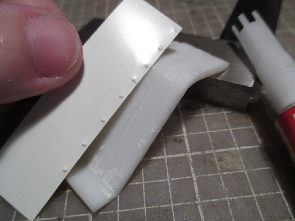

After fabricating the tiny dummy hinges, the bonnet had a few panel lines scribed.
227 rivets were marked out, drilled, countersunk and fitted with my usual favourite slivers of metal. I haven't done any modelling since early October, and had forgotten just how time-consuming these projects are - The bonnet has somehow taken 13 hours to rivet, and I still have a row over the back end to do.
