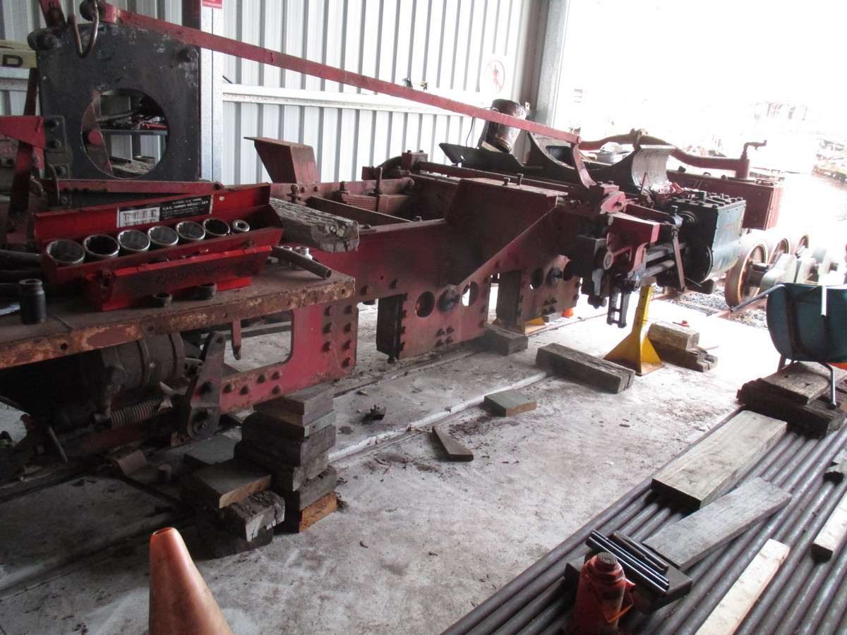

btw - more updates from the restoration of full size Fowler at Steam Workshop :

and the video is interesting. I would have invested in a needle gun to clean up the wheels etc.

Happy to hear you're getting something out of the blog. It usually functions merely as a backup for my failing memory. :roll:
Aye, Airdmillan is up the front of our storage compound. Like most things at Woodford, it looks worse than it really is, but we'll likely never get around to doing anything with it, due to having too large a collection and an extreme shortage of active hands. No shortage of armchair enthusiasts whinging about it all slowly returning to the earth, though.. :scratch: :roll:
Here's the only shot I have of the loco. Ironically, I took loads of photos of it for a mate of mine last year, whom decided to build a static model, and needed reference material. Sorry to tell you I no longer have them, as I don't need the photos myself, and am running out of hard drive space. There's too many photos for him to email me any useful number of them, and what with this plague about, I can't visit him to get copies. For the same reason, (among others) I won't be getting to Woodford any time soon..
Quite sorry about that - normally, I'd be in much better a position to help.
I do however have a few shots of our flagship, Bundaberg Fowler No.5, taken when it's drivers were returned from re-machining back in September. Being a virtually-identical copy of Airdmillan, I hope these photos might be of some use to you.
