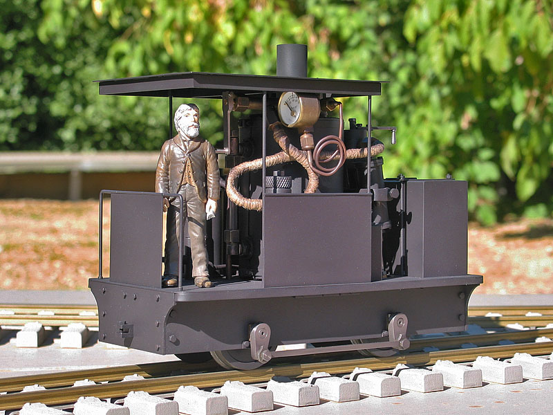

Painting was completed over the Easter weekend and the last photos show the model standing in the afternoon sun today. The paint is dry, but not fully cured, so the first revenue run won't be for a while yet. At least I know it now runs, so there's no hurry and the next run will depend on the weather.

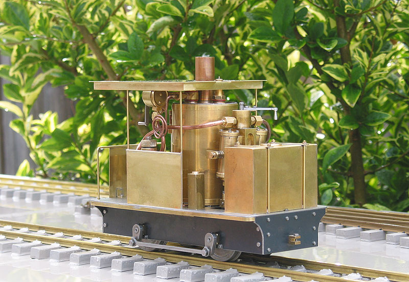

By now we are approaching Australia Day 2018 and the model has all the working bits finished. The photo shows it assembled and ready for a steam test on the rolling road. Plenty of time to fit bodywork and complete it by Easter 2018. Hah.....
That's when the trouble started. The first burner fitted was a ring burner built to the Idris drawings, which flat refused to work properly in the loco. The gas lit easily, but it burnt in a fireball outside the firebox and heated up everything but the boiler. Rude words were uttered.........
A ceramic burner was then fabricated and fitted. This worked OK and could build up steam pressure in the boiler, but the osmotor now decided it didn't like running on steam, for no discernible reason. More rude words were uttered and various modifications were made to the osmotor, all to no avail.
At this point the tram was named Canardly ** and left to sit in disgrace on the end of the bench while more promising projects were pursued. Now and again something else was tried, but basically it just sat there developing a nice antique patina.
Step forwards about two years and I was tidying up the workshop after finishing the track extension. The tram was still sitting there in disgrace and I decided to see if a Roundhouse boiler was capable of steaming the osmotor on it's own. It couldn't, but with the motor out of the chassis, I finally noticed something didn't seem right with the cylinders. This time when tested again on air, the osmotor refused to work at all.
To cut a long story short, I finally worked out that the cylinders were faulty and there was a path for the steam between the ports. I suspect that when the cylinders were originally soldered to the port blocks the solder didn't completely penetrate the joint and there was some flux left in there. This was enough to seal the joint when first tested on air, but was washed out by condensate during the first steam tests.
A few hours work, a new set of cylinders later, and the osmotor was running again on air. More importantly it now ran nicely on steam as well.

I'm afraid you will be waiting a long time for a video, as I don't own a suitable camera and I don't own a mobile phone. Just your common garden variety luddite.....
The driver figure was made by Schleich some years ago as part of a family set of wild west settlers. Long gone from the catalogue, but I guess they turn up from time to time. As supplied he had a cowboy hat in his left hand, but I carved that away so it looks like he is holding a rag.
