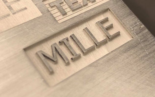

I've just bought a 50W fiber laser engraver and have spent the day playing around with deep engraving brass. Results are promising so I will now be able to make nameplates etc. without the hassle of etching. Since I also have a fiber laser cutter, I can cut engraving blanks inhouse.
0.8mm depth, brass
sdeep brass.jpg (29.76 KiB) Viewed 6563 times
1.5mm depth, brass
sdeep 15ms.jpg (25.17 KiB) Viewed 6563 times
1.5mm depth, aluminium
sdeep alu.jpg (37.42 KiB) Viewed 6563 times

How small can you make nameplates with this technology? My Dad had a OO scale "Royal Scot" that he wants nameplates for, he was asking me about it but I don't know if they make them this small.
Busted Bricks
Re: Nameplates
Post by Busted Bricks » Mon Dec 30, 2019 12:18 pm
I'm not familiar with how big a nameplate would be in 00 scale, but a fiber laser is capable of very fine detail. If you give me some dimensions I can make a test.

Just to prevent disappointment to anyone, I should make it clear that this is not a commercial venture at this point and may not become one. AFAIK there are already several UK suppliers offering nameplates at very modest prices. I recall someone saying they got a pair for under £10. It would honestly not be worth my time to try and compete with that. I'm not really setup to deal with retail customers at present - I mainly cut for other businesses.
I run a laser cutting business full time now and some customers have enquired about having logos engraved onto items that I cut for them. That was the motivation for buying the fiber laser engraver. However it's a nice bonus that I will be able to engrave my own nameplates.
