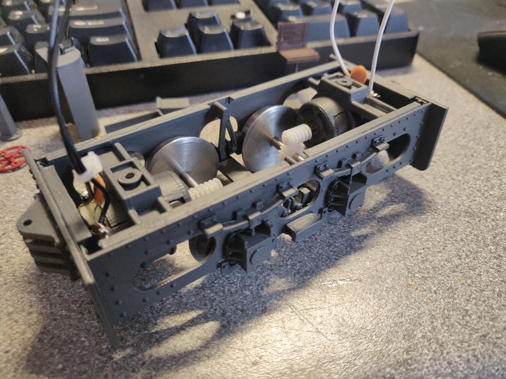

When I saw Mike Pinder's drawings for this loco in May 2019's 16mm today, I thought this it would make a nice quick build, a couple weekends worth of work. 5 weeks later and it's still not done...
I recently got a finer 0.25mm nozzle for my 3D printer, and wanted to see what kind of detail it could achieve. I built a prototype chassis, with an extended motor shaft driving a worm on the opposite axle, like the underside photo of loco in the article. A printed clip on assembly held the worm to the spur gear and gave the appearance of the gearbox from the underside.
This didn't work. There was too much friction for the little 130 size motor, so I went for a traditional setup, but still with two motors.
The motors are the type with the flats on each side, so to try and make them look round extra printed bits were added, also used to mount the motors.
