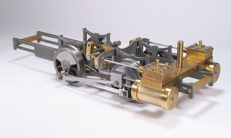

The next photo shows the cylinders and valve chests completed and the coupling rods fitted. This was the first loco built after I fitted a DRO to the vertical mill and the rods went together with little adjustment needed to get it running smoothly.
This photo shows the con rods and valve rods connected, as well as various detail bits. Still some detail bits to fit, but it is now ready for setting up the valve gear and test running on air.
It lives....... This photo shows the loco chassis running on air on the test stand, ticking over on less than 10psi supplied by my old airbrush compressor.

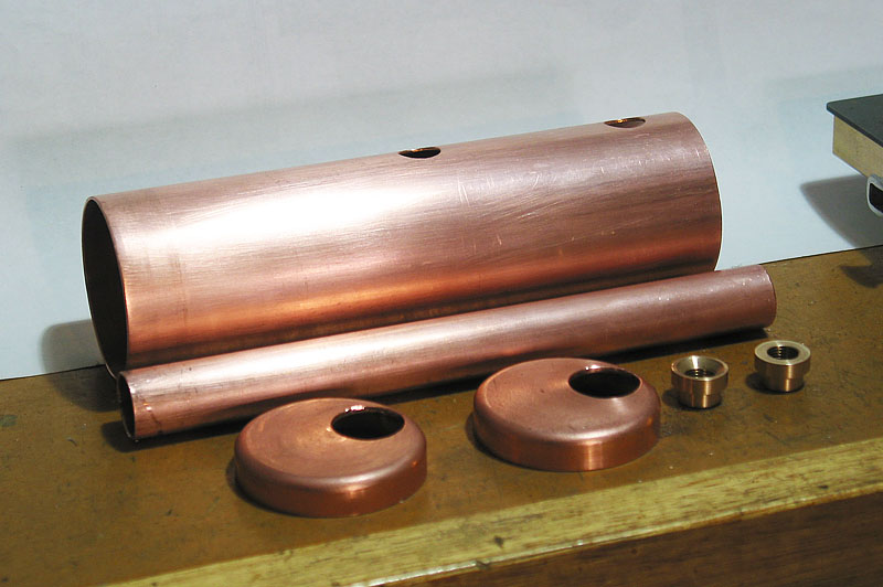

Boiler construction was next and this one was simple. The cab of the model is very cramped, so a gauge class wasn't fitted. Just a bush for the safety valve and another for the throttle and steam manifold. The first photo shows the parts ready for brazing and the second shows the completed boiler holding test pressure. Being a simple design it was brazed in one session.
These little Baldwins were very small locomotives and a scale diameter boiler would be 35mm dia. and 135mm long. Far too small to get a decent length run, so a larger boiler was crammed in. It turned out that a 1.75" dia by 150mm long boiler would just fit under the saddle tank and fit into the cab. Fitted with a 3/8" flue and a burner with a 0.15mm jet, this will carry enough water for a 20 min. run.

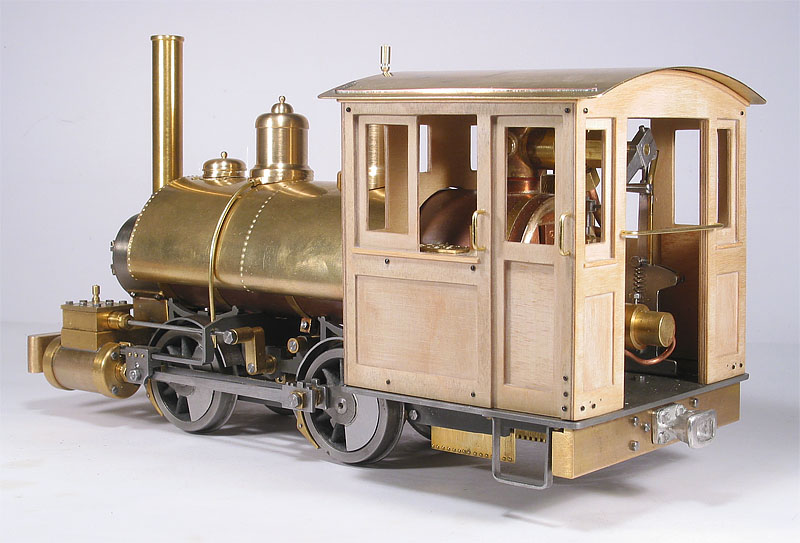

The next photo shows the boiler fitted to the frames, with a mounting bracket on the smokebox and a sliding block on the cab floor.
The next jobs were to fit the reverser, lubricator, regulator and safety valve, shown in the next photo.
The last parts needed to make it a working steam loco are the gas tank, gas valve and burner and these are shown fitted in the next photo. Using square tube to fabricate the gas tank allowed it to be fitted below window level in the cab and carry enough gas to run out just before the water does.

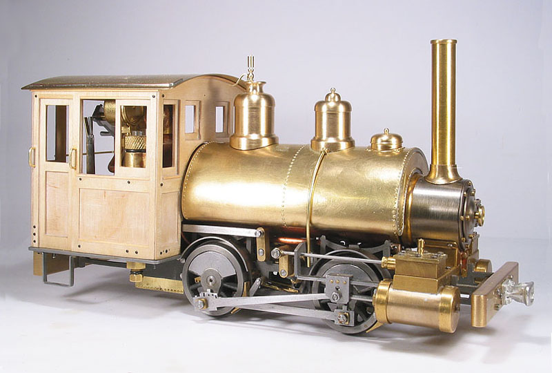

........ and there it sat for a few weeks while I fought the Walker railcar into submission. I finally got back to the Baldwin and fabricated the cab out of birch ply, then made up the saddle tank and the boiler fittings in brass.
Baldwin domes and sandboxes of this period are much easier to make than those on a british loco, basically just flycut the base so it sits nicely on the saddle tank, then turn the body curves. No flared bases to make.......
The saddle tank was riveted in the usual way with the punch tool I use, then rolled to the correct profile and the front soldered in place. The next photos show the more or less completed model ready for the paintshop (when the weather improved). Note, the gap between the saddle tank and cab front is deliberate, Baldwin left a gap there on the real ones.
This photo shows the valve gear fitted to this model. The Stephenson gear is a Gordon Watson design and fully working.
Finally, I ran out of excuses and the model was dismantled for it's trip through the paint shop and the usual colour scheme of four shades of black. This photo shows all the parts painted and laid out on the bench ready for assembly. Now if this was an Aster kit, it would have arrived looking like this....... Not as much fun to put together though........
Fully assembled, the valves set and now ready to be run in on the bench before it does line trials. Before that happens it is shown sitting in late afternoon sunshine while it's portrait is taken. Unfortunately I forgot to include the usual figure in the cab to provide some scale. The real Baldwin 4-10 1/2C class locos were very small, about the same size as a quarry Hunslet, or a 7" Bagnall. The cab looks large, but the firebox extends well into the cab and I've never seen a photo of a driver standing upright in the cab on the prototype locos.
