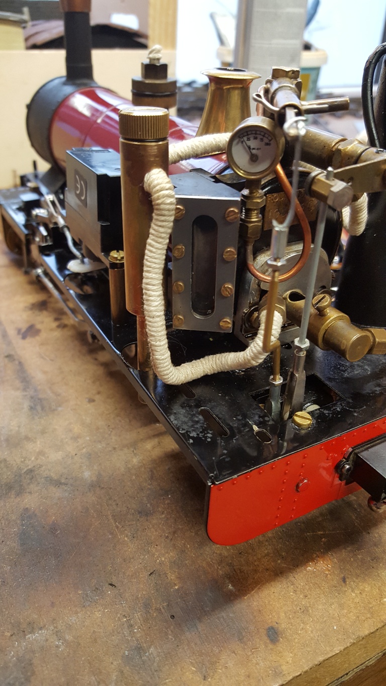

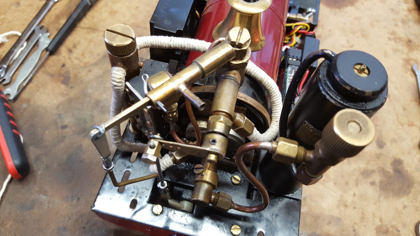

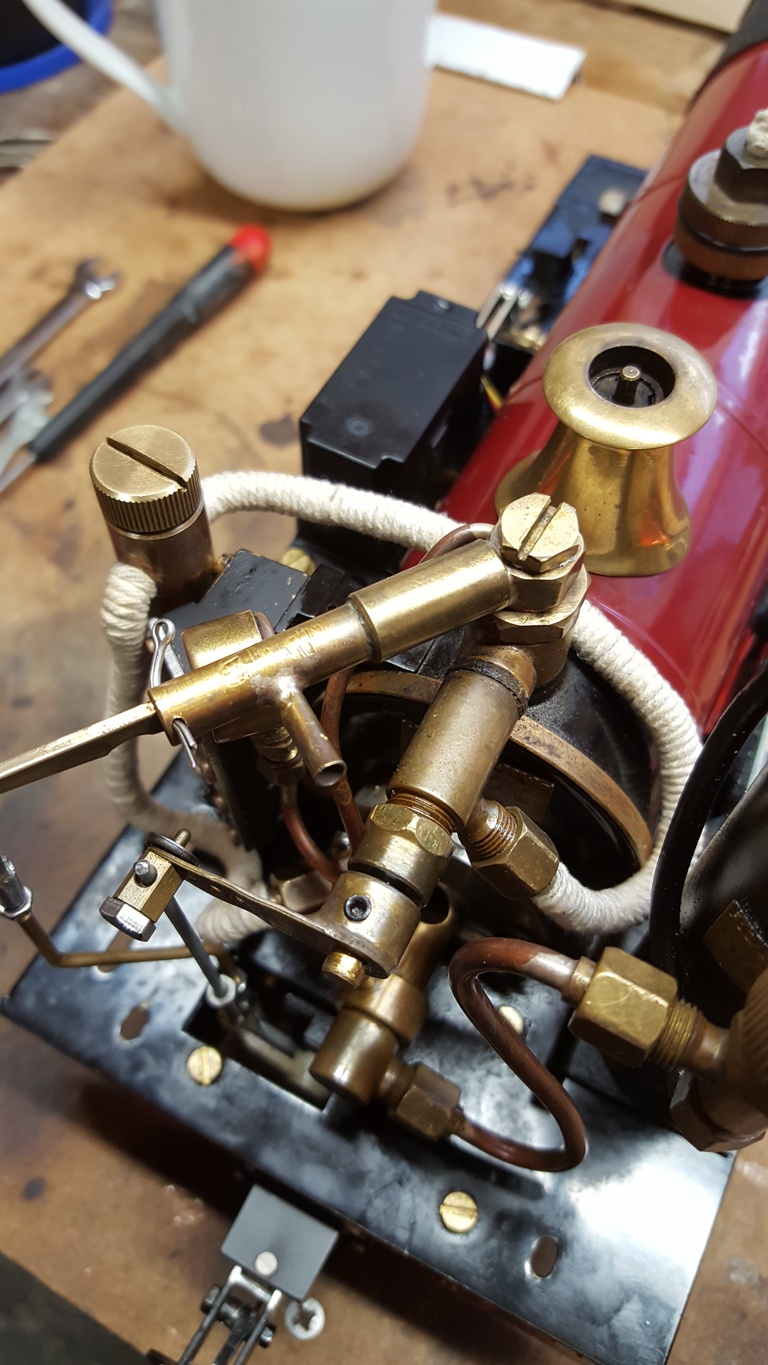

No trains today as it is raining so I thought I would lag the pipe work on My SL:
I might leave this lagging white as I have singed it to burn off any fine hairs.
Re: Changing of a Roundhouse Silver Lady - Steamy Clare
Post by tom_tom_go » Sat Mar 10, 2018 9:09 am
I am surprised how much the lagging has reduced condensate on this loco.
As it runs with a SSP Slomo and my line is not continuous I suspect I suffer more condensate problems than most so this is why it is noticeable to me.
I can now have the Summerlands Chuffer FX set to use the large hole (big steam plumes) without the loco being showered in oil.
If you plan to lag pipe work make sure the body will still fit around the pipes as I had to rework a fair bit of the piping to make the body fit back on easily with no resistance.

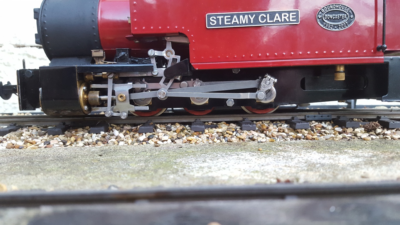

After painting the wheels on my Riverdale loco I decided to have a go on my SL:
Slightly weathered as with my other loco. It's nice to see the wheels rotating now in the evening sun.

tom_tom_go wrote: Thu Jun 14, 2018 10:44 pmAfter painting the wheels on my Riverdale loco I decided to have a go on my SL:
Good man!
Post by tom_tom_go » Fri Jun 15, 2018 9:21 pm
I thought you would approve Tony, shiny wheels urk me as well.
