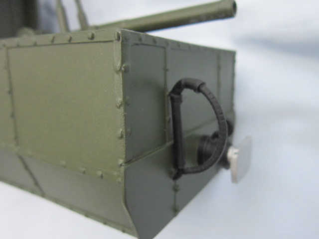

Since my last post I have been busy fitting brake gear to all of the four wheel wagons, all done now. Having done that another missing item stands out, and that is vacuum hose connection. Some of my stock has them fitted when I was fortunate enough to pick them up used or as a job-lot. (they aren't cheap and I need lots of them!). I have also made some in the past and am pleased with their appearance.... it's all about distance.

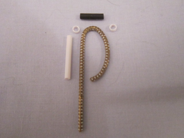

The way I made them is by using brazing rod, carefully bent to shape then made up with heat-shrink and plastic tube....... After fitting the plastic tube the brazing rod can be bent at right angles to be fitted either through, or under, the wagon ends.... The separate pieces are bonded together with super glue before painting.
This is my output for this afternoon..... Painting tomorrow and fitting as soon as they dry.
Nice work Peter!
That design is a much cheaper way of fitting out stock with vacuum hoses than buying white metal offerings...
- Posts: 8010
Great solution. I like the inspirational use of the brazing rod.

Impressive Peter. I like the way you have thought out and used the materials and like Tom says, it must be a lot cheaper to make your own and may I add, better looking........

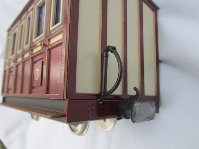

First few fitted today and I'm pleased with them..... lots more to follow.....

Very nice! Chunkier than mine, which I like. Looks like they'll be well able to withstand the odd knock too...

Brilliant solution. I fit vacuum pipes to all my locomotives and passenger stock. Until the 1970s even British Rail ran unfitted wagons. They only had a hand brake. A small point for anyone making them, the hoses should be fastened to the stand when not connected up. If they aren't then no vacuum can be created and the brakes would be "on".

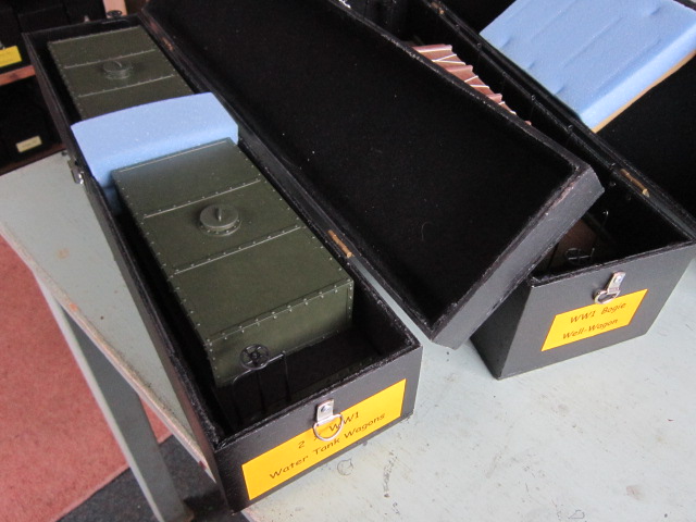

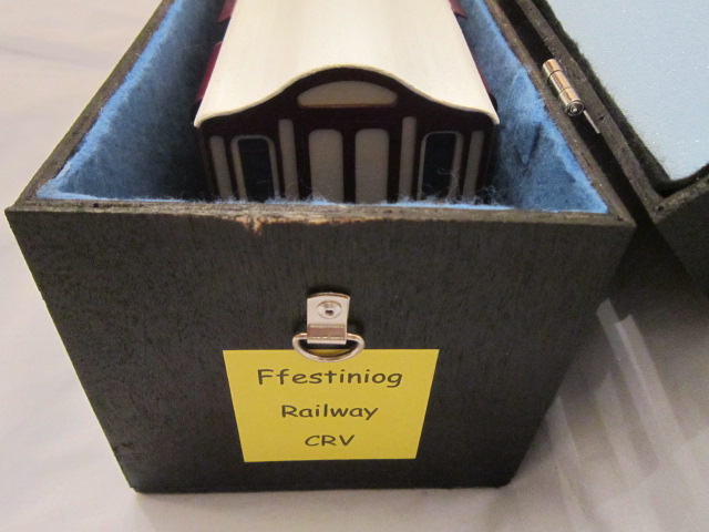

Building more stock means there is a need for more stock boxes. All of my stock items, locos and wagons, are in purpose built plywood boxes which are felt lined to protect their paintwork and stop dust settling in those impossible to reach places. If there is a danger of them rattling around I use foam sheet and, so far, haven't experienced any problems with it bonding to bodywork, which has raised comment elsewhere. It might be down to the use of acrylic paint, not oil based?
Currently I have three boxes in progress, cut from 4mm plywood, mitred corners stuck with Evo-stik PVA and taped together whilst drying. Sanded, painted with black emulsion and sprayed with matt lacquer they are now ready to be lined.....

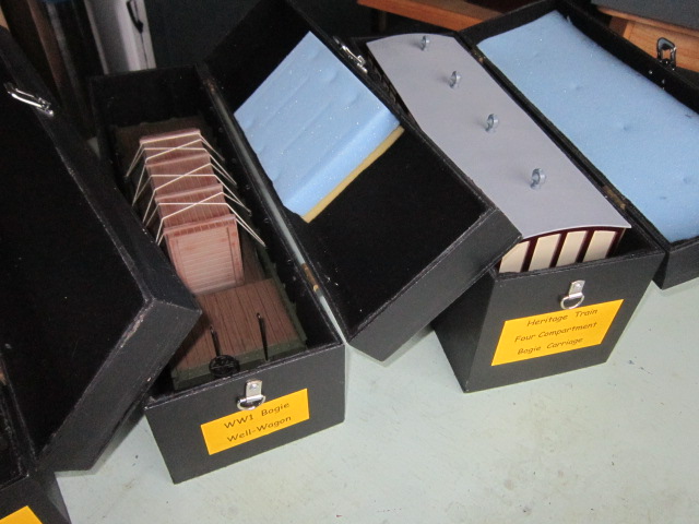

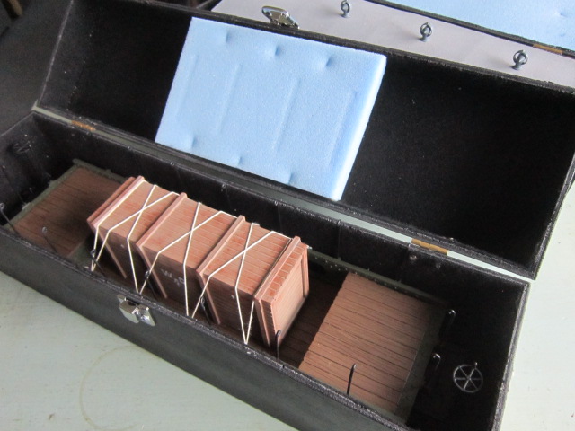

The latest boxes are now completed with small brass hinges, catches, black felt lining and foam padding to prevent movement in transit. I now have so many boxes which all look the same I have to stick labels on them to identify the contents.....
