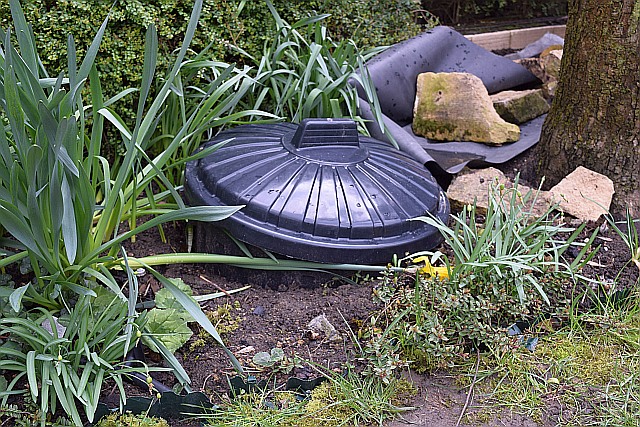

I haven't been entirely idle over winter, in fact I've achieved more than I thought I would be able to.
Firstly, to return yet again to my clay 'soil', sorry but this amuses me :lol: . When I dug the hole for my dustbin sump, I had it fitting quite nicely with the top at soil level.
As I said a few posts back, one day I noticed that it had lifted up and discovered that there was water sitting in the hole and the bin had floated up a couple of inches.
The weather dried up somewhat and eventually it went back down more or less to where it had started.
Then it rained again and this is the result:
That went down again eventually, although not quite to the bottom. Yesterday I put two large concrete ridge tiles in the bin, last night it rained again and this morning it is floating with a pronounced list to one side!
DSC_0001 (2).JPG (245.29 KiB) Viewed 5793 times
Before anyone suggests it, I don't want to put water in the bin yet so that I can adjust heights etc to match the end of the stream bed, when I get that far. I'm just hoping that in due course the bin full of water, plus the weight of the pump, plus the weight of the pebbles on the lid, will be enough to counter the upward water pressure collecting in the hole in subsequent winters!

Looks like things are progressing well. I never had an issue with my bin floating upwards, but maybe my water table is lower than yours. Also, I got my stream up and running fairly quickly, so it was filled with water almost from the word go.
For a while, I ran it without a cover - but was alarmed to find a dead hedgehog floating in it one morning. Spurred me on to get it covered that day. I then found a few drowned frogs in it when I cleaned it out at the end of the season. They must have somehow squeezed in through the hole for the pipe from the pump. I now make sure I keep the sump topped up and have provided frogs with an escape hatch in the lid. Since then (about twelve years ago), I have found no more drowned wildlife in the sump.

ge_rik wrote: Sun Mar 24, 2019 8:39 pm Looks like things are progressing well. I never had an issue with my bin floating upwards, but maybe my water table is lower than yours. Also, I got my stream up and running fairly quickly, so it was filled with water almost from the word go.
No I don't think its water table, we live near the top of a hill and there is a 20ft deep ex-LNWR railway cutting right in front of the house! The problem is soil permeability, this thick yellow clay simply doesn't allow water to percolate through at any great speed.
