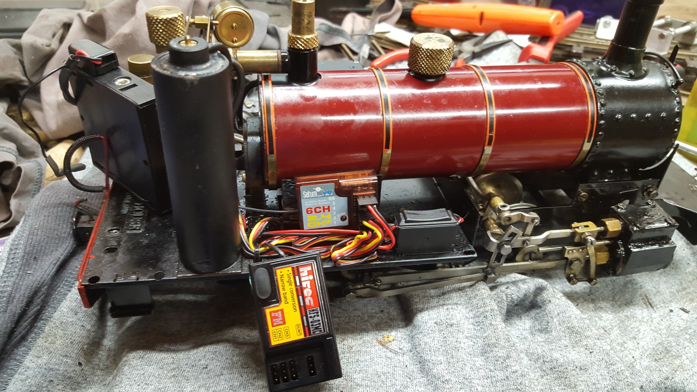

So, a little tinker about with the loco before dinner and started on the safety valve. Andrew got a new spring and seal from Roundhouse before he sent me the loco as the valve was not performing. The seal clearly needed replacing to me as the old one was flat on one side so new spring and seal is now fitted but despite adjustment it will not blow off. I tried one of my Roundhouse safety valves and that did not blow off either so I wonder if the pressure gauge is faulty? I will try one of my pressure gauges next to see what's going on.
I like the Russell bodywork, feels more solid than my Lady Anne/Silver Lady type. Replacing the RC looks easy now I have the body off but Andrew if you don't mind I am going to give her a good clean as I have found two dead spiders already!
The chuffer is also bent as well so will straighten that up as it's not meant to touch the sides of the chimney (I think it's to do with either the noise or impacts lightening the loco up).
Re: RWLR - Robin Wood Light Railway
Post by tom_tom_go » Mon Jul 30, 2018 7:06 pm
Posting as I go so just did it all on air and now safety valve is sorted, blows off on 40 PSI even on gas after calibrating with air.

I also got time to sneak in a quick play with the new RC and all works well (look at the size of the 40MHz Rx!)
Is 40MHz worth anything these days?

Post by tom_tom_go » Tue Jul 31, 2018 8:26 pm
This has all gone rather well so far Andrew (should I have said that?)
Out with the old:
And in with the new:
Range check went well, I could still control the loco from my front room while the loco itself was in the garden.
I gave her a short run but without a Slomo on my little line it's not worth a video. I have forgotten how sprightly these locos are without any inertia so you will definitely see a big change in realistic running Andrew when we get your one fitted to Russell.
