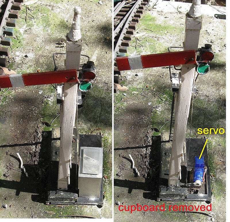

Some might wonder if servos are OK outside. I've only used 'normal' sized ones for turnouts, not the micro size. Mine are in small buildings, like this and even in a small 'signalling cupboard' as seen in the top pic, and the oldest has been outside since 2002.
I have also used servos to operate semaphore signals. These use the micro servos protected only by the ‘cupboard’.
