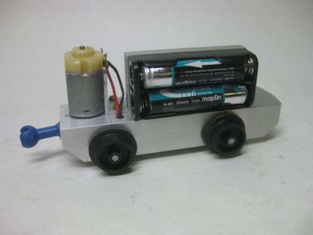

Hi,
I have just finished an electric chassis for a child's toy. Being only 100 mm long I think it is the shortest chassis that I have made that will hold up to 4 AAA cells so it could be radio controlled. I have another similar chassis to finish which I think I will rig for 4 cells and maybe fit radio when I can afford it.
Regards Tony.

Been meaning to ask, is that chassis just one extrusion?
The chassis is made from 25 mm x 19 mm x 3 mm aluminium channel, 1"x 3/4"x 1/8" in old money. The other part that the battery holder is fitted to is 25 mm x 6 mm aluminium which is held by screws to the channel.
I have just finished a slightly larger version with a bigger can motor and AA rather than AAA cells. It is fitted with 29 mm Binnie wheels and the gear ratio is 30:1. The body is fitted with modified Binnie couplings and Mamod buffers. Without the R/C the cost of conversion is about Β£12. Video at:

I do admire your chassis (ie chassises - plural?), Tony. They look simple but are blooming effective. I might be tempted to have a go at making one myself. My success with my own chassis-making to date has been lamentable. I think I will have to invest in a pillar drill / drill press though to keep things square.

Agree - your chassi (My 'own' Yorkshire plural) Tony are always really neatly produced, including the wiring on this one - soooooooo good!ge_rik wrote: Mon Apr 23, 2018 6:47 pm I do admire your chassis (ie chassises - plural?), Tony. They look simple but are blooming effective. I might be tempted to have a go at making one myself. My success with my own chassis-making to date has been lamentable. I think I will have to invest in a pillar drill / drill press though to keep things square.

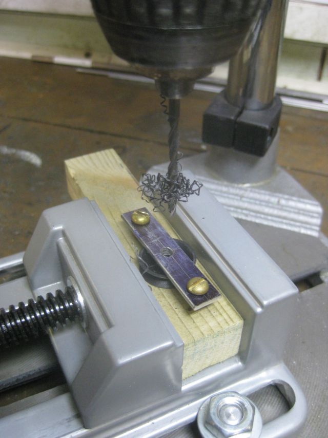

I am fortunate in having a fairly well equipped workshop. However it wasn't always so, so I thought I would have a go at making a chassis using just hand tools as I did in days gone bye. I did use a mains powered electric drill, but all the other tools used were hand tools. The bit you might be interested is the drilling of accurate holes and for this I bought a vertical drill holder with vice for Β£15.
My drill is old and has a speed controller on the trigger which is useful at is allows the speed to be set before the trigger is locked for drilling.
This is a jig I made for increasing the hole size of gears wheels. wheels and pulleys.
The finished chassis, all holes were drill with the drill which when held in a vice was used to dress the ends of the axles after they were cut to length, even the aluminium channel was folded by hand, well with the help of a hammer.
The finished chassis photographs were too large so I will resize them and post them later.
Regards Tony.
