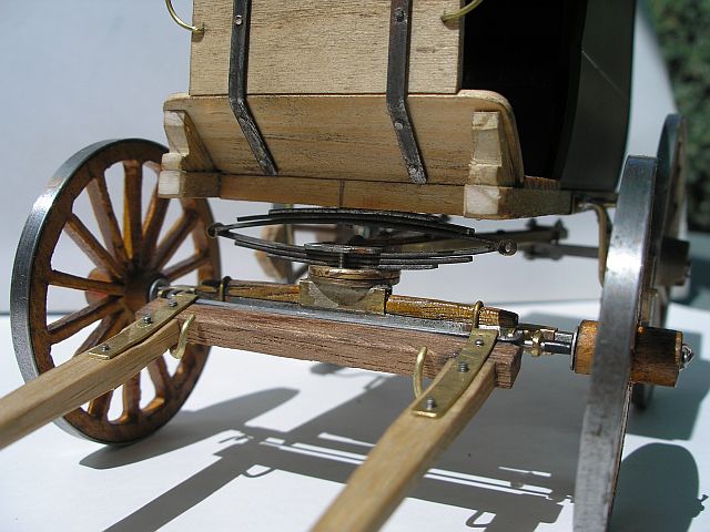

An advantage of my time frame is that there was still many horse drawn vehicles around, so as I had van bodies and two pairs of plastic spoked wheels some research revealed a bakers cart with a very similar style. It required a pair of smaller diameter wheels for the fore carriage so these were fretted out of ply, spokes rounded and steel tyres made and fitted to all four. A timber reach frame with fore and aft semi elliptic leaves (working shackles) at the rear, a fifth wheel at the front with transverse double elliptics, removeable shafts carved from bamboo gave me a platform to build a body chassis with footboard and brakes.

Front view of the fore carriage, fifth wheel and springs.
Bakers Cart Log 005.jpg (67.37 KiB) Viewed 5268 times

wow Grant. As previously mentioned I don't know what people will say as they have already used up all the superlatives. So we will have to make some up. This is stunninglyfabulous and tremenduful. Where do you start on something like the steel tyres?

For the tyres, just a matter of measuring wheel circumference, add a smidgen (Blacksmithing term) then cut steel strip and beat into a circle on redgum block (I don't have bending rolls) and silver solder the ends together. Beat it again over steel round, check size (hopefully only having to subtract not add) then press on. I run them on concrete vigorously to give a nice matt steel look.
