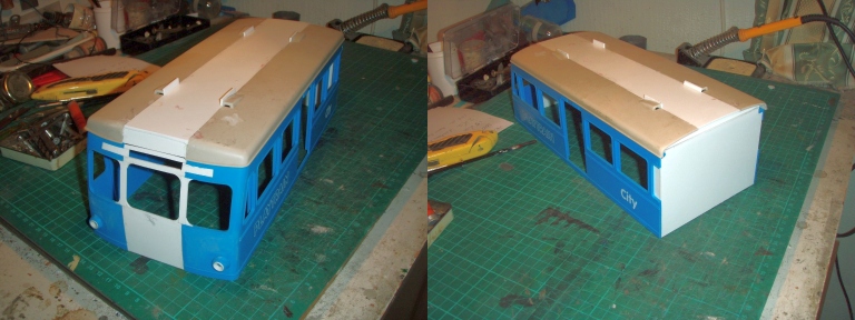

A little project to keep me going over the next few months.
There is an easy way and a hard way to convert these, guess who is going down the hard route?
The running gear will be removed, the trailing bogie will be retained but moved inwards slightly. Propulsion will come from a Triang Big Big 040 block. I think it is crying out for some new seating and a set of lights.

Not the best picture in the world, but it gives an idea of what will be done with the Railbus.
The power bogie is an ex Triang Big Big unit, I like the outside cranks. I have moved the bogie mount for the trailing bogie inwards so that IMHO it looks more balanced. The OCD part of my brain does not like the original set up. I am going to use the original trailing bogie until I can find another Triang unit (If anyone has one going spare, let me know. All I want is the wheels and cranks. The motor does not have to work. )
I want raise the body slightly to give it a more scale look, I am also looking at ways to make the doors open via remote control as well.

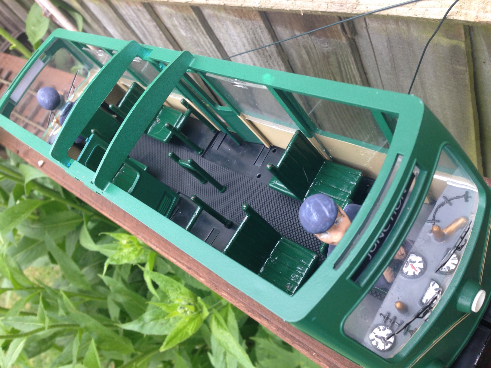

Jim, I take your point about the bogies, they are pretty horrendous and I thought about changing mine but haven't bothered so far. However, no need to fill it up with batteries, I still have one of the original Faller motors which I assume are nominally 12v ( I haven't checked) but it runs nicely on one 3.7v LiPo. Hobby King do nice flat profile ones and I've got the battery, Deltang Rx, on-off switch and charging socket all in a plasticard housing hidden between the underframe trusses.

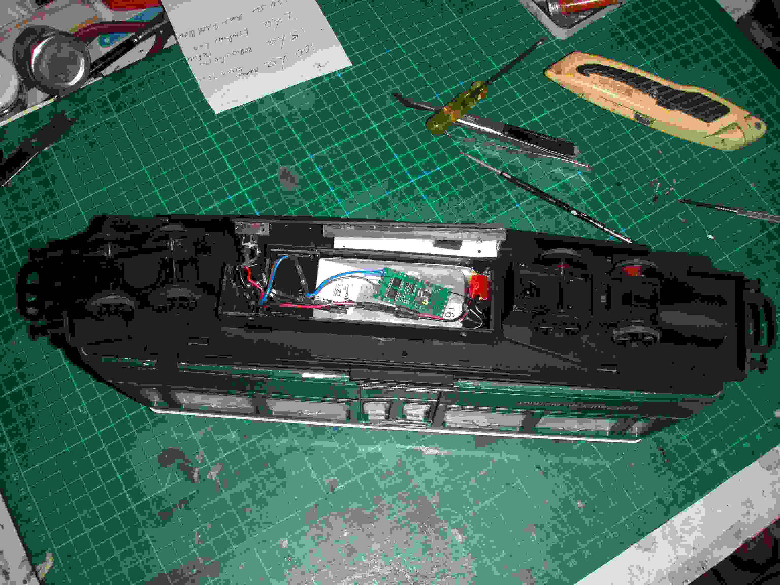

Mmm - thats the challenge Jim- i haven't sorted one yet - umming and arring about using the Swift Sixteen one (and the non powered one ) I was toying with doing something a bit cheaper (remember I originate from Yorkshire) but having seen the coach to railbus conversion in the latest SMT, which uses the Swiftsixteen stuff, the chassis does look a nice job with that unit and the bogie sides you can buy .......where did I put my Santa list??????
Phillip - when I first got it, (as per the photos) it did happily plod around but I do want it to do some regular stopping and the switch thing on the side is hard to operate to stop it - with my big hands I often knock it into reverse, or derail it - so I did try a cheapo -(ex remote car) Rc with it - just forward and back and no ESC - which worked ok but because I had to splice the RC into the feed, I was finding it was now stuttering at times when running on the track (fine when its on blocks) - so I was thinking I probably need more power to run the motor (mines just a 3V battery job) and the RC - so going forward I want more volts in there involving more rechargable batteries as well as getting a upto date RC receiver/ESC (i.e.) Deltang that I can run through my TX20.
I also found as it ran, it wallowed along, building upto wobbling at points - on two occasions when I was operating it RC, the wobbling built up to such a degree that it fell off the track and down into the flower bed - on both occasions no permanent damage but it made my think I could do with some more weight low down - which again will put stress on the existing motor.
Thirdly because my line does have some gradients and some are on fairly tight corners, the current motor was prone to stalling at those points so having more weight and potentially more powered axles may help - I have even considered having two powered bogies but not sure if that would be overkill
I know I will have to sacrifice some of the passenger space to allow the motor in there (Parcels area mi thinks) and probably have a raised floor in part of the space for batteries and RC - I'm thinking I'll build a new chassis to hold everything, including new seating and then let the body sit on top of that (which some simple catch or screw to hold it in place) - however, once i start , sure things will change!

Yes they are plastic wheels and yes I did cut the power bogie down. I also looked at reversing it to put the wheels at approx the same distance from the end as the non-powed bogie, but decided it was too much work!
I can't remember if there was a battery compartment, and my memory tells me I removed pickups but I can't be sure. My non-powered trailer car certainly still has a battery box, but that came from a different source so is no guide.
They do both wobble, especially over points, as Mark said, but havent had major derailing. That horrible reversing lever was the first thing I removed, but I installed a Deltang Rx65b from the beginning and it works well with the Faller motor on a 3.7v battery.
