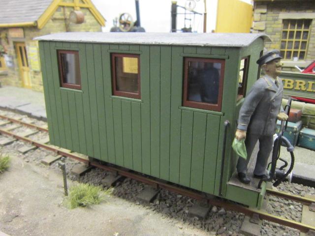

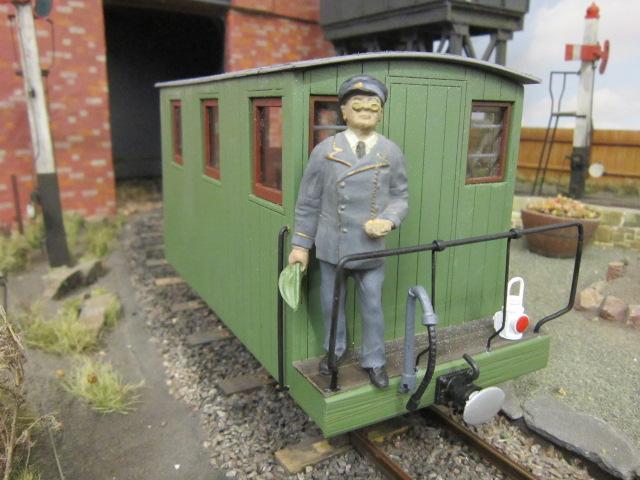

Today saw the finishing touches to the kit...
Because of its sorry state I have had to get back to the basic components following much preparation to remove detritus from its previous life. The sides, ends and floor were first set, as described above. The original ply strips which held the axleguards were then replaced with plasticard, (that made me feel better!) and a new balcony floor and rear buffer beam fitted. The window frames had been removed before painting the box and glazed individually. The rear two having bars fitted internally. After painting everything inside and out with acrylics, the windows were installed, handrails fitted and a new rear guard-rail made. The roof is the original (plasticard) but now covered with fabric to represent canvas. On the rear platform stands the Guard and a lamp is placed to show the end of the train.
Almost certainly, none of the above is authentic, but it looks so much better than when I bought it and I feel more satisfied with it than I thought I would be.
Size-wise, it is exactly the same height as my Fairlie so I guess the scale is not far wrong?

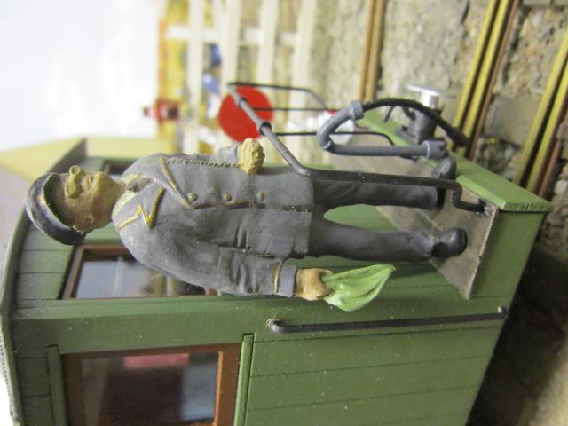

I forgot to mention the brake hoses which are home-made from brazing rod, which gives the impression of flexible hose, covered with heat-shrink for the pipe and plastic tube collars where they join.
Also, the Guard appears to have a huge handlebar moustache.... not so!
It is shadow from his glasses caused by lights over my railway.
