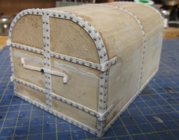

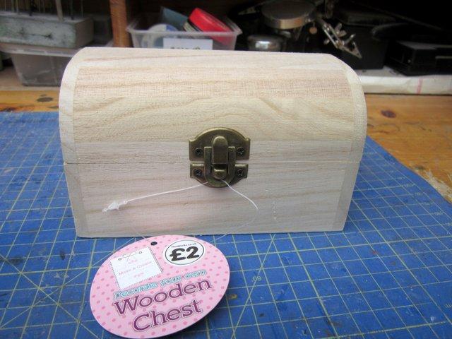

Take one trinket box from 'The Works'
Add one Hartland chassis ......
....... some plasticard strips and a few (hundred) Cambrian rivets.
Result = one Gunpowder Van for the Bickerton Mining Company
I can't take any credit for the originality of the idea - I'm sure someone (maybe on this forum) has beaten me to it. But the outcome is quite pleasing. Definitely needs transfers and some judicious weathering though - looks far too pristine for my railway..

I couldn't quite believe how close a match it was to the Hartland chassis - a bit of an impulse buy - but at £2.00, I could have always used it as a bits box....

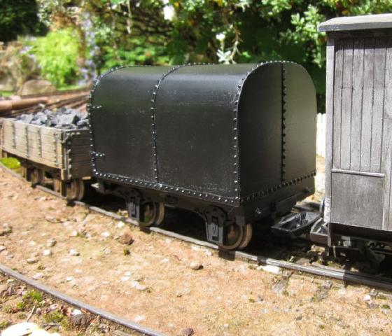

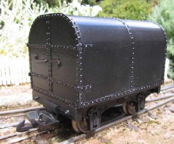

I also did one of these last year - I think it was someone on this forum who noticed the boxes in stock at the Works.
Mine is also 32mm - I knocked a chassis together from some 10mm stripwood
but didn't go quite so liberal with the rivets!
For the moment mine is finished in bauxite
- not having a use for gunpowder, I need to find an alternative use for it - delivery of the wages maybe?

Oh, very nice. I was thinking of a stripwood chassis, most of my scratch built wagons & coaches use something similar. Are those Binnie wheels & axle boxes?

Very nicely done, especially the quality of the finish. Did you use filling primer?

Alan P:111778 wrote:Oh, very nice. I was thinking of a stripwood chassis, most of my scratch built wagons & coaches use something similar. Are those Binnie wheels & axle boxes?
The wheels are Binnies, I think (they were in my left over box, so not a 100% sure) and the axle boxes are Brandbright - I shall have to source another supplier now.
BTW, I've just seen your distance measuring truck - you could make a fortune sending that out on lease! The quality of your woodwork puts mine to shame - nicely done!

ge_rik:111779 wrote:Very nicely done, especially the quality of the finish. Did you use filling primer?
Indeed Rik,
the colour gives it away! I 'hardened' the wood first with sanding sealer before spraying. I used filling primer when I did boat modelling, particularly on plank on frame hulls where a smoother finish was sometimes required.

Alan P:111767 wrote:Another cracking idea. We just happen to have one of those retail outlets where i live. :)  I will probably have to scratch build the chassis as my line is 32mm.
Picked up one of these boxes today. A small pile on offer at our local branch for only £1.00 each. Looking at my 7/8 scratch built quarry wagons sitting here on 32mm track, then using the same scratch built chassis and Mr Binnie axle boxes to match the rake will produce a very nice little model indeed. Not checked the scale but it certainly looks the part.
