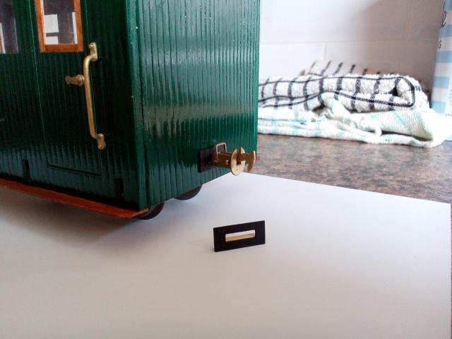

I had a small hole drilled already for a buffer coupling so I squared this hole with a square needle file to accept the square shaft and then angled the hole width ways to allow the coupling to swing horizontally.
Here is a photo with the coupling in place with a rectangular plywood plate added to neaten up the look of the hole. I think it looks like a backing plate for the coupling. I might make some tougher plates in brass at a later date.
Sorry to ramble on but hope this helps to show how I fitted the couplings. There may be other methods and I might make modifications in the future.
David.
David.
