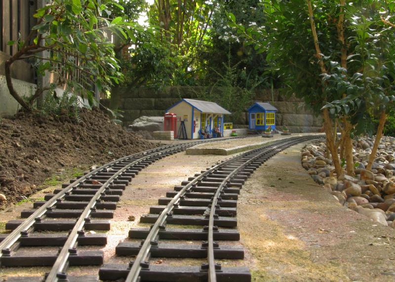

Post by andymctractor » Wed Apr 08, 2015 11:28 pm
Here is a link to a previous topic on concrete roads and platforms.
http://gardenrails.myfreeforum.org/abou ... highlight=
Here is a photo of Bramley Bank showing a platform built using jigstones edging. This is an effective but labour intensive method. I have one mould but needed just under 50 castings for this station.
Good luck.
