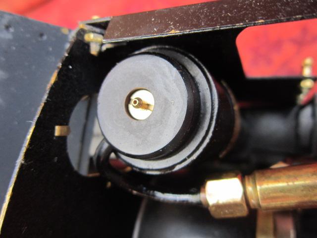

Thanks for replies guys, I attach photographs to show the gas cylinder type (which is probably standard to Roundhouse models anyway?).  I haven't yet worked out how the gas seal is made and whether the leak is coming from the top of the cylinder seal or the connection between that and the filler pipe.
 Is it possible the end of the filler pipe could be damaged?
The model is only just over a year old and little used.
I'm guessing there are no user repairs to this unit?

The gas filler valve on top of the tank can be changed with a little tool from Roundhouse but it is possible your filler nozzle is damaged. The seal is made with the two faces being the same angle and smooth, similar to an oscillator.

Peter Butler:102932 wrote: I haven't yet worked out how the gas seal is made and whether the leak is coming from the top of the cylinder seal or the connection between that and the filler pipe.
Is it leaking only while being filled, or does it leak all the time? If it leaks all the time, then the valve is faulty.
The filler valve looks OK. You are aware that the Ronson type filler valve vents gas as the tank fills with liquid? When the tank is full liquid comes out of the vent.
If the extension tube on the gas can doesn't fit the filler valve properly, it will leak liquid while filling.
You are right, the Ronson filler valves aren't repairable, by either the user, or the supplier. If faulty, it has to be replaced.
If it is leaking all the time, the gas leak can be located by putting a drop of soapy water on the joints, one at a time. If the gas leak is small, you will see bubbles appearing from the leak. This doesn't work on large leaks though, as the gas blows the water out of the way, instead of forming bubbles.

As for the leak whilst filling, again I will follow all advice and see if the seating is faulty between nozzle and receiver. I undrstand there must be a smooth and undamaged surface between the two to prevent leakage, so possibly there is a fault or damaged area which my ancient eyes can't pick up?
