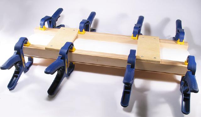

I form my coach roofs by laminating three layers of 0.5mm (20 thou) sheet 420 x 120mm, then clamp them to a wood profile block until they set. For that I use d-Limonene, sold by Microscale as Micro Weld.
