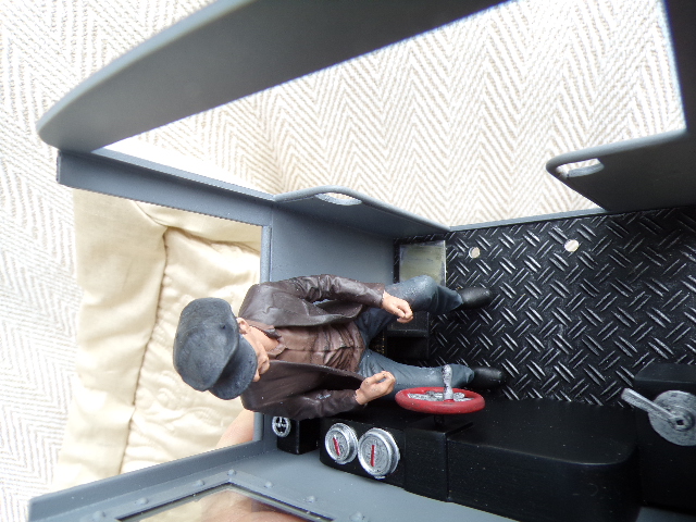

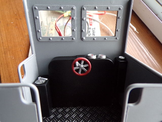

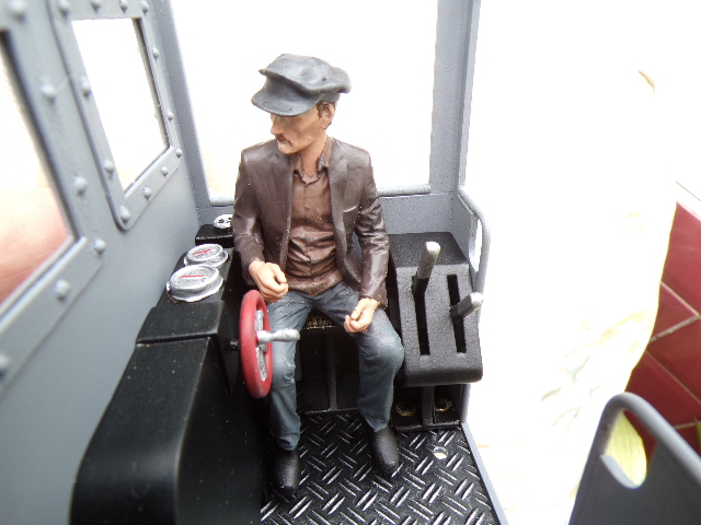

My driver figure arrived yesterday from David Clavey Models and he fits perfectly. I like David's figures very much; the ones I have used appear to be cast resin and feel solid, so show no printing lines at all. The detail is good and the poses look natural. I prefer to buy them in grey primer and paint with acrylics. This one has a poseable head so he can face either direction....

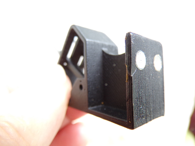

The cab has to be fixed to the chassis by two bolts at the rear, however, one is obscured by the gear selector frame which I have now managed to make removable by adding two magnets set into the frame base and gluing a thin metal plate to the cab floor....
This works well and holds the frame securely.

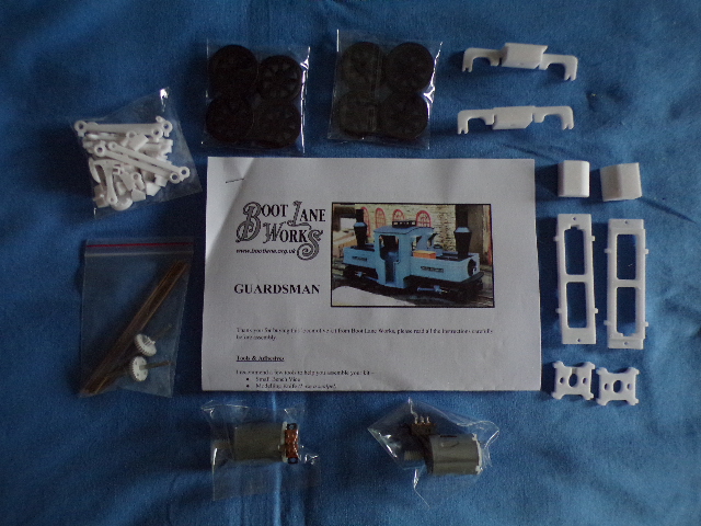

Not much progress with the Baldwin whilst awaiting replacement worm and gear, which I managed to melt!
So... in the meantime how about another kit? Perhaps something completely different? I know, how about a Baldwin? Well, a Baldwin build of a Pechot-Bourdon design.
This is a superb 3D printed kit from Boot Lane Works at a very realistic price.
A daunting experience when first opening the box and seeing the amount of parts but just a few pages of instructions. However, everything is carefully packaged to separate the different units of construction, and everything fits perfectly with the usual amount of preparation for a perfect paint finish.
Once the pieces have been handled and dry-fitted, everything becomes self explanatory.
Interestingly, the bogies are fitted together using screws/bolts into pre-drilled holes, so can easily be stripped down should the need arise. I am expecting a book... Trains to the Trenches.... tomorrow, so I can see more detail of these locos in service.

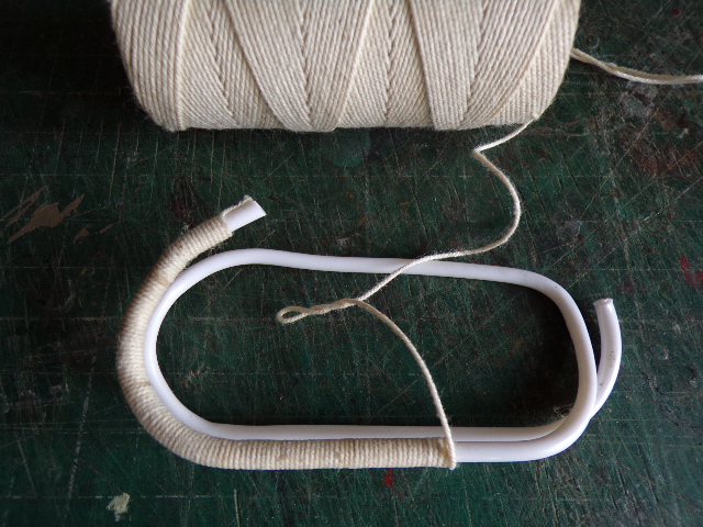

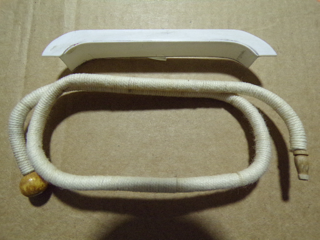

I have found a number of pictures of this type on-line and they show great variety of detailing, so I can add lots to my model. This evening I decided to make a water lifter hose and support bracket as shown here....
Swift Sixteen make a 3D printed one, which I have fitted to my 4-6-0 Baldwin, but it is far too big for this tiny loco, so I used plastic tube, heated with a hot-air gun to form the shape, and wrapped around with fine thread....
The finished item is well worth the hours I spent on it....

Rod, the end of the hose is made from a tiny wooden toggle from a craft shop. It just represents some sort of connector which I don't have any details of.... it will have to do!FWLR wrote: Tue Jul 25, 2023 10:20 am
Peter, did you put a slightly larger piece of tubing on the end for the fixing screw.
Just for interest, the plastic tube has another tube inserted before I softened it with a heat gun. This allows it to bend without kinking.... Useful tip?
Thanks Peter, that is a great tip. I suppose thatβs so it doesnβt collapse when you bend it to shape.

So-called 'spring' curtain wire (from the days of net curtains! Makes a good 'bending-spring' to support plastic tubes. - If the bore of your tube is big enough, obviously.
A non-modelling use, is about 15-18 inches of this, in a battery drill. - Great for clearing plug-holes of detritus.
(I only add this, as a time-saver, to allow more time for modelling).

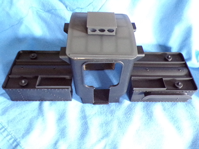

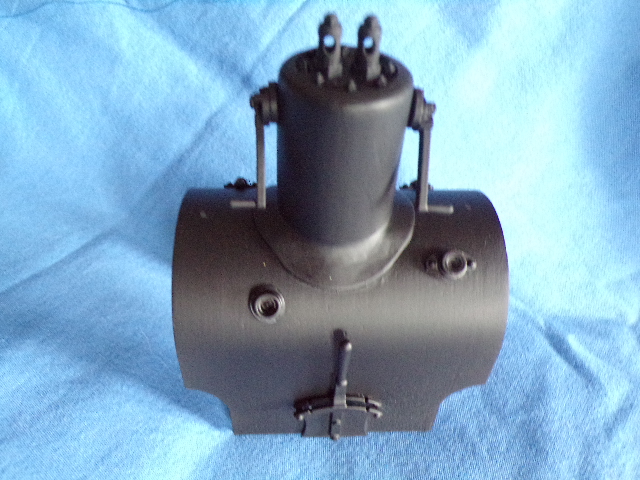

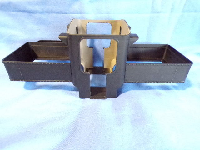

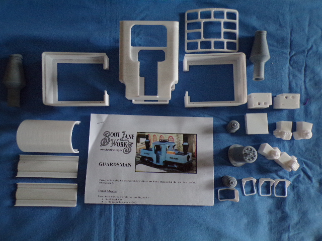

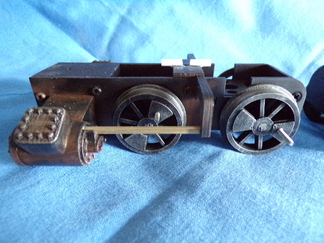

This is a great kit and I am enjoying every minute! The print quality is good but some preparation is still required. I use coarse wet and dry, followed by finer grades and a couple of filler primer sprays before top coat. This results in an even and smooth paint finish.
The cab is one unit with no seams, window and door surrounds printed separately. Each tank section is a three sided print with tank top added later....
The central firebox is just an arch with dome separately printed....
Cab fittings, other than firebox doors and regulators, are not supplied but I intend to add detail later.
The two power bogies make up well and feel sturdy....

Those power bogies do look impressive Peter.
- Posts: 7965
I agree. Those wheels look particularly solid
- Posts: 5713
Thanks guys, the wheels are 'Binnie' eight-spoke standard ones with inserts supplied in the kit to press-fit using a vice to keep them even and fully located. They are such a perfect fit I doubt adhesive is required, but you know me.....

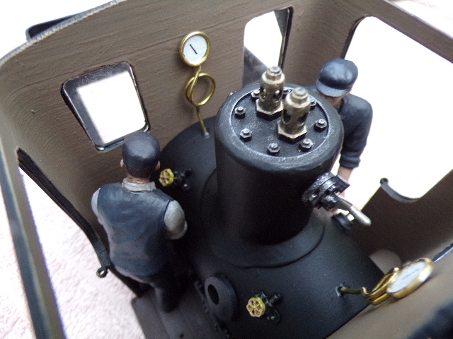

The tanks and cab are screwed together (no adhesive here!) with eight nuts and bolts supplied. Rivet heads are provided but with no instructions except to indicate the presence of coal bunkers inside the tanks on the fireman's side. I also built up on top of the tanks for additional coal storage....
The cab interior has been hand painted before the firebox is dropped in place. Driver and fireman figures are from Bachmann and fit perfectly....
Cab fittings have been added just for interest... I have no idea how steam locomotives work so the driver will have to be inventive.

The inside of the cab is really nice Peter. The driver will work it out I'am sure..
This kit seems to be for the more experienced builder I feel, but with a little bit of planing it shouldn't be that difficult do you think.
