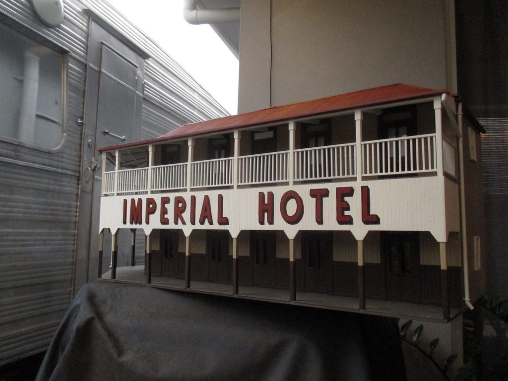

With the fascia lettered (it passes the 3ft test, at least) and paintwork touched up, the pub is very close to completion. I need only apply Tamiya's flat clear enamel to the letters, and fit the roof with mastic sealant, after pre-emptively poisoning the interior for when (not if) the ants find a way inside.
Then it's just waiting on the weather to clear up, so I can install the building in position..

Superb, Aaron, simply superb from start to finish.

Excellent throughout, you should feel proud.

Aaron very impressive, as said by other, something to be proud of.
Looks like a Qld country pub to me...... Well done.
Do the lights automatically turn off at 6pm, or is your track set in a period after Qld abandoned the 6 o'clock swill? ;)
Be wary of Tamiya matt clear, if you haven't used it before and already know the trick.
They don't actually make a matt clear in either the acrylic range or the enamel range. What they call flat base X-21 is actually a matting agent, intended to be added to the clear X-22 (which is gloss finish) to cut it back to a satin or matt finish, depending on how much flat base is added.
Since most of the label is in japanese script and the only english instructions are safety notices, the label doesn't inform english speakers of the intended use of the bottle contents. Been there, done that, the first model I used it on turned a frosty white and had to be repainted........
ps. Where did you find a supplier of signwriters enamel? I thought it had disappeared, as I haven't seen a signwriter using a brush for years, it's all vinyl around here now as far as I can tell.....

Thanks, real pleased with the result. Looking forward to making it a centerpiece on the next tramway..
The pub's lights won't be properly connected up here, but they and other buildings will be next time; likely on a timer so they're visible every night. I do have a 12V SLA battery going spare though, so that would do for temporary use when other modellers visit.. Never heard of the 6pm swill, but then I live under a rock. It'd make an interesting subtle detail to include. I'm modelling 1920s-70s, when did QLD abandon that?
Oh yes, the flat base trap. Been there, too. Thanks or the reminder. I've already a couple jars of gloss clear with flat base added, that's what I meant to say, but forgot it doesn't come pre-mixed. Can't imagine why they don't just sell flat clear ready mixed like the other hundred enamel colours they do.. :roll:
Speaking of paint that Australian shops are seemingly incapable of stocking anymore, I get all my signwriting stuff from 1-Shot Australia's website. Ordered from them a few times, and they seem pretty good. They sell a flattening agent that mixes into the paint, but it's dearer than I can justify for the little use I'd make of it.

Excellent build, it's worthy of a place in any garden railway line.

You should be rightfully proud of that hotel Aaron. The signwriting really brings it to life. Simply superb.
