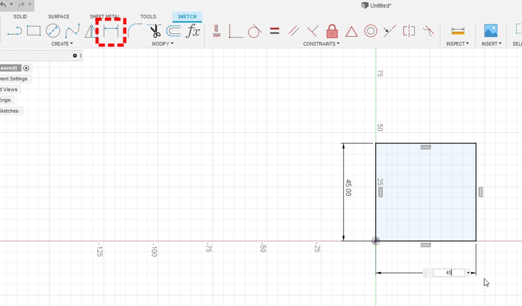

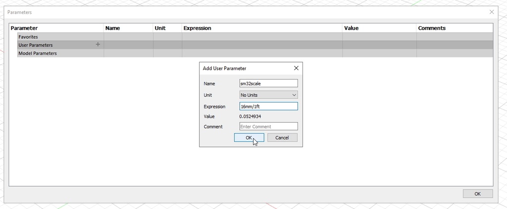

When making scale models, I like to set up a user parameter with the scale factor. This is the first thing you see me do: "Name" is what you use to recall the parameter. I want to work at 16mm/1ft, so that is what I put in the expression field. Fusion understands quite a few units, and you can mix and match metric and imperial. Since a scale factor is a length divided by a length, it is unitless.
NOTE: If you don't have the parameters "Fx" button visible, you can find it in the modify drop down menu: Next, I draw a square. I think the video is relatively self explanatory. The first step is to create a new sketch, and click on the yellow xy plane I want to draw on. I then use the rectangle tool to sketch the box, and use the dimension tool to firmly define the size as 45x45 real-world mm. Now I use the offset tool twice to create the inset lines. You see me type 3"*sm32scale. You can do mathematics within a lot of the numeric inputs, so this takes 3 inches and multiplies it by the 16mm/ft scale factor defined earlier, resulting in a scale size of the offset of 4mm.

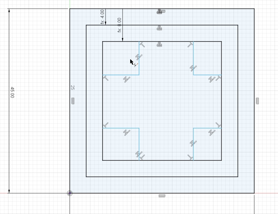

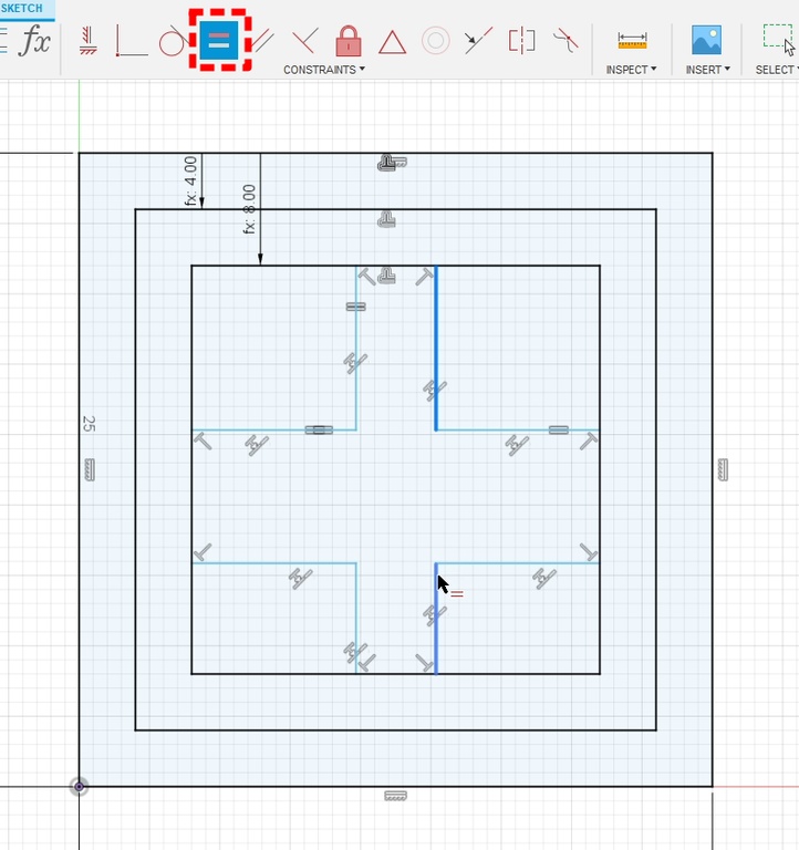

Now I start drawing the lines that create the separate panes. I first draw the required lines, not bothering to get them lined up or centred, only letting Fusion snap them perpendicular to the other lines already there. I then use the collinear constraint to force them inline where they should be.
Now using the equal constraint to make them all the same length. You can see in the video how this makes it so dragging the lines affects the thickness of bit between the panes. I finally constrain this last degree of freedom by dimensioning this size. All the lines turn black showing everything in the sketch is constrained.

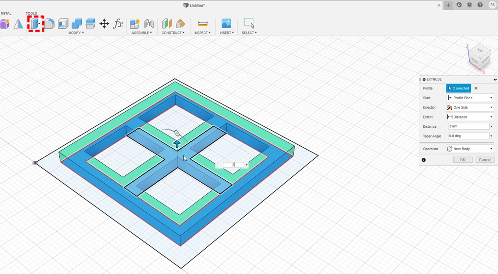

Now we turn the sketch into a 3D body. This works similarly to Sketchup. You use the push/pull tool to create a 3D object, extruding the bits of the sketch you want to a certain height. I then do it again for the outer frame, but extruding by a larger distance this time.
You may find after the first extrusion Fusion will hide the sketch, to bring it back use the eye icon in the project browser: At the end of the video, you see me use one of the most powerful features of Fusion. You can go back and change parameters, like a dimension as in the video, and the 3d model updates with the change. This means for example, we could make a different size window by just changing the first 45mm dimensions we put down at the start, and the model would update accordingly.

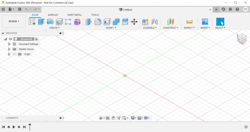

However I'm afraid I've fallen at the first hurdle! It's probably a version difference, but my F360 (v2.0.8809) doesn't have the Fx button and I've spent best part of half an hour searching for it, or a lookalike. Any suggestions, please?

Ignore my last post, I've found the parameters input, it's a drop down item under 'Modify' now, not a separate fx button.

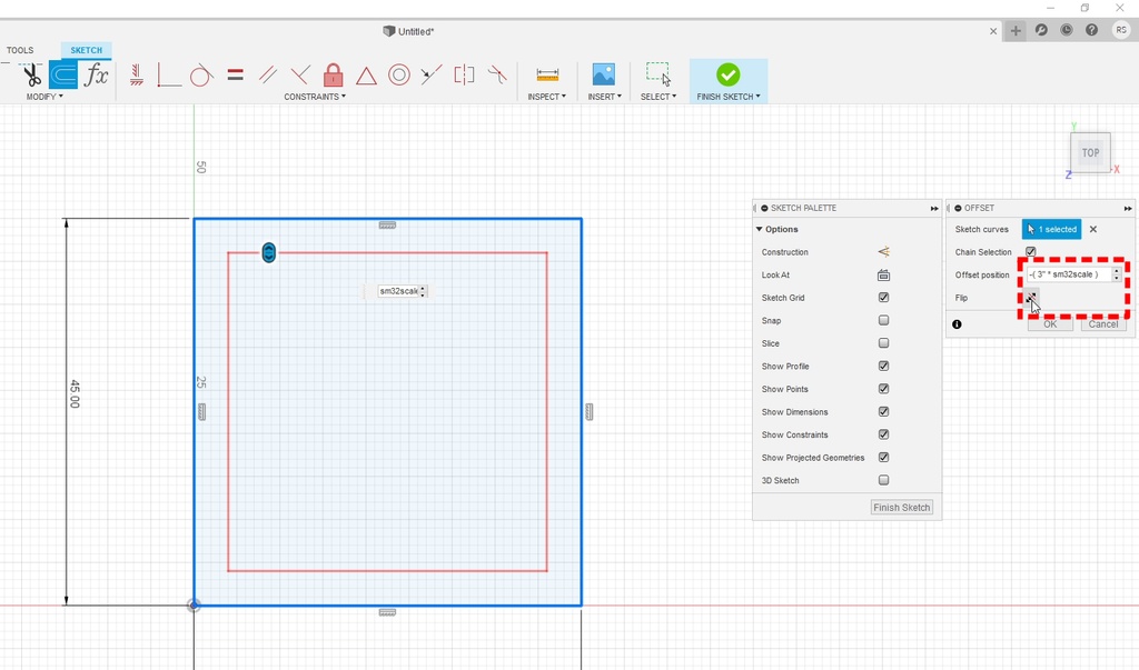

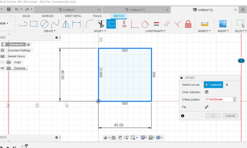

I can't get the Offset to accept the full expression in your example. ( 3"*sm32scale ). When I do it, the 3 by itself is fine and draws a square 3mm outside the original. 3" also works and draws a square 3 inches ( 76.2mm) outside the original.
However, as soon as I add the * the expression all goes red and nothing else works. I must be doing something wrong I guess, but can't for the life of me see what?

It sounds like there is something wrong with the parameter setup? Did you make sure to set it to No Units? By default the parameters are set to length, so when you try doing inches * mm it gives an area, which doesn't make sense for specifying an offset length. Can you show your parameter dialog?philipy wrote: ↑Sat Aug 22, 2020 7:35 am Sorry, me again.

I think that was it. Not sure what happened because the first time I did it, I didn't change to 'no unit's and it didn't work, so I went back and checked and changed it to no units, but it still didn't work. I've just redone it from scratch and it does now seem to be working Ok, thanks.metalmuncher wrote: ↑Sat Aug 22, 2020 9:00 am

At 1:52 in your video, the Select arrow magically becomes an Orbit tool. I did eventually spot that the LH tool at the bottom of the screen had gone a bluish colour but it took me quite a while to notice. I presume you used some sort of shortcut, off screen?
Now, I've finally got to the extrude section. I can select the inner frame and cross frame and pull them up the correct distance, exactly the same as your video. I get a two colour hollow effect, as in the video, but then in the video it suddenly all goes green, before you do the second extrusion. I can't find how you make that colour change action. Everything I do makes the extrusion go solid and deletes the the outer frame lines before I can extrude them.

Shift + middle mouse button allows you to orbit at any time. Just MMB is pan as well. Very useful shortcuts, as it means you can move the view without it interfering with the use of other tools.
I think I just hit enter after typing 3 for the first extrusion, it's the same as hitting OK on the extrude dialog to the right.
It sounds like it is hiding the sketch after the first extrude, you can hide/unhide the sketch using the eye icon in the project browser:
