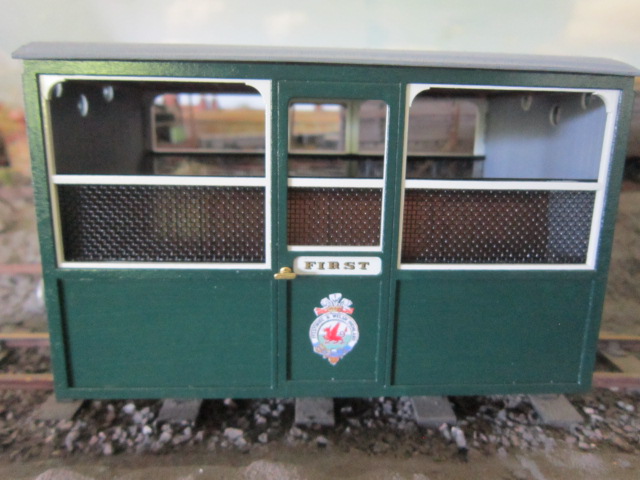

The I.P.Engineering coach is now complete and has worked out better than expected. As described earlier, it did require additional support and strengthening in areas which were still affected by the twisting of the material, which would not normally be the case. The new kit (kindly sent FOC by Ivan) shows none of the original issues and has some parts cut from different material, another build will be reported in due course.
To complete the coach I have added roof vent, crest transfers, lettering, and brass door handle to match the others.......

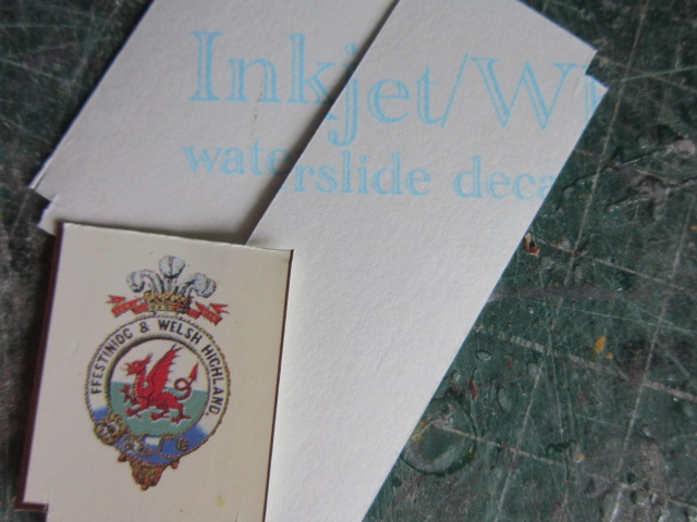

andymctractor
Peter, where did you get your crests done and do you have to trim round the image to get it to look so neat?Peter Butler wrote: Sat May 02, 2020 12:49 pm Slight sequence break here.....
Apologies again if this has been covered before and I've missed it.
- Posts: 5726
Hi Andy, I can answer part of your question.... Yes, I do have to trim the edges with a very sharp blade.andymctractor wrote: Sun May 03, 2020 9:12 am
But, the name of the supplier is a mystery, I did have an address and I bought them for another project but I will have to do some research to trace more detail for you.
Perhaps someone else can identify them from the pictures below....

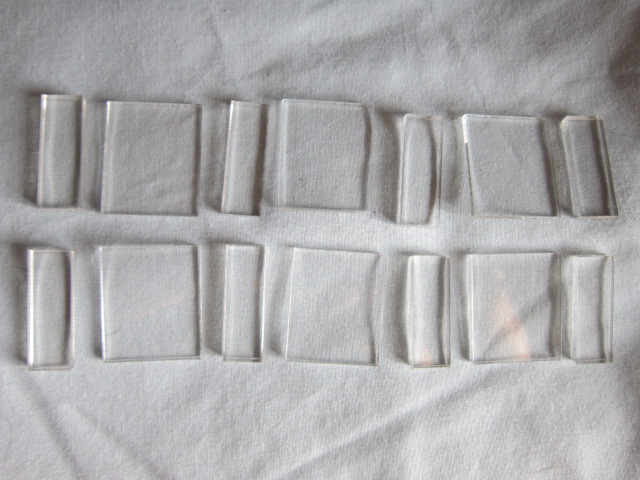

Returning to the 'Lineside Hut' Bug Box,....this is the time to select the carriage type you wish to build, as previously stated, there are either glazed windows or window blanks which can be installed....
The glazing supplied is amazing, it is precisely cut/moulded into well fitting panels of 2mm and 3mm thickness. The 3mm are the smaller ones which represent fixed glazing, the 2mm ones allow for drop-light frames (supplied) to be fitted, surrounding the glazing and beneath the outer overlay.
Final detailing includes buffers and roof lamp-top in whitemetal (looks large to me so replaced with vent).
Completed as per the instructions the finished vehicle looks very nice.... But...... as shown earlier, the axle-boxes are fixed height with no option included to alter the ride height, which is very low indeed... only 5-6mm above rails. I doubt this would be acceptable in many garden railways as track-side obstructions are usually there to catch the unwary. To increase the ride height I fitted 3mm strips between the axle boxes and the underfloor to lower the wheel-sets.
This has brought the coach into line with the others.
Overall I have thoroughly enjoyed building this kit which has proved to be detailed, very well planned in design and construction, made of superior ply material and gives a choice of two types of coach in one kit.
Value for money.... very good indeed and highly recommended.

The final part of the Jerry Irwin build....
Putting the sides together couldn't be easier or more accurate as there are templates included to ensure everything lines up precisely. I prefer to paint the sides, ends and overlays before assembly, this makes for a tidier finish.... The whole thing is 'dry assembled' at this stage with no glue applied, the top is reinforced with another jig (part of which is removed later) to keep everything square.... Elastic bands are now used to hold the structure together while superglue is used to lock the parts together.
Following removal of the end jigs, the curved end panels (which are also pre-painted) are glued in place with elastic bands to hold them...
I chose to fit side screens using 2.5mm plastic tube (sliced open) with wire mesh slid in the grooves...
The roof is assembled with yet more jigs which are simple to use and form an independent and removable roof when finished.... And finally, the finished coach.... So, how do I rate this kit?
Just wonderful! I have no issue with the choice of MDF as I never use my stock in wet weather, although I left a piece of the material floating in water for two hours with no appreciable effect. It takes paint far better than ply and gives a far superior finish.
All of the parts are so well cut there is no movement between joints. The cut parts are completely removed from surrounding material. The jigs are included in the kit and make it so much more accurate and easier to assemble. Interior detail is complete right down to planking on the seats and even floorboards with fixing bolt heads visible.
Running characteristics are so much freer and smoother than any other kit, or scratch-build, I have ever made.
Jerry Irwin is certainly the 'Kit-Master' in my opinion, his kits are far superior to any others and extremely good value for money.
