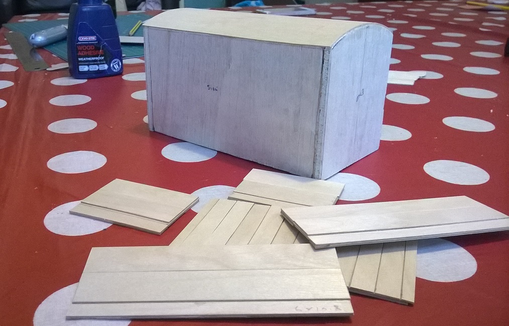

I've made a start on the next (WH)WHR rolling stock project, goods an number 2:
I'm currently without a closed van while WKLR van 11 awaits repairs to damage sustained through being stored in the tunnel, and anyway it's time I got back to building genuine NWNGR/WHR vehicles...

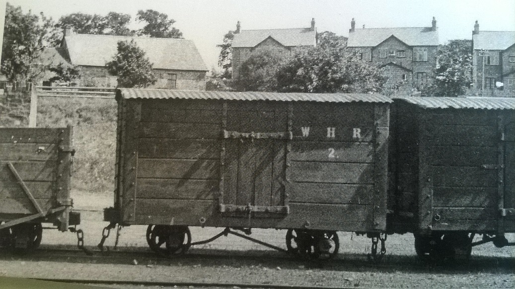

I've got no fewer than three drawings of this van, all different, but analysis of photos has resulted in a version I'm happy enough with. It's really quite a small vehicle, but that's because it's just a coal wagon with a few added planks and a corrugated iron roof...
Here are the basic bit, hacked rather badly out of 6mm ply:
These bits will just form a basic shell, with individual planks and other details added over the top.

This van and its sister, No.4, were pretty much cobbled together from bits and bobs. The doors on this one used the ironwork from the original doors of the coal wagon it started life as, and those on No 4 were curved - probably because they were pinched from a Ffestiniog flour van. I'll make a model of No 4 at some point too, but I thought No 2 would be a quicker job, with a better chance that the completed van might see service this summer.
Re: (WH)WHR Rolling Stock
No. 2 was believed to have started off as a "ridged-roof" wagon. These were used in passenger trains as a possible luggage van before the large Pickering's made an appearance. Both van 2 and 4 had doors on both sides, so don't forget the other door!
I quite fancy having a go atone of the ridge-roofed vans at some point too! And yep, was going to go for doors on both sides - I'm guessing you read the same WHR Heritage Group Journal that I did that debunks the "doors on one side" myth? Judging by the article in this one - https://www.welshhighlandheritage.co.uk ... -No-64.pdf - No 2 was built from a coal wagon though? The similarities in the shot of the van standing next to a coal wagon are striking... I really must get around to joining the Heritage Group...
Just read another article, suggesting that although Van 2 was converted from a coal wagon in NWNGR days, the doors came from the ridge-roofed van it was intended to replace...

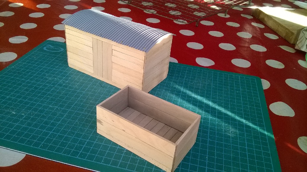

With the weather having taken a turn for the worse again I've done a little more work on the WHR wagon project
The basic shell of the van has been assembled and now awaits planking. I would have added running gear but realised that I've got through my stock of Binnie wheels - again! I'll place an order soon...
In the foreground are the bits for an open wagon, like one of these:
These little wagons were used for both slate and general merchandise - I'll probably build three of them eventually. For years I've been put off trying to recreate them because of the unusual axleguards, quite unlike anything available commercially. I think I've come up with a cunning plan there - more to follow, if it works...

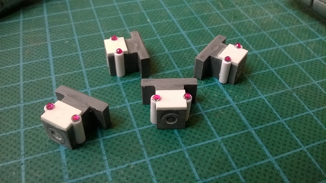

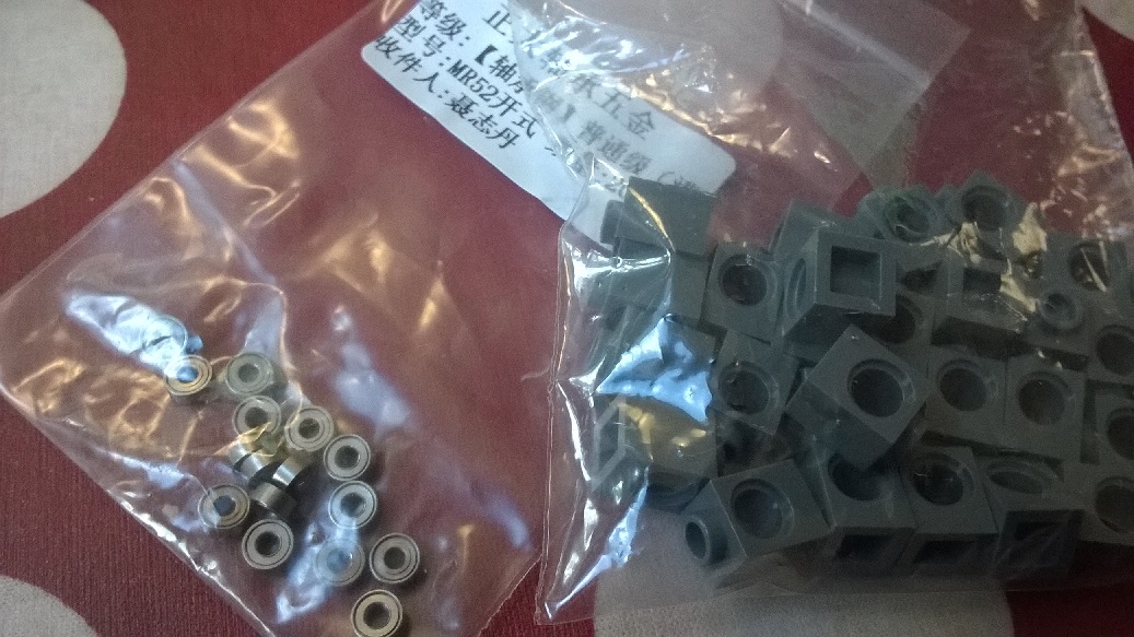

I've had some success here with my cunning plan to recreate the distinctive axleboxes the NWNGR used on some of their smaller wagons... While chatting with my son, it occurred to me that Lego pieces would do a decent job of making the basic shape I needed - I wasn't sure that how I could make that work with 16mm wheelsets, until I came across a website dedicated to Lego train-makers. They've discovered that a 5mm roller bearing (intended for model cars, I think) is a push-fit (well, hammer tap) into a standard-sized Lego hole - and I found that I could buy those bearings with a 2mm hole, which would work with Cambrian wheels and axles.
Here are the bits:
And here's the test wagon we hastily knocked up on my son's bedroom floor:
Success! So far so good, and - as you'd expect, I suppose - it looks like it will be incredibly free-running...
Next up is turning the various bits of Lego I purchased into something a bit more realistic looking...

Brilliant idea Andrew.... I have been searching for a supplier of suitable bearings but not found one so far, please let us know where you got yours from.
Yes please do Andrew. You have come up with something that most of us have in our cupboards. I know we have for when the Grandkids come round......Peter Butler wrote: ↑Fri May 10, 2019 10:19 pm Brilliant idea Andrew.... I have been searching for a supplier of suitable bearings but not found one so far, please let us know where you got yours from.
Glad you think it's got potential...
The bearings I used were these: https://www.ebay.co.uk/itm/10pcs-2x5x2M ... xy~hdR23kX
The Lego pieces came from a supplier called Gray's Bricks, via a kind of eBay for Lego called Brick Owl...
I put the axleboxes together this morning, adding some plasticard, biro inner and - of course - nail art gems to come up with these:
They're outside at the moment waiting for a coat of primer to dry...
