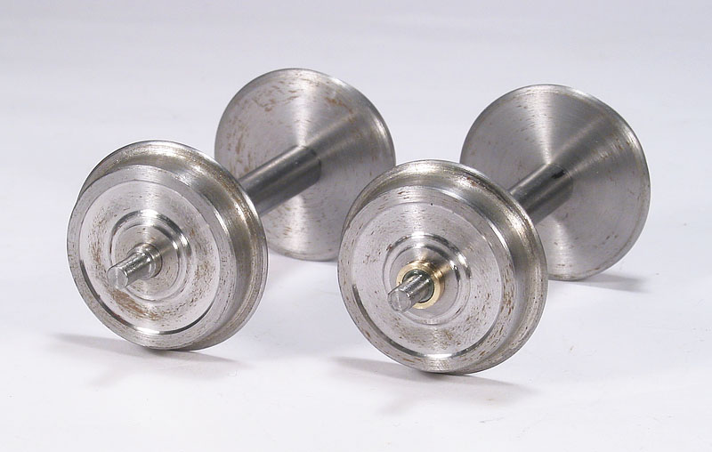

This is the result of an investigation I've been working on recently to reduce the rolling resistance of trains, especially long goods trains.
Because wheelsets usually have both wheels firmly fixed to the axle, the rolling resistance and hence the load on the loco, is higher on curves than on straight track. Due to the outer rail on a curve being a little longer than the inner one, one wheel on an axle has to slip a little and the extra friction means it takes more drawbar pull from the loco to keep the train moving on the curve. The smaller the curve radius, the greater the drag. As an example, my bogie wagons have a rolling resistance of 17g on flat straight track and 28g on my sharpest curve of 7'6".
Some manufacturers sell ball bearing wheelsets to counter this effect, but they are expensive. For some reason they also fit ball bearings to both wheels, although only one is needed to give the differential effect.
I make my own rolling stock wheelsets and had been considering fitting a miniature ball bearing to one wheel on each axle, as miniature bearings are easily available and reasonably cheap. Using them takes a bit of precision machining though and I've been looking for a simpler solution.
The photo shows the result of these deliberations. It also shows the result of living near the sea and leaving steel parts lying around unpainted in the workshop. :roll:
Free wheel.jpg (78.92 KiB) Viewed 8417 times
The difference in rotational speed between the inner and outer wheel on a curve is very small and a ball bearing is overkill. So, instead of fitting a ball bearing in the wheel as originally planned, the wheel seat on one end of the axle was reduced slightly in dia. to provide a plain bearing for that wheel. The free rolling wheel is retained in place on the axle by a little brass collar, which is a press fit and is visible on the r/h wheel set in the photo.
With four of these wheel sets fitted to a bogie wagon, the extra rolling resistance on curves was eliminated. The rolling resistance is now 17g on both straight and curved track, even on the LGB R3 curve I use for checking clearances. Which confirmed my theory that two bearings per axle was not necessary for free running.
Total cost to convert a bogie wagon (4 wheel sets) is 15 cents worth of brass to make the collars, less than 10 minutes lathe time and about 30 minutes disassembling, reassembling and fitting the wheel sets to the wagon.
I know, this is not much use if you don't have a lathe, but it gives some insight into why ball bearing wheelsets are popular in the US. That said, I could buy a lathe and have change left over, for what it would cost me to convert my wagon fleet using commercial wheelsets....... :shock:

Thanks Graeme.
Thats interesting to know and not something that had ever crossed my mind before. Food for thought, although being without a lathe I think I'll have to live with a problem I never knew I had before! :roll:

Thanks for the information about testing your great idea. It is quite timely for me as I am testing trains on 1' radius curves. I might try your idea on some of my plastic wheelsets.
I'm also interested in your train resistance measurements as I try to do the same. Could you tell me the mass of your wagon please?
I tend to use % as measurements for rolling resistance, curve resistance so I can just add them to the %grade and get the total train resistance. So if I know the mass of your wagon, I can divide it into the 17g you got, and get a %. My values for rolling resistance on straight are around 0.5% for steel wheels. It will be interesting to see if your measurements are in the same ball-park.
Also is your 7'-6" a radius or diameter?
Sorry if this is a bit off your topic of free-wheeling.
Greg from downunder.
I measure rolling resistance of rolling stock and drawbar pull of locos using a little digital balance, basically the electronic equivalent of a spring balance. I used the inclined plane method for both measurements in HO scale, but that needs too much space in large scale.
The bogie open I was experimenting with weighs approx. 550g and the wheelsets are fitted in LGB bogies. Using your method the rolling resistance of a wheelset is 0.8%, or 3% for the wagon I think?
I define track curves by their radius.

I did try making a 'free-wheeling' axle for a 4-wheel wagon today.
The only 'set' curves I have are some kid's plastic track of 2' radius. The wagon has a wheelbase of 100mm, and has plastic wheels on steel axle running in styrene 'bearings'. And I haven't oiled them for years. Anyhow I tested before I started and the wagon would just run down a 9% grade.
With the free-wheeling wheels fitted there was no difference. So I guess maybe on really sharp radii, the curve resistance is more due to the flanges rubbing on the rails, than the inner wheels slipping.
Anyhow, I like your idea and look forward to hearing if you do a whole train of wagons and can get a good reduction in curve forces.
Back on the rolling resistance forces. I tested my 4-wheel wagons with plastic wheels as above and they just run down a 3.2% grade on straight track (The '.2' really shouldn't be taken as a measure of my accuracy!). It was the same on brass and plastic rails. I did find a Bachmann bogie passenger car with steel wheels and it ran down a 1.8% grade. Even that was much higher than I expected - maybe I should do some oiling?
[I have been doing lots of testing of curve and gradient forces in conjunction with my planning for a small indoor layout, and will try and get the results all together in a separate Topic.]
