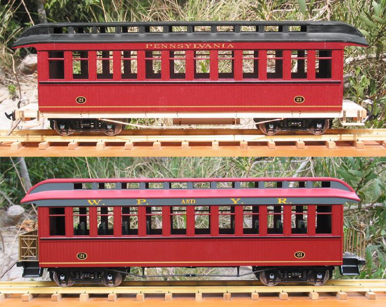

The other issue with the Bachmann models is that the roof canopies are too short for the larger scale and had to be extended. Splicing in extensions wasn't going to be easy and the project sat around for several years taking up space until I was able to get the spare roofs from Rik.
This composite pic. shows a modified body with the extended roof and new under frame, with the unmodified body below for comparison.

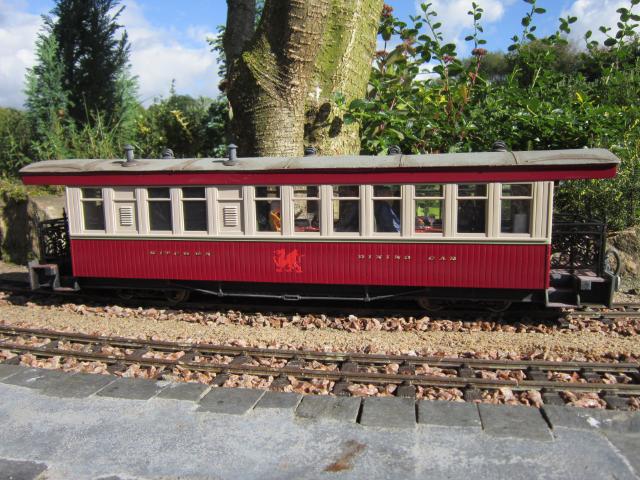

These are the three I converted for my own line.....
Annie
Post by Annie » Sun Dec 20, 2015 10:54 am
I particularly like the centre vestibule coach Peter :)
