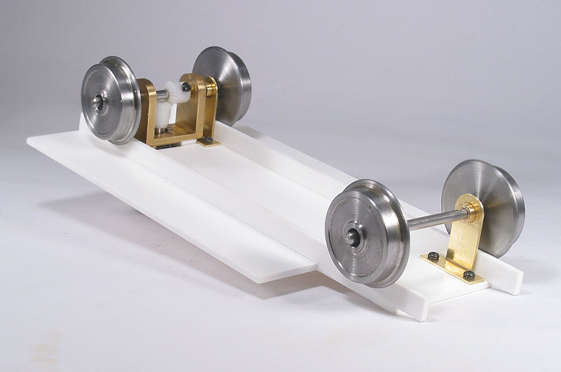

The first photo shows the basic chassis, which is mostly polystyrene sheet, with brass parts used where needed for bearings, gearbox etc. The basic chassis is fabricated from 0.080" polystyrene sheet, with the mechanical parts fixed in place with M2 machine screws. The chassis rails and leaf springs were fabricated from various size polystyrene strips and simply glued into place.

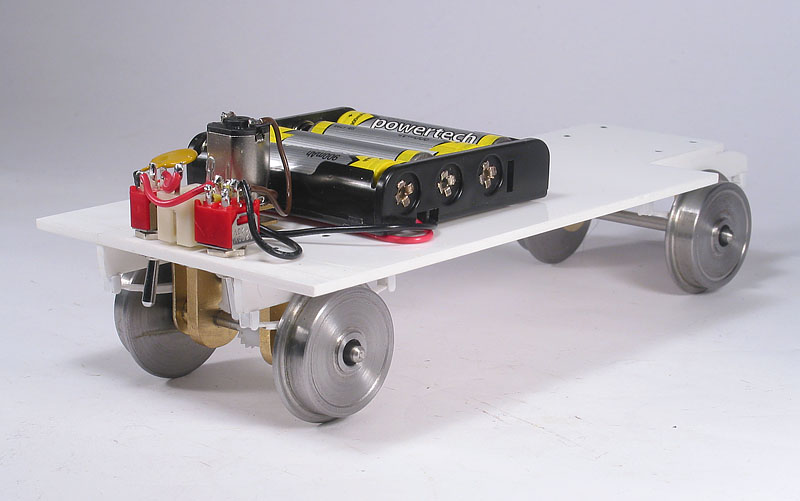

The next photo shows the chassis wired and ready for a test run. Test runs on the backyard track showed it was running too fast and so one cell in the battery was replaced with a dummy cell. This reduced the top speed to about 20 scale mph which looks about right.

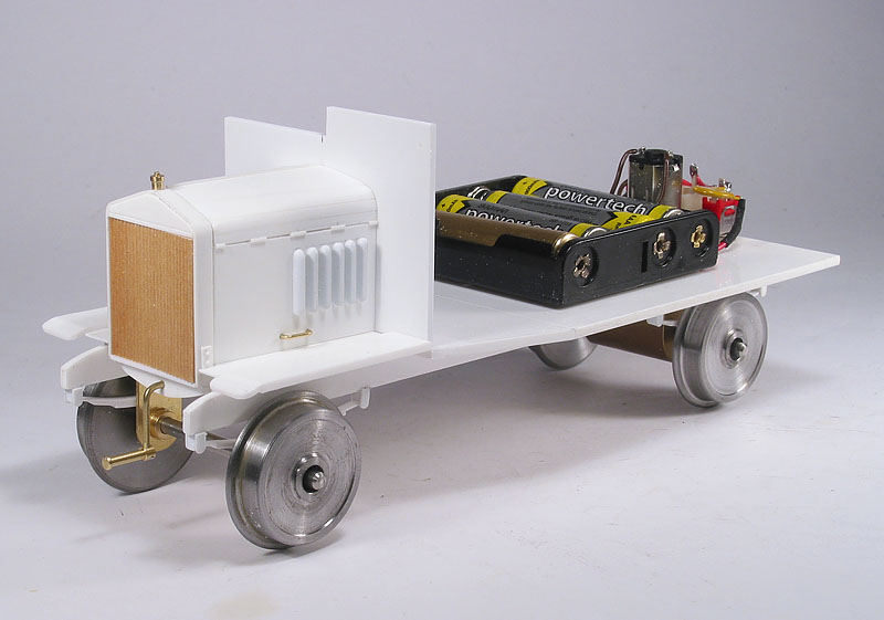

The next step was to fabricate a 1917-23 Model T bonnet and radiator assembly and fix it to the chassis with a couple of screws. Note the dummy cell is now fitted in the battery holder.

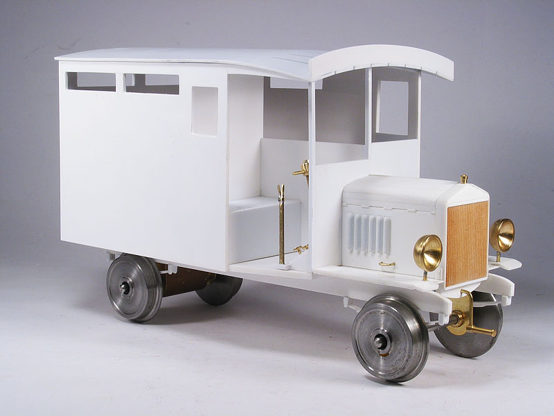

The body is a fairly simple fabrication out of various thicknesses of polystyrene sheet and strip. The only difficult part was forming the compound curve at the front of the roof. The completed, but unpainted model is shown in the next photo.
These old ambulances were very small and it will be noticed that the body design has only a half cab. The driver sat at the controls, with the patient and stretcher partly in the cab and the jockey sat in the back keeping an eye on the patient.

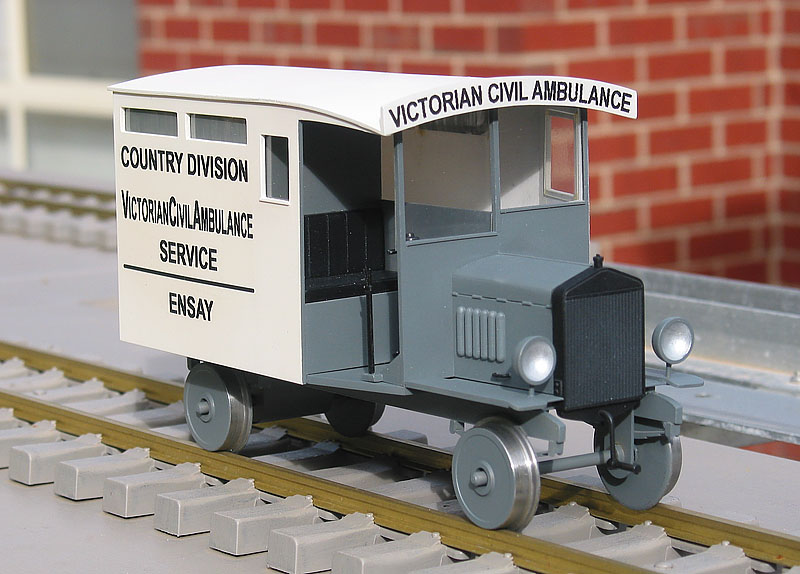

The final photo shows the painted and finished model out on the track sitting in wintry sunshine before a final test run. Don't let the weak sunshine fool you, it is late winter here and yesterday was as cold as charity and blowing a gale.
