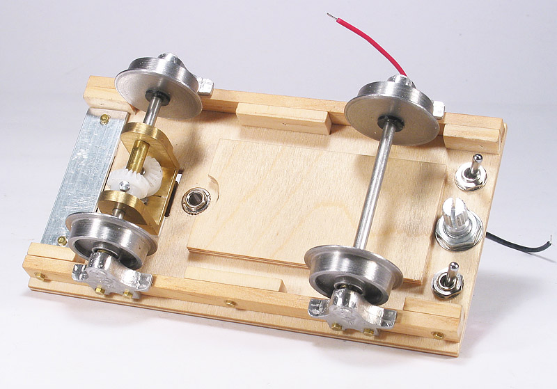

The first photo shows the first drive train and associated electronics assembled for testing, showing the underneath of the chassis. The motor is a small 6V MFA-Como geared motor, with plastic mitre gears and my simple transistor speed control.
The gearbox is machined out of a lump of brass and the gears are 0.5Mod mitre gears, which were the smallest I could find locally. The speed control, reversing switch and on/off switch are to the right and the charging socket is between the gearbox and the battery well.

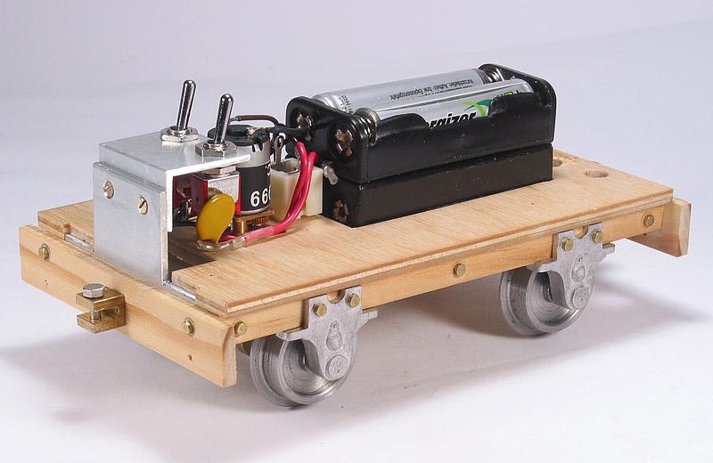

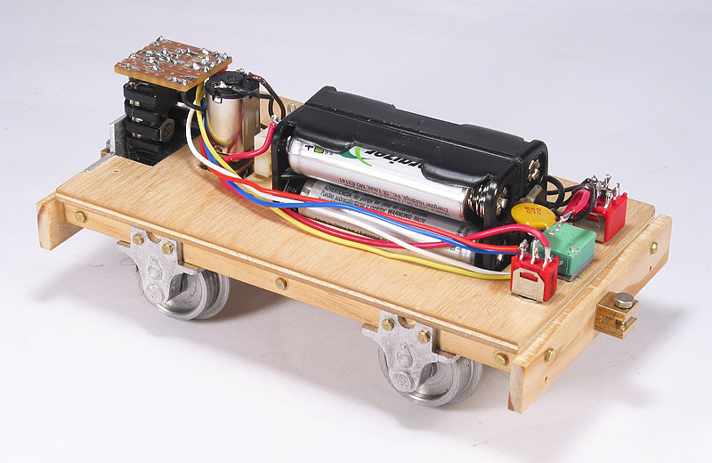

The next photo shows the chassis from above. From left to right are the speed control board, motor, charging socket, battery pack, speed control and switches. The battery is four AAA size NiMH cells. The yellow disc is the PTC resistor that acts as a 1amp resettable fuse, limiting current from the battery if a short occurs.
Well, that didn't work when tested.......... :shock:
On investigation, it turned out the motor starting voltage was about 4.5V. So with a 4.8V battery and the voltage drop through the drive transistor, the motor never saw enough volts to start. Back to the drawing board.
The next photo shows the solution, using just an on/off switch and a reversing switch instead of speed control. With this arrangement, the chassis trundled around at about 10 scale mph, although the acceleration would give a dragster a run for it's money. With the drive on the front axle, it can't do a wheel stand though.
Before anyone asks, lithium batteries are not the answer, as they won't fit in the space available, which is 25mm x 25mm x 100mm and also contains the motor, charging socket and switch panel.

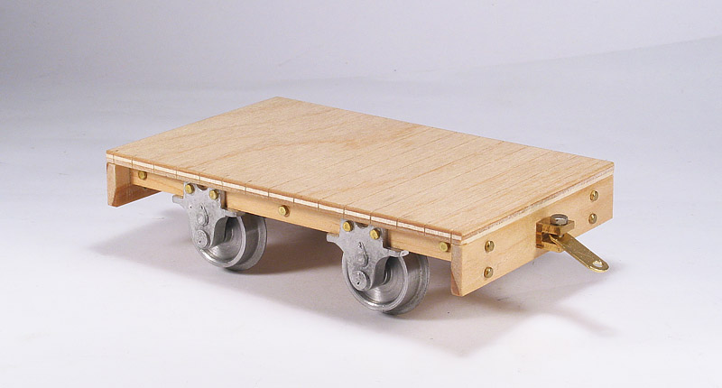

A gang motor needs a trolley for carrying replacement sleepers, tools and anything else needed for routine track maintenance, so the remaining parts went into a simple flat truck to match the gang motor. This took all of a couple of hours to assemble, much of which was spent scribing a piece of ply for the deck.

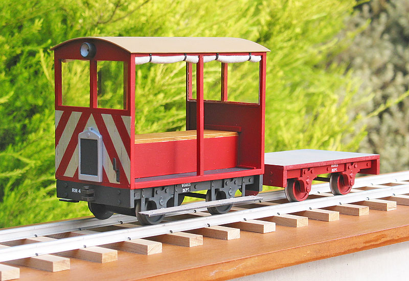

The first photo shows the portrait shot of the finished gang motor and it's trolley.
The last photo shows it trundling around the track at about 10 scale mph. The driver figure is 1:20.3 scale and shows how small this thing is. The sun also put in a short appearance during the run.

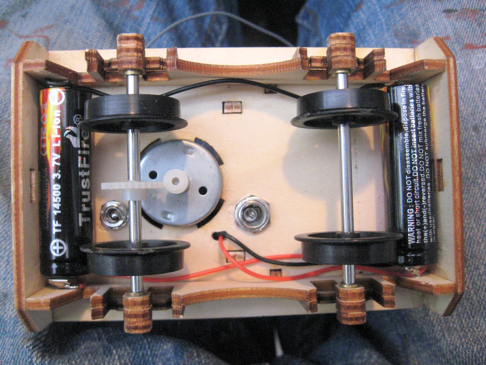

Post by ge_rik » Fri Jun 21, 2019 3:59 pm
Hi Graeme
I managed to squeeze a couple of 14500s under the frames on one of my IP Engineering builds. Not sure if you have a similar amount of space on your speeder, though
Posts: 1721
Re: TVT - Gang Motor
Post by GTB » Sat Jun 22, 2019 9:56 am
ge_rik wrote: Fri Jun 21, 2019 3:59 pm I managed to squeeze a couple of 14500s under the frames on one of my IP Engineering builds. Not sure if you have a similar amount of space on your speeder, though
Not enough space in that area of the model for the AA size 14500 cells, but in any case it is taken up by parts of the speed control when that is fitted.
