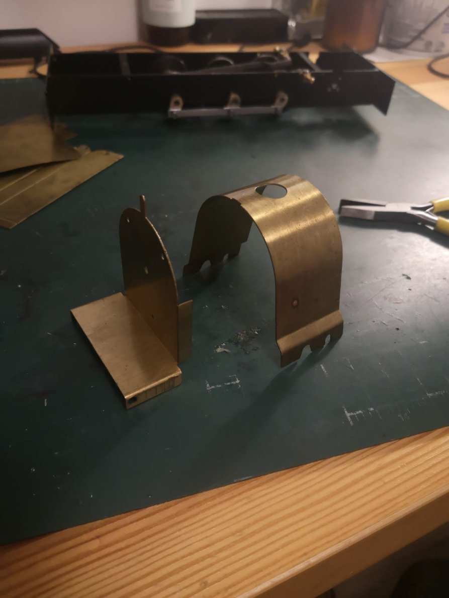

I decided to bite the bullet and get to soldering the bodywork. The cab and side tanks were basically the same as my Lady Anne, so no surprises there. The smokebox and saddle tanks took some creative setups to clamp everything in place whilst I soldered everything, but it wasn't too difficult: Roundhouse don't have the instructions for these older models anymore, but I'm muddling through. It looks to me like the rear lamp brackets are intended to be fixed on using these 'rivets.' The only way I can think of fixing these is by hitting the shaft of the rivet from the backside in order to round it over though?
The other mystery is what I believe is the battery box. I think it goes on the underside of the cab roof as on my Lady Anne, but it's a very different shape, and I'm not sure how it accommodates the likely 4 AAA batteries...?
