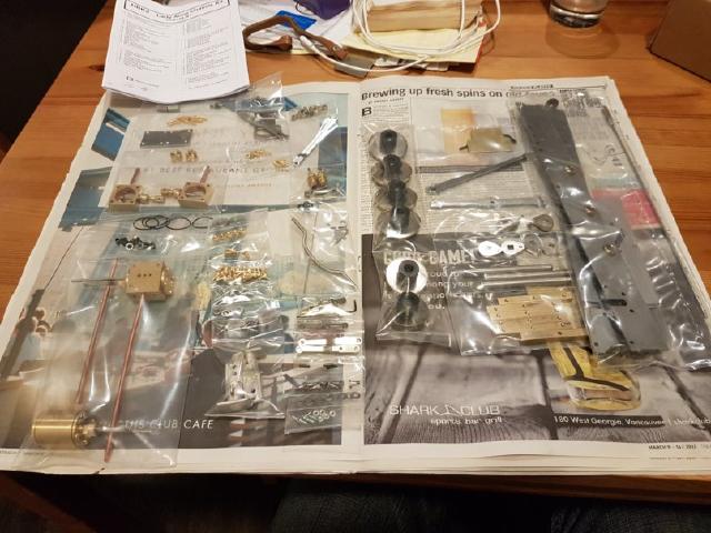

Frames built, lightly rubbed down, and thoroughly cleaned in hot soapy water. Important holes and threads masked out.
Having done that, I think I'm going to clean them with heavier duty degreaser before I paint them, just to be safe.
One thing I can't decide is whether or not to paint the end handrail on the coach. It looks a bit odd to my eye having the steps in black and the handrail in brass...

Current state of play as of Sunday night:
Frames painted with Dupli-color self-etching primer and perfect match universal black top coat. Wheels and outside cranks installed.
One of the rear cranks seems like it's not on completely straight, despite my best efforts to line the g-clamp up correctly. We'll see if it binds with the connecting rods on. If so I guess I'll have to bring it in to work and use the big vice (with rubber jaws!)

Lots pf progress last week. As of Sunday night, this is where I'm at.
Rods and cylinders fitted. The valve gear is fitted to one side, but unfortunately, in my enthusiasm to make the most of my having the apartment to myself Friday night, I failed to heed the warning of the instruction manual, overtightened the expansion link bush, and broke it. So I've only been able to fit the valve gear to one side, and I'll have to order up a replacement from Roundhouse in the morning...
In the meantime the smokebox, roof and lubricator are all painted in Plastikote matte black engine enamel. Tomorrow I'll see if I can pick up the top colour. I'm hoping to go for something like FR Victorian Maroon, but getting something in a BS paint code isn't going to happen here without going to a very specialist auto body shop, so it'll be something that looks 'pretty close' to my eye.
I'm certainly having a lot of fun so far!
