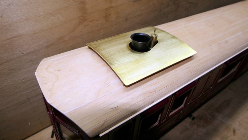

Here is the next stage, firstly the brass panel made to cover the hole in the roof with hole for the chimney/safety valve.

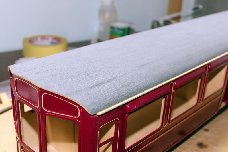

Next a shot of the roof covered with a piece of fabric from an old shirt.
And a close up of the roof painted. It was just sprayed with grey primer and rubbed down lightly to remove some small blobs (it was an old tin !). Quite pleased with the texture of it and the way you can still get an impression of the planks underneath.

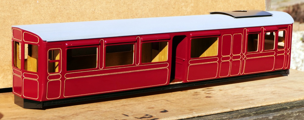

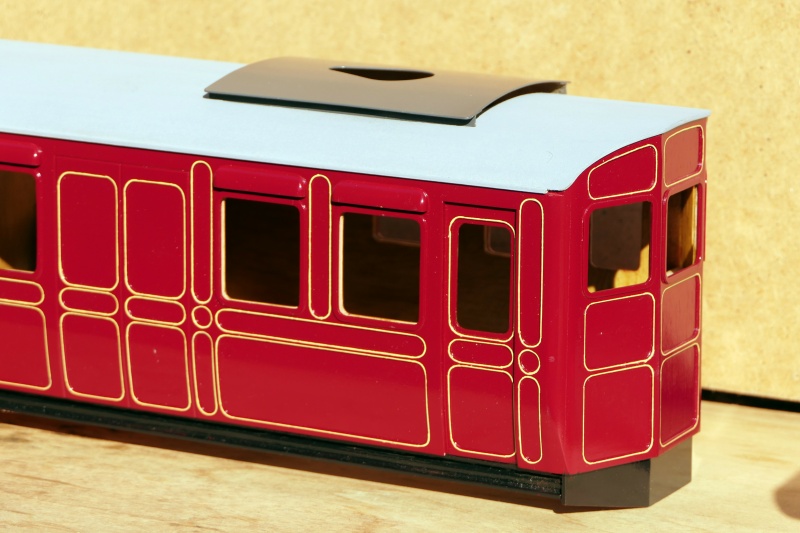

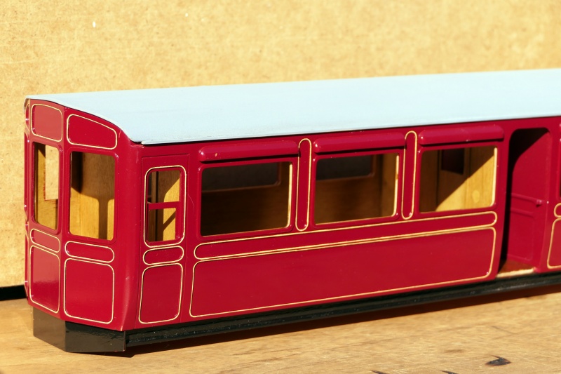

Finally the lining completed and the roof fully painted. The lining wasn't quite as perfect as I'd hoped but after a bit of tidying up it looks good under the 6ft rule. Maybe even get away with 3ft ! Originally I wanted gold lining but when I tried it it wouldn't go on nicely and surprisingly didn't show up very well so I started again and found another colour from Humbrol which I think looks ok. I'd also started varnishing the interior by this stage.

Beautifully lined, a very steady hand at work there. I find that high gloss paint and strong light can be cruel sometimes, so finish my carriages with Halfords Satin Lacquer, which gives a lovely smooth top coat with no reflections.
I have tried (and failed) to find an alternative, on-line supplier, so Halfords is the only one I know.
Re: Something a bit unusual - a steam railmotor
That paint job is superb and you have nothing to be ashamed of there. The lining is as good as the rest of it.
I agree with Peter about flattening the gloss finish, though.
