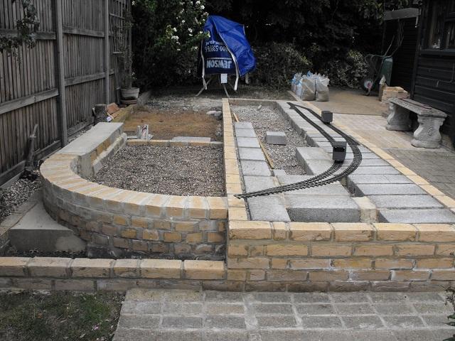

On the left behind the curved wall will be a chalk quarry with a slope up to the station area with a transfer point via an embankment and tipping facilities. The station area will be most of the length of the bricked in rectangle with a loco shed, goods yard, loop and sidings. It's taken a while to get to this point and I expect it will take a lot longer before trains run!

I'm in the process of building a garden railway, 16mm/ft narrow gauge on 32mm. When driving on the Kent & East Sussex Railway I much prefer a day shunting to a day charging up and down the line. It's the same in the garden so I'm building a fair sized station with a relatively small running line.

The Plan. Subject to alteration the next time I sit outside my workshop with a cup of tea. Sorry for the crude drawing. The area designated for railway use is about 22'0" by 9'6". The station area is about 18'0" by 4'0".
The quarry will be laid with Chad Valley brass track - fearsome radius curves! I hope to build some stub points from this track for a loco spur and a run round on the quarry floor. The quarry incline will end up above the level of the main line so that quarry wagons can tip into main line ones.
I intend having a long run round loop at the back, mainly to house stock. The station platform will be somewhere between the main line and the line that runs to the 'back' of the station area. There will be a loco shed and servicing area, using a badly made first try at building a brake van from scratch as a mess room.
Track in the station area will be laid on blocks with gaps here and there for planting. The 'L' shaped bit that isn't station are or quarry will be covered in 20mm gravel - you can use a garden vacuum on it without lifting the stones!
There won't be much of a passenger service and carriages with more than four wheels will be unheard of.
This is all going to take ages of course.

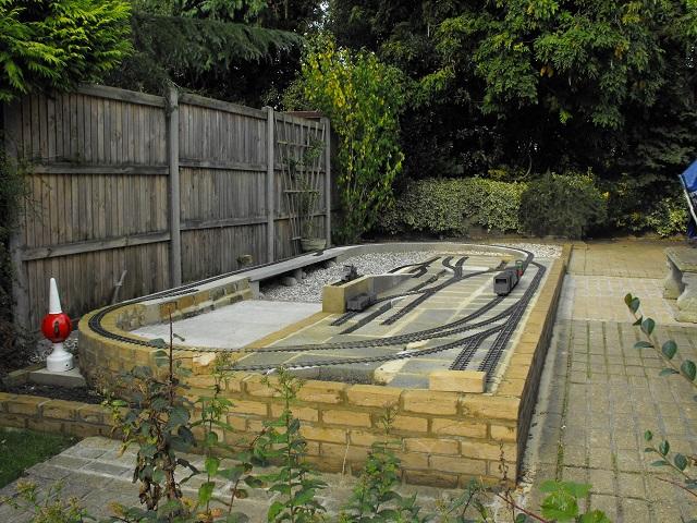

All the ‘main line’ track is down, not all fixed yet though. From right to left – three road goods yard, loop, main line with the train in it (there will be a platform on the left of the train) station back road, loading dock road. In the background is a two road loco yard. The quarry tramway inclines are both in, one leading up from the quarry and one to the loading dock.

The bricks are only temporary! However I intend making at least one of them out of concrete. In 1944 my Grandfather drove a USATC 2-8-0 off the end of the turning triangle at Eastleigh shed - he'd not driven one before and nobody told him the steam brake was relatively useless and needed a lot of warming through. The buffer stop that he demolished was replaced with a number of large blocks of concrete which are still there in the undergrowth.

Your layout is looking very good. The hard work of preparing the track bed is paying dividends now. It's looks very neat and tidy.
