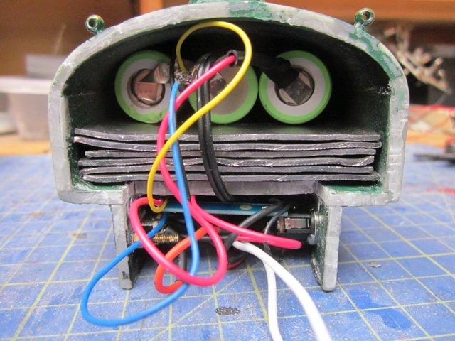

I realise I'm a bit of an oddity on the forum as all my operational locos are battery powered, including those which are steam outline. Mind you, I'm also an oddity on the G Scale forum as I've now abandoned track power, and all my stock is UK based. However, I am perfectly happy ploughing my own furrow as battery power suits the way I operate my railway.
I just thought I'd share with you how I've gone about my latest conversion from track power to battery in case it's of interest.
I constructed a Hunslet-style loco a few years ago from a GRS kit on an LGB Toytrain 0-4-0 motor block. Since I went over fully to battery power, she has been languishing on a shelf. I was worried I might irreparably damage her resin castings when taking her apart to create space for the batteries and electronics. As it turned out, some gentle prising with a flat bladed screwdriver was all that was needed. However, I felt her paintwork needed rubbing down as it had suffered in the process:
After removing the lead 2kg of lead weights from the saddle tank, I found there was room for three 3.7v 3000mAh 18650 li-ion batteries and some lead. These batteries have solder tags.
As the batteries were 'unprotected', I installed a battery protection board, which monitors balance charging and protects against over discharge, short circuit and over-heating.
You've probably heard the horror stories about lithium batteries exploding and catching fire. There is some risk associated with using them, but provided they are electronically protected, charged carefully and not abused, I feel the benefits of using them outweigh the risks.
A Deltang Rx65b combined receiver/ESC was then wired in. Both the protection board and the rx fit into the lower half of the boiler.
The charge socket is a bit prominent just below the saddle tank, but there really was nowhere else to put it.
I've given her some test runs and she seems to perform well. She's urgently in need of a repaint - I'll post some more pics and maybe a video when she fully enters service.
It's great to have a Hunslet (ish) loco back on the line. Doesn't feel right running a ng light railway without one, somehow.

Nice to see the conversion Rik, where did you get the LiIon batteries with the tags on from?.

Gralyn:112045 wrote:Nice to see the conversion Rik, where did you get the LiIon batteries with the tags on from?.
Hi Graham
I get mine through an eBay shop called Ecolux. There are probably cheaper sources but they seem to stock only branded batteries and the do test and guarantee the ratings on the batteries they sell.
These are the ones I buy
http://www.ebay.co.uk/itm/360970411157
I would urge you to get protection circuitry for them though. Li-ions are irreparably damaged if they are over-discharged. I've just invested in some smaller, cheaper protection boards from China
http://www.ebay.co.uk/itm/181777152056
I've no idea what they're like as I've only just ordered them

Post by big-ted » Thu Jul 16, 2015 9:11 pm
Nice little model. Looks like you could have squeezed another two cells in that saddle tank had you tried hard enough though!
Just to chime in on the battery issue, as it's an area in which I have some experience. There is a fundamental difference between lithium-ion, and lithium-polymer batteries. Li-ion are used in cellphones and laptops, as they have excellent lifetimes and are very robust to charge-discharge cycles. Li-pos tend to be used in high current applications as they can discharge very quickly without damage to the cell.
Operationally, there is very little to worry about with Li-ion cells. The fire concerns apply only to Li-pos as they have very little internal resistance. This means that, should a short occur, the battery will happily provide extremely large numbers of amps, potentially melting wring and causing fires. In contrast, other battery technologies have more significant internal resistances, which limit the current that can flow even when the external resistance is zero (short circuit). Whilst sparks and damage can occur, it tends to be rather less catastrophic in these cases.
That said, Li-Pos can be used very safely without cause for concern. I taught a robotics lab in which I had ~40 students working with Li-Po batteries and, whilst we always had fire extinguishers and sand buckets to hand, we never had any problems in 3 years of my running the course. Just exercise due diligence is all.

Post by ge_rik » Fri Jul 17, 2015 8:50 am
big-ted:112078 wrote:Nice little model. Looks like you could have squeezed another two cells in that saddle tank had you tried hard enough though!
Thanks, that's very reassuring.
I had a suspicion that li-ion were inherently more stable and less volatile than lipo, but there does seem to be a general anxiety in some quarters about any type of lithium battery - not helped of course by the ban on sending them through the post.
