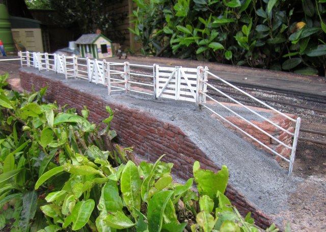

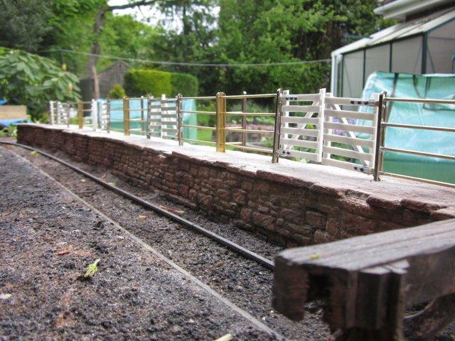

Been putting the finishing (well nearly) touches to my latest project - a cattle dock
Jigstones base + brass rail and rod + GRS picket fencing (bashed about a bit)
Still a fair bit to do. The railings need to be painted and properly bedded into the dock (which is why they're not all vertical as yet). The dock needs to be grouted and then individual blocks painted. But it's nearly there.
BTW - I know it's too narrow - but assume that the rest of it is 'off-stage'.

VERY nice INDEED! That's a superb piece of work. The fencing looks really good.
The track alongside it is some of the most realistic I've seen and compliments the dock itself very well.
I've got loads of questions!
1. How have you ballasted it?
2. Did you ballast up to the dock wall?
3. What have you made the walls of the dock from?
4. Are the walls self coloured or painted?
5. What have you used as railings/wires between the posts?
I don't mean be a nuisance but I'm keen to learn for future projects!

Post by ge_rik » Wed May 20, 2015 9:23 pm
Soar Valley Light:111001 wrote:Rik,
Thanks Andrew. I've been experimenting with ballasting the track at the station. The basis for what I did is here:
http://riksrailway.blogspot.com/2015/05 ... crete.html
.... but since writing that posting I've been experimenting even more. I'll get around to adding more info to the blog but in the meantime...........
After I'd embedded the track, I then applied a dry mix of soil, sand and some crushed coal - and then dribbled Febond SBR adhesive over it. Even then, I was not that impressed and so applied a very light wash of black and brown cement dye over it to darken it down a bit.
Soar Valley Light:111001 wrote: 2. Did you ballast up to the dock wall?
Yes - I built the dock first and then ballasted up to and around it as you'll see from the post above
Soar Valley Light:111001 wrote: 3. What have you made the walls of the dock from?
I've blogged the building of the dock here (not quite finished it yet)
http://riksrailway.blogspot.com/2015/05 ... tones.html
Jigstones for the wall - they were then lightly coloured with a mix of brown and red cement dye dry-brushed on. I want to pick out some of the individual stones with dilute acrylics later to give some variation - all a bit uniform at the moment.
The posts are Peco and LGB rails and the railings are 2mm brass rod.
Soar Valley Light:111001 wrote: I don't mean be a nuisance but I'm keen to learn for future projects!
Not a nuisance at all. Only too happy to share my dabblings with others - hence the forum and blog postings.
Like most people, I just keep experimenting and hoping for the best

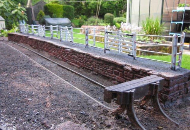

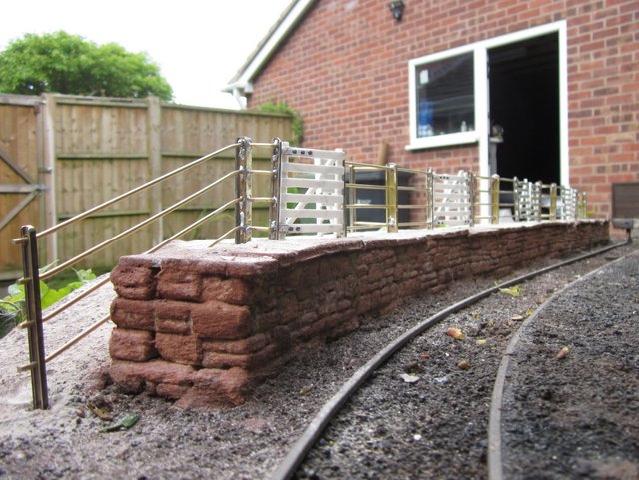

Just put the finishing touches to the dock.
Hopefully will be able to test it out for real with a running session if the weather holds.
Post by Soar Valley Light » Sat May 23, 2015 11:13 pm
It looks really good now it's finished Rik. It looks like it's been there for years, the weathering is perfect. I really like your buffer stop, very nicely formed.
It will be an interesting addition to the timetable, I'm sure it will add a new dimension to the operation of the line.
