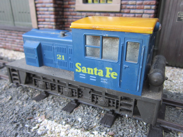

Having just uncovered a pair of the above in the "might come in handy" box. I was wondering if anyone has successfully used one with battery control. I don't know how well they ran originally, so before I start building a body to fit I would appreciate other options. Basically if they are a load of crap then I won't waste any time on them.

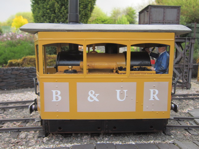

Only too pleased to help Jim...
This chassis was a gift from Big Jim for me to modify...
My solution was to build this...
The loco itself weighs 1.496 Kg.
To test its pulling power I have attached a train of assorted stock comprising 3 bogie coaches (12 axles), 1 bogie wagon (4 axles) and a loaded wagon (2 axles) with a total weight of 5.238 Kg (excluding loco)..... Grand total... 6.734 Kg. It handled this load with no problem, even on curved track, although it is level!
I must say I was quite impressed as I have never tried this before.
I hope this helps.
Edit.... forgot to add... powered by 10 rechargeable AA batteries (12v)
