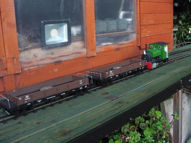

Post by Gralyn » Sun Jan 04, 2015 6:52 pm
I had the first run on the Overdale Valley Light Railway today. It was to try out a pair of Newquida bogie wagons after regauging from 45mm to 32mm.
and
Two short Videos both show that there is still a little work to do checking the back to back measurements as both wagons came off the track without any noticeable reason. Both wagons were ballasted but I think the ballast needs to be on the bogies rather than in the wagon

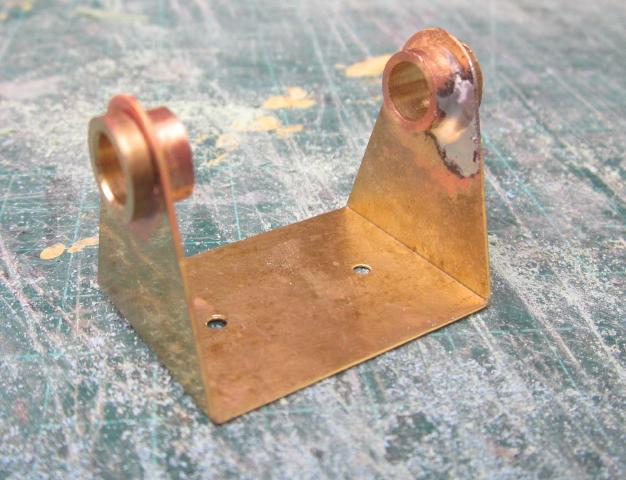

Post by Peter Butler » Sun Jan 04, 2015 8:38 pm
On some of my stock I sometimes, although not always, us a sort of compensation. In the first picture I have made up two identical units to hold the wheels and axles. On the finished model one of these is fixed to the underside of the truck, the other has a small brass tube attached in its centre line on top of the unit running from back to front. This is then fixed to the vehicle with a wire threaded through the tube and the unit allowed to tip by a small amount left and right. A spacer equal to the additional height of the tube should be added to the fixed unit to keep the vehicle level.
The second picture shows the two units attached to the undercarriage separate from the chassis rail so movement is not restricted. It only needs movement of say 2mm to allow all wheels to stay in contact with the rails at all times.

Post by Soar Valley Light » Sun Jan 04, 2015 10:05 pm
Hi Guys,
I knew if I made a bold statement it would produce some comment! :D
Peter,
Your system is very similar to the compensation system used in scalefour. I'm sure it minimises the number of derailments on your line. I shall investigate something similar myself when I get round to rolling stock construction. It will be interesting to see how the various kits are suited to accepting such an arrangement.

Gralyn
Post by Gralyn » Sun Sep 13, 2015 10:56 am
mightymax:113403 wrote:Love the look of that little engine. Where did it come from and what powers it?
The small green loco is a Garden Railway Specialist generic Hunslet kit with their 0-4-0 chassis which can be bought with either 45mm or 32mm gauge. The chassis has a MFA como motor . My loco is battery powered 10 AA rechargeable batteries in the saddle tank and Deltang R/C.
