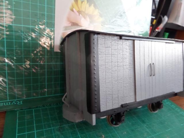

I use the end of my scribe to create the rivets on this wagon

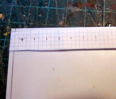

I made something similar from a piece of brass rod and some lead flashing - must admit I pinched the idea from a fellow modeller. http://riksrailway.blogspot.co.uk/2013/ ... icard.html
Something which I found helped to ensure the rivets were equally spaced was to sellotape a piece of graph paper to the plasticard and then prick pilot holes.
