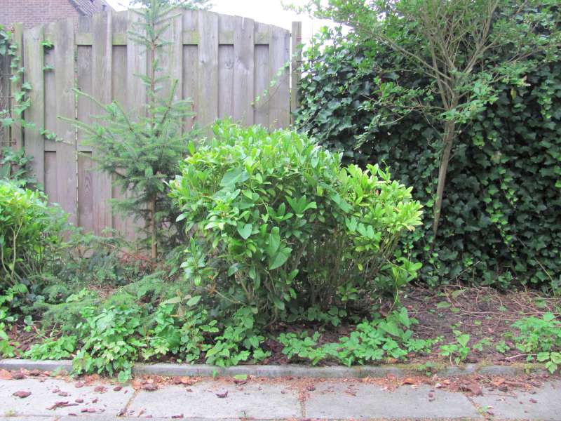

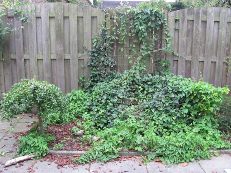

At the moment the reserved space is a bit of a mess, I tried to make a panorama photo, but that didn't work out quite well so two pictures.
Left. The first row of tiles are easily removed, which makes my space about 2 meters wide.
Right. (The other meters not shown in the picture are paved so of no concern.)
On the left is a small waterfall hidden. It's going to stay, but I'm planning to extend it with a canal to a small harbour with a pump circulating the water. This has two benefits: I can have a tunnel and bridges without raising the track. And, I'm Dutch, the Dutch like messing around with water. Give a Dutchman a plastic bucket and shovel at the beach and instead of building a sand castle he's going to build a dyke to hold back the sea!
On the right is my christmas tree, that one has to stay. On the far right all is quite dead already. My wifes dog loves to dig and roll in the dirt. Not too convenient for a garden railway, but to keep neighbours cats out I'll probably install a few high voltage wires around the railway anyway, so that solves two problems.

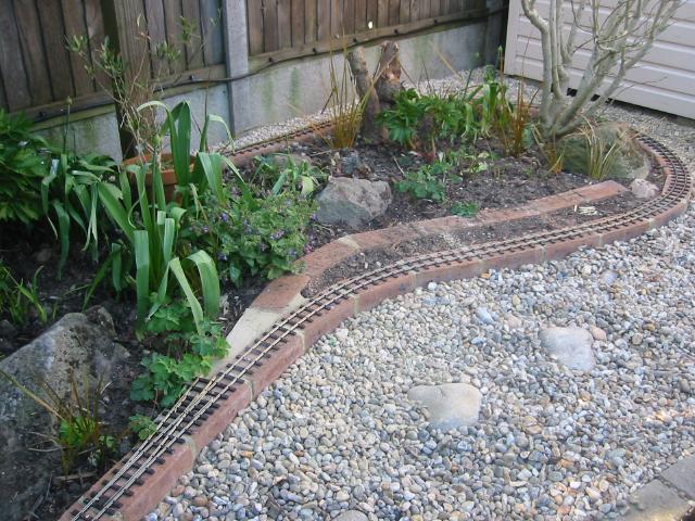

Like Gremlin, I've had little choice but to use 2'6" curves in my balloon loops. However I've used the Peco set 2'6" curves together with the Peco set 38" curves leading into the 2'6". Seems to work OK, not used the line much yet.
I bulked at using the flexi track on any of the above curves so ALL my track is laid onto my trackbed (bricks) and then ballasted. The ballast was then glued into place with PVA.
Trying to add a Facebook image (while camping in a field near Bude...)

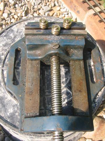

I made my own from an old drill vice, happy to lend by posting would be a killer.
all this track is flexi that's been through the above device. Although screwed down it will quite happily sit there and hold its shape.
