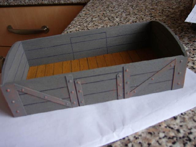

In between building a new r/c plane and refurbishing a guitar, I've knocked up my first 16mm wagon body, based on some of the excellent models I've seen on here.
More of a test piece than anything else, it's made from 1/8 balsa (all I had) and the strapping is good old Cornflakes cardboard with rivets embossed using a ball point pen. Yes, the end supports are lolly sticks!
A light sanding of the balsa then grey acrylic is brushed on the body with a stiff brush so it raises the grain a little - really more like brushing it into the body, rather than over it. The rust effect on the strapping was simply by scraping a suitable coloured pencil, dipping my finger in the resulting dust and rubbing it over the strapping, letting the edges and rivets take most of it.
Floor was done the same with brown acrylic, then after drying it got a watery dirty black acrylic wash to emphasis the planks.
This is a marvellous scale to scratch build in! (but then you all already know that
) Hardest thing to do is resist super-detailing everything. I've sent off for some axle boxes and wheels and will make a few chassis' up. Next bodies will be made of Liteply and have individual planks, as I'm not too happy about the 'drawn-on' planks; they look..er.. drawn on!
