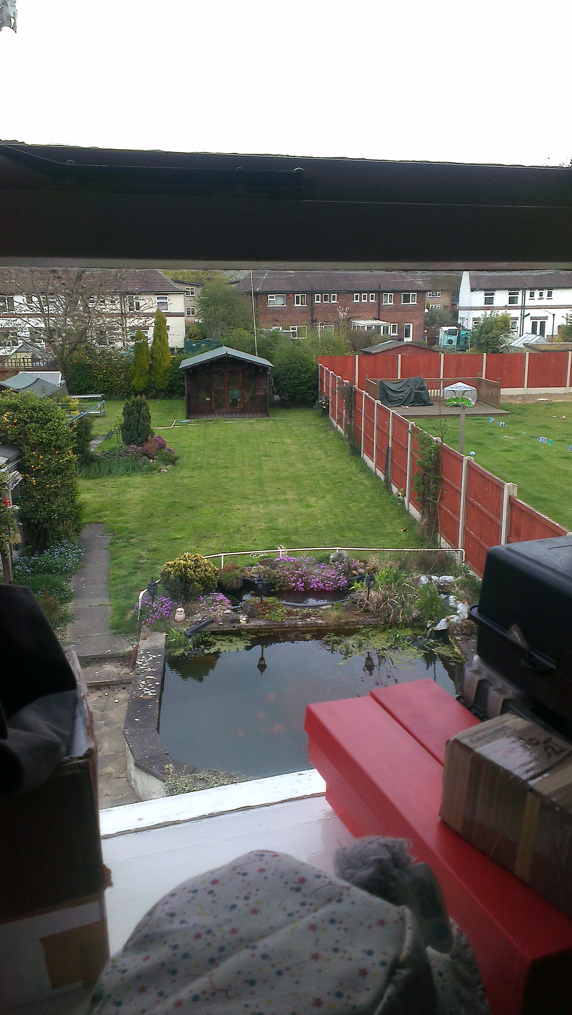

The garden is approximately 18 yards long from pond to front of summer house, about 3 times the of the old one, which means alot more mowing! :roll: So after about a week of sorting out the house, a few spare hours meant I could start surveying the line! I had already decided I wanted a ground level line, it had worked well on the previous DFLR and made scenery alot easier, though I had to admit it would be very useful to have a raised steaming area! Originally I had intended to send the railway up behind the summer house, but I decided that this wasn't feasible due to the area behind the summer house being uneven concrete and two very tight curves needed to get past the compost bins and the BBQ area (to the left of the summer house). So I decided to settle on a oval of track, round the outside of the garden (to help please the letting agent), with two stations.

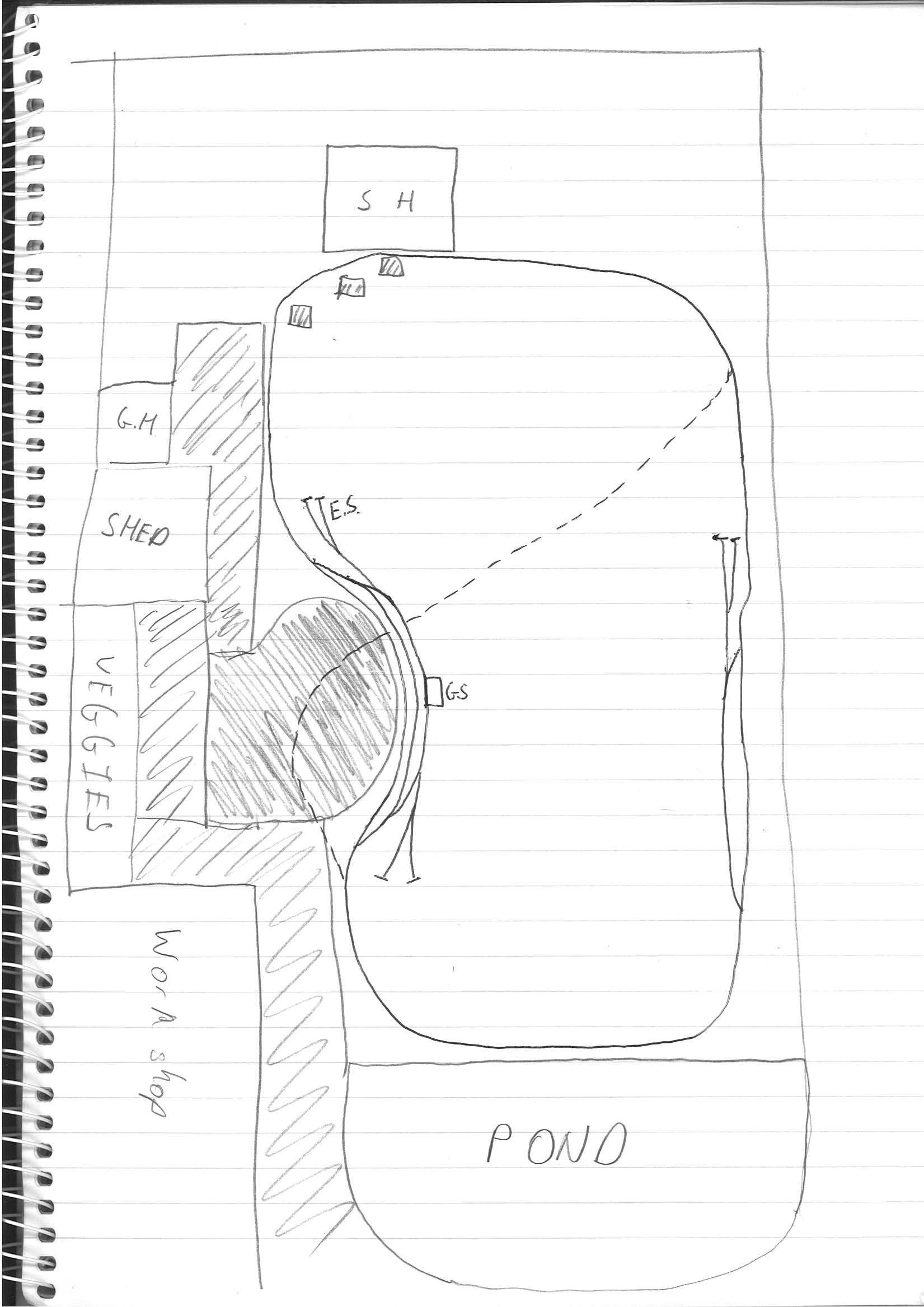

This is what I'm aiming to eventually end up with. The first stage is to build the oval with the two passing loops, then I'll start adding the sidings. The dotted line is stage after - I purchased a cheap bridge at Peterborough so I'm hoping to have a raised section which climbs through the flower bed over the station to cross the lawn. But I'll worry about that later!

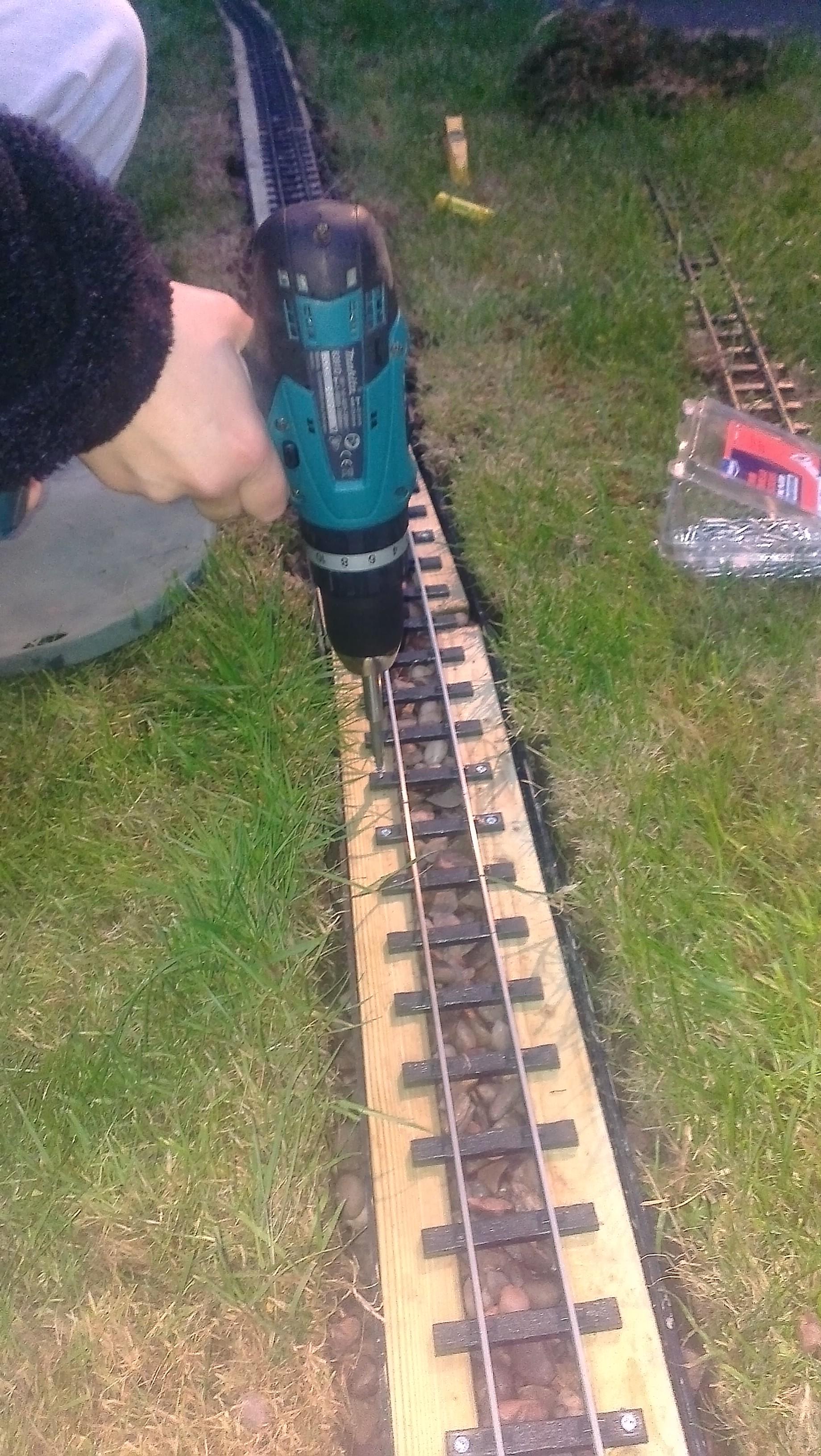

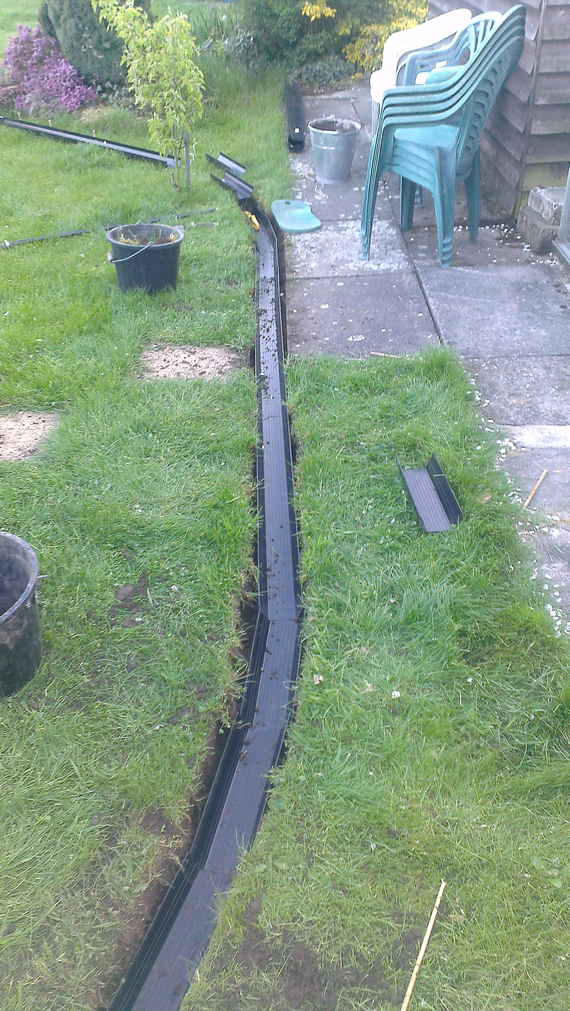

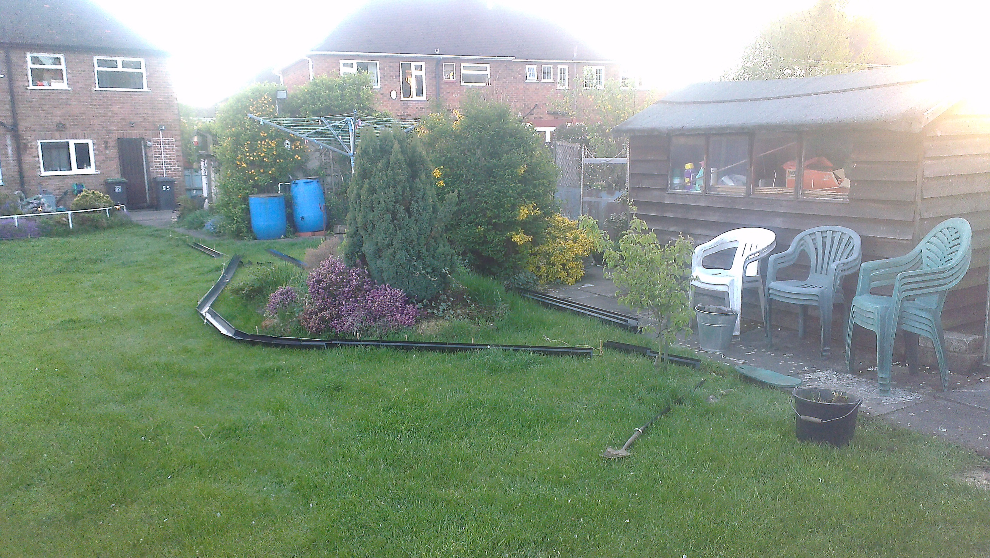

Once I've checked the levels (the garden is surprisingly flat, one side is about 3 inches higher than the other and the greatest variation was 4 inches in one spot), last night I started construction. I don't think I could get away with laying concrete blocks over the garden (if I owned the place I would), so I'm using the floating track bed construction method. I discovered that Wickes square guttering is easily wide enough to accommodate SM32 track, so I using this to stop the ballast from spreading out. I dig a trench, level the guttering out, fill it with about half an inch of pea shingle, then float the wooden track supports, screw the track to these, and finally top up with something that is close to scale ballast (when I find some). A similar method worked on the old DFLR and was relatively okay for 2 years, and since this is probably only going to be down for the same amount of time it should work quite well. I managed to lay 6m of guttering last night, and the play a bit with the pea shingle and wood supports in one section.
Click to see full size image
Sorry for the poor quality piccie, it was taken just after sunset as I started to run out of light. At the rate of progress, allowing for ringing commitments, I reckon 2 months and I might have a railway! [/img]

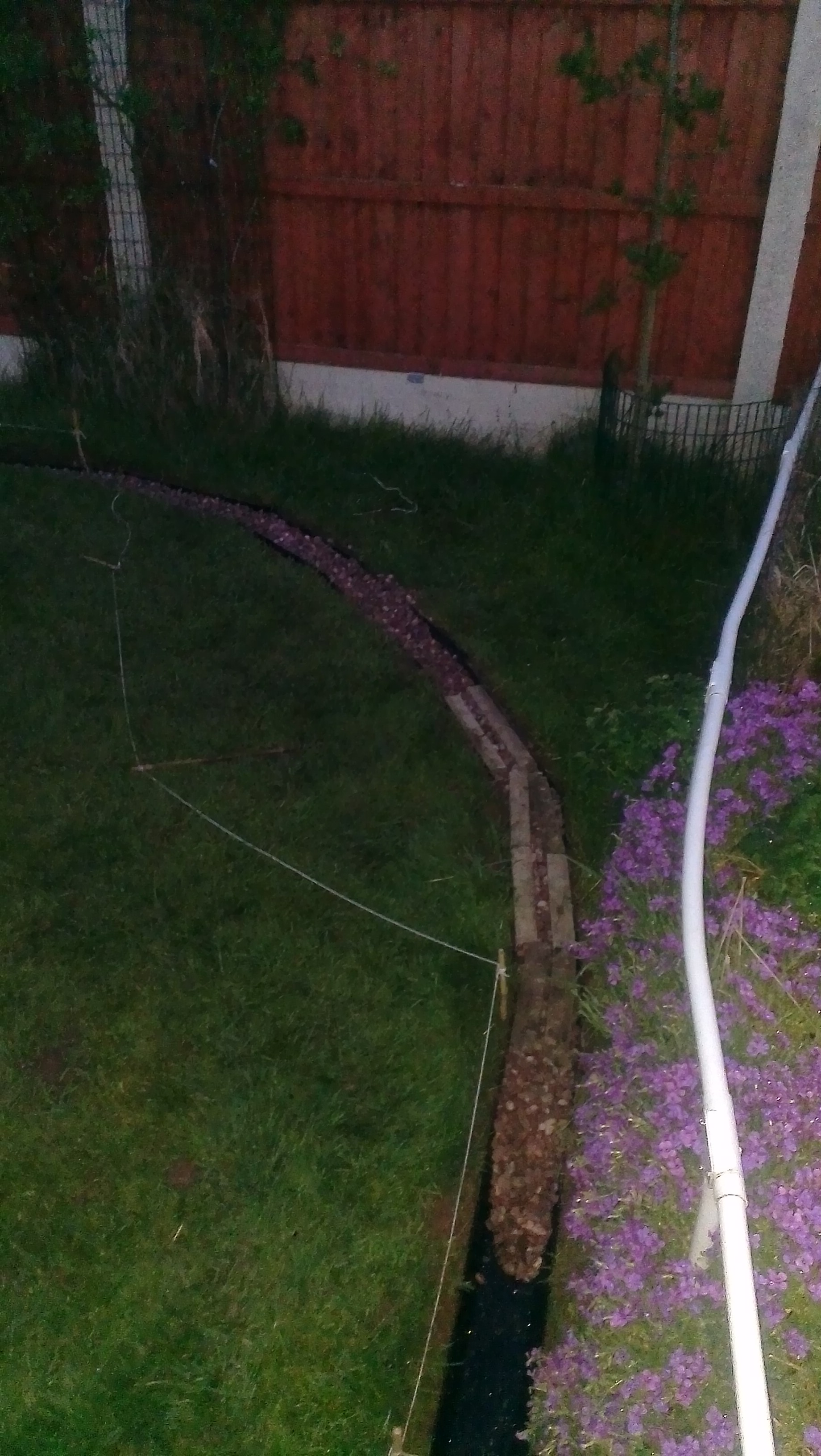

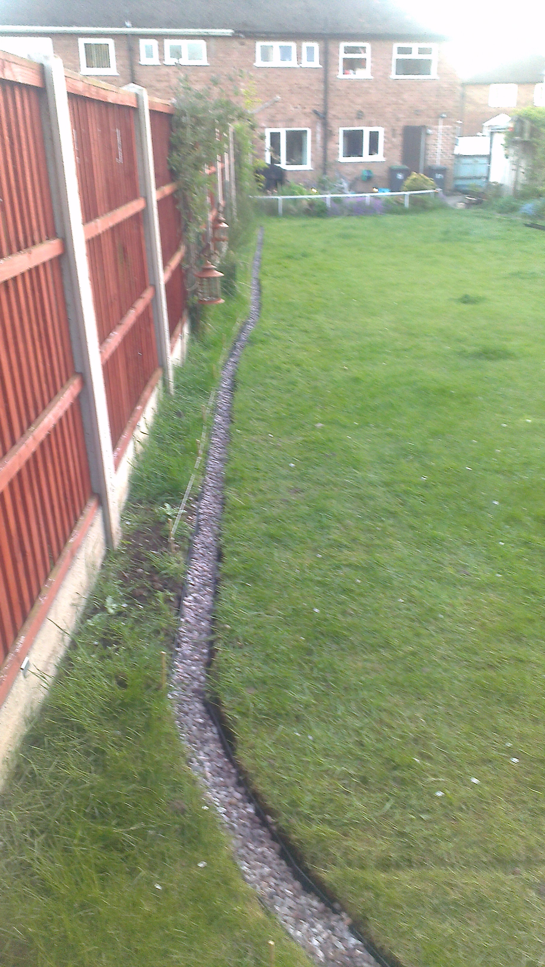

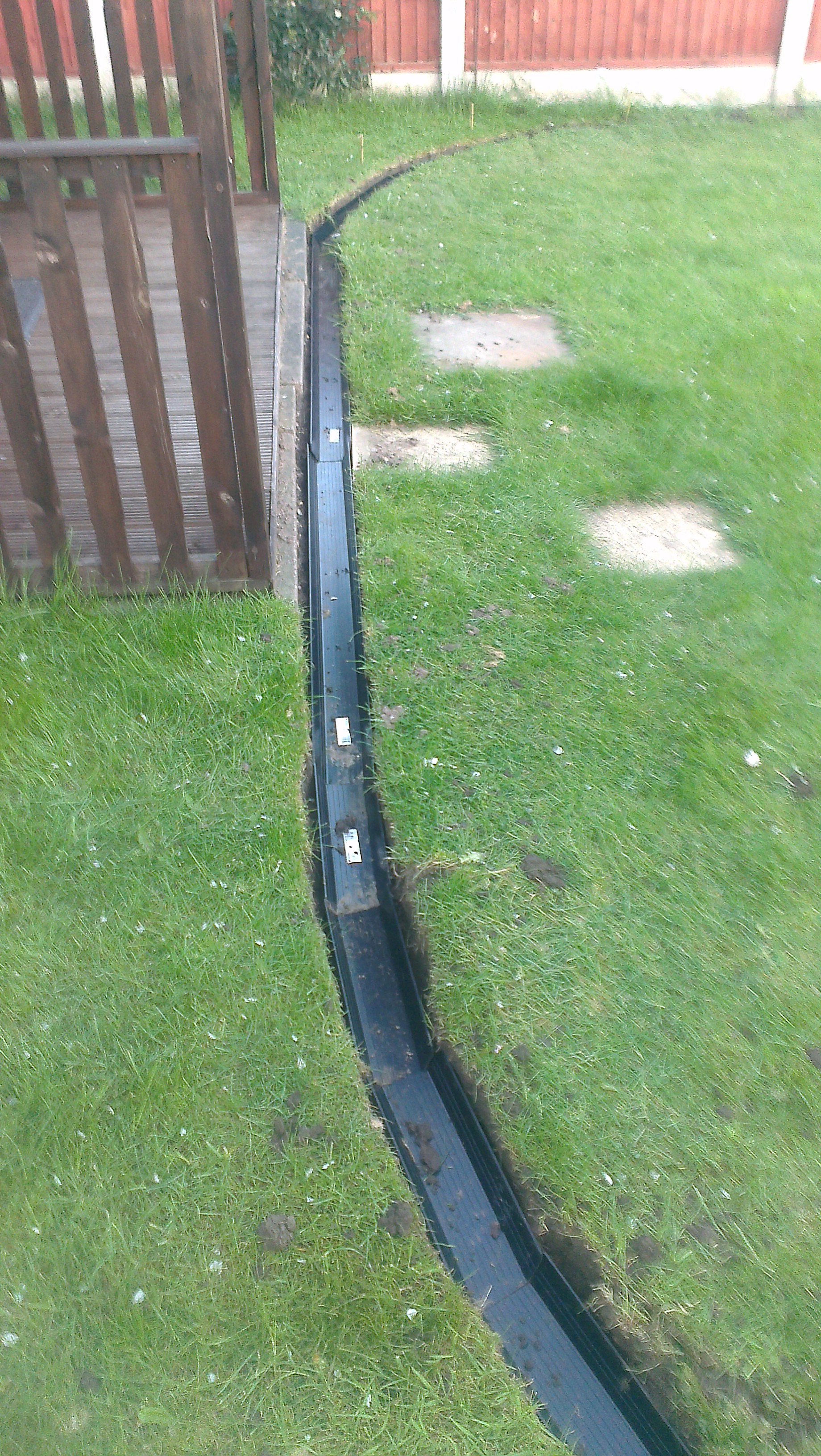

There has been progress, albeit slowly. Last Saturday in between showers and coming 2nd in the Crawford Cup I managed to get the track bed up one side of the garden and past the summer house.
I managed to find some more free time last night, so rounded the curve at the top and headed down to the station.

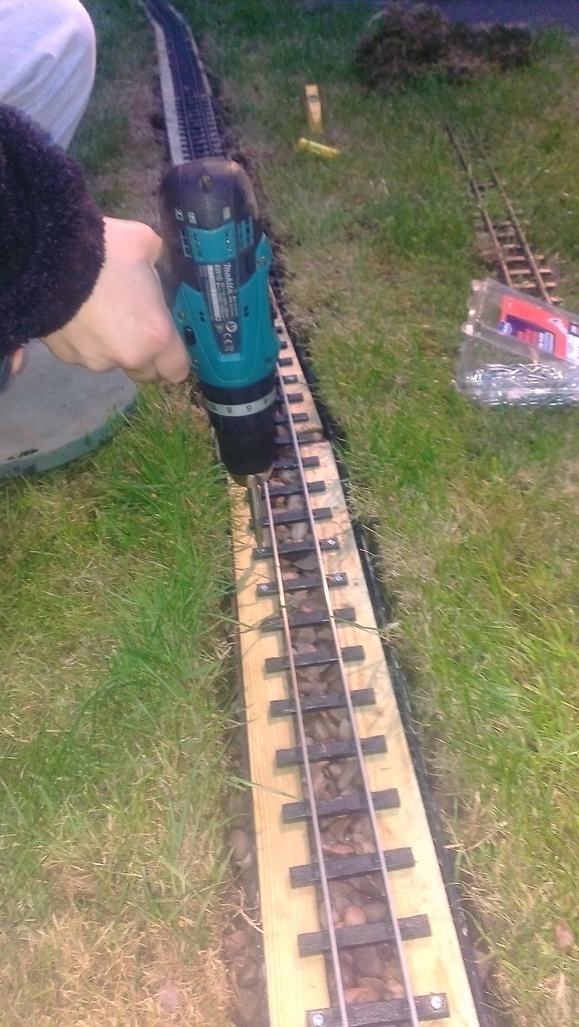

I managed to get the last of the guttering down on Thursday evening. After sorting out the old track from the previous DFLR incarnation, I started work on laying the new one. I'm down one side of the garden, around 20 yards in total. As the sun appeared late this evening I thought I'd use the opportunity to test out the DFLR's latest motive power acqusition, a Accucraft Caradoc, bought at the 16mm show. Below is a video of the first ever train movements on the new railway.

The guttering seems to be working really well. The big advantage I've found is that the floating track bed allows you to jack and pack the track to cover up the inconsistencies which inevitably appear. But I'm relatively pleased with progress. Now what to do with the big pile of turf!

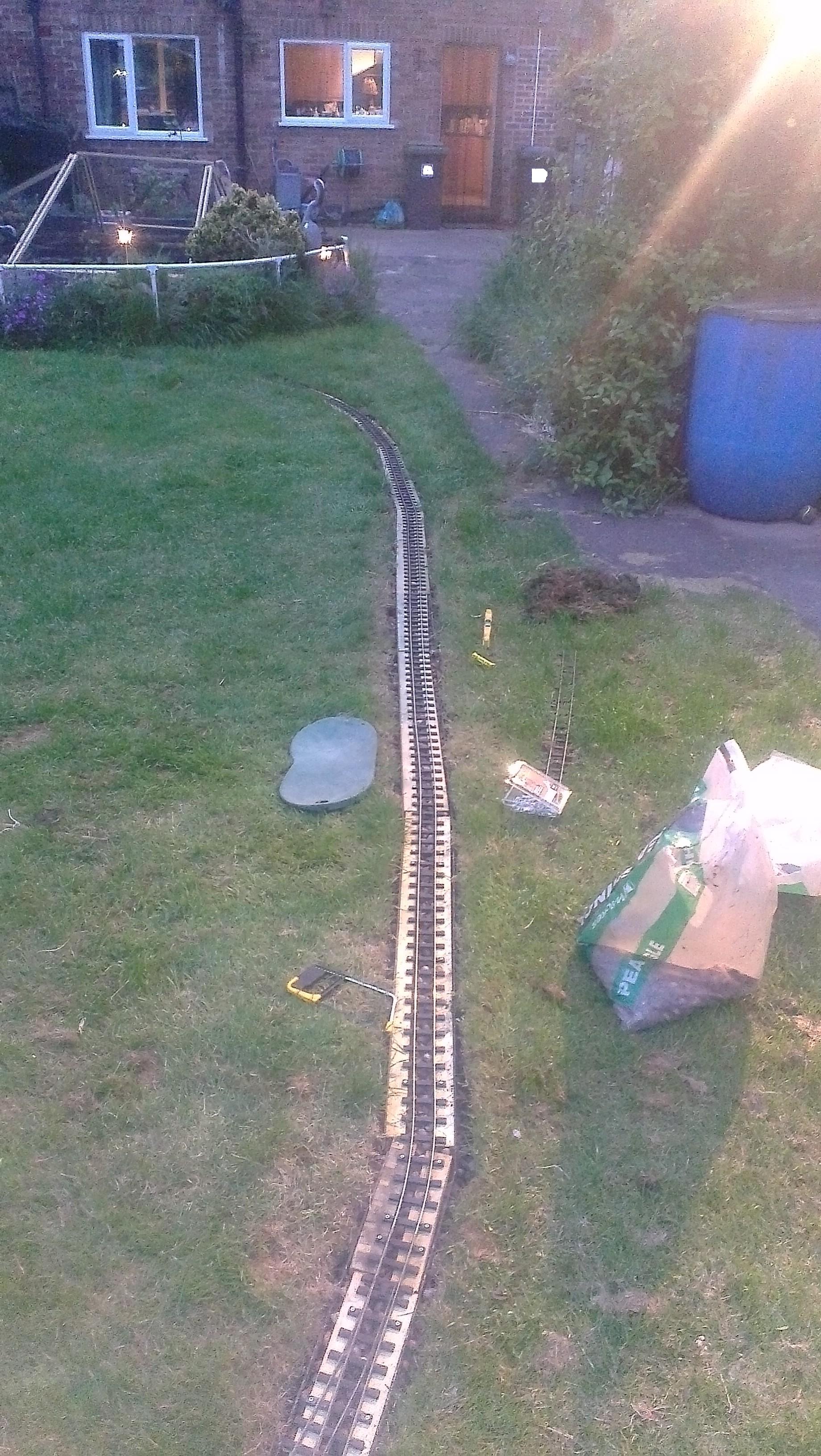

At 9:15pm on Thursday 30th May, the golden screw was laid in the final section of track that completed the DFLR's mainline. Hooray! :blob5:
After all the hard work surveying, I discovered that when I came to lay the last two yards of straight track between the two ends, they appeared pretty close to level (the bubble was slightly biased, but within the lines, to the eastern end).
Thats what I managed last night. The photo has shown up a couple of wiggles, which I will have a play with this evening. The intention tonight and tomorrow (I have a free weekend, thats positively shocking!) is work on the two stations, Much Camping, and Moggerhanger (Low Level). I'll take some better pics as well over the weekend, and who knows, maybe a engine will make an appearance!

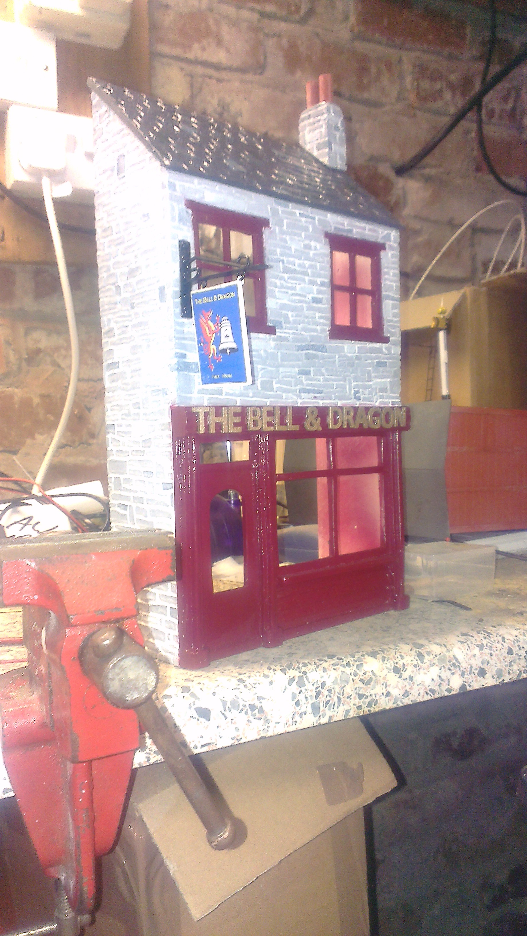

Well not much progress has been made on the railway as PhD work takes up more and more time. But I have been working on the first building for the line, and perhaps the most important. The pub!
Its in the middle of varnishing. I've also got to finish painting the guttering and make some lead flashing for the roof. I was pondering about frosting the glazing for the lower part to avoid making some hint of interior, any suggestions for doing this would be most welcome!

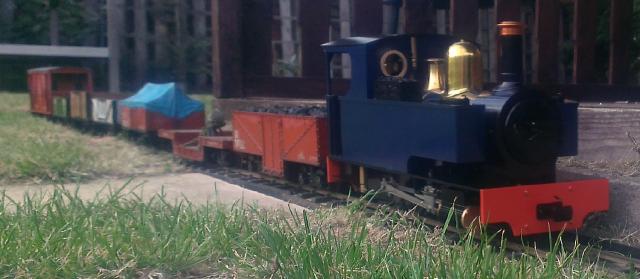

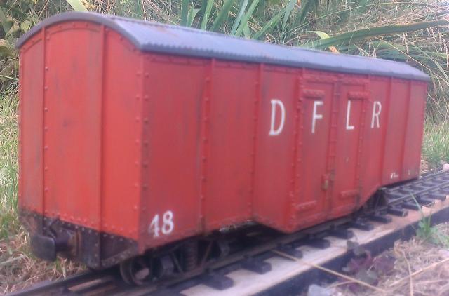

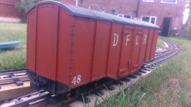

Well modelling time has been limited lately, but this week gave me lots of free evenings, so trains were running along with some workshop time. I spent last weekend relaying one curve where the curves were a little tight for comfort and one end had sunk giving a annoying gradient. But last night saw the completion of the new bogie van for the railway, vehicle no 48.
I'm not sure I've got the weathering entirely correct. Its a mixture of using enamel paints (the brush liberally wiped on some kitchen towel before application to the wagon) and some weathering powder I bought at half price from the modelzone closing down sale. I left the paint to dry for 24 hours and then it will receive several coats of matt varnish, mostly to protect the transfers.

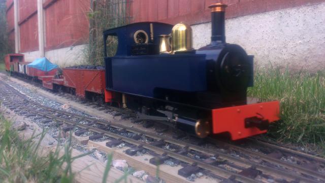

But there was still time to run a few trains. Sophie the Caradoc put in a sterling service on the evening freight. Countess was eventually declared a failure after I realised all 4 (yes all 4) of the fibre washers on the cab fittings had either split or failed, filling the cab with steam. Doh!
