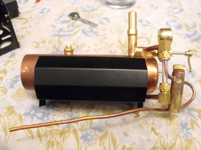

The main 'issue' that occured afterwards of the first run was this:
The fibre washer on Swordbreaker's water glass column had fragmented and was starting to leak. I steamed the loco up thrice more with this just about hanging on. There was a steamleak and there was jets of steam coming from it, especially on the second and third runs.
However...even with this leakage, the burner at near-minimum [less than 90 degree on the handle], it only took 10-15mins to get to operating pressure. Then when at full pelt, on the blocks, it was maintaining between 40-60psi for 15-20mins at a time - even with this and another leak in the rev block.
Can you imagine what it might be like if the loco was at optimum condition ie no leaks and all systems at 100% ?  8)
I'm going to be finding out - the photo of the water glass column above shows the new washer installed today after another shipment of spares from Roy Woods Models.

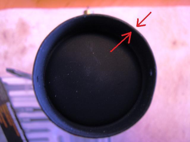

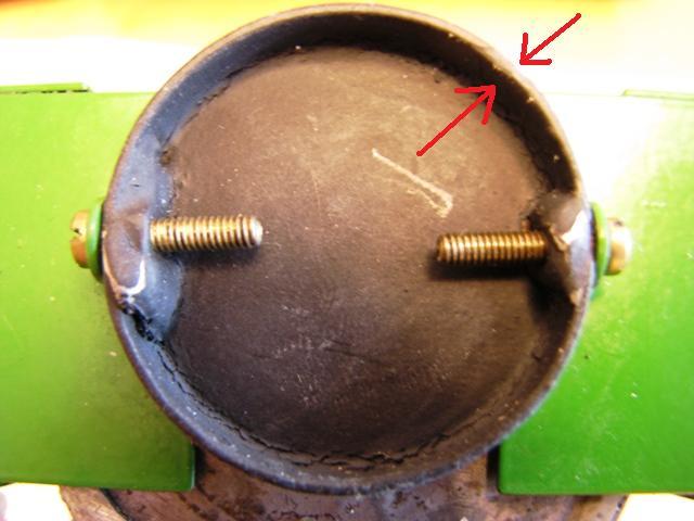

A couple of us have been speculating whether the PPS boiler might be thicker than the DS one. Having felt a DS superboiler, it seemed lighter than the PPS model - sadly, I had to rely on memory and this can be flawed. I'm willing to accept the margin of error here.
But why the sluggishness? I don't have a concrete answer yet, aside from the fact that when swapped out, the PPS burner has done just as well with the hindrances, as the Bix did with optimal conditions. Which make sone hopeful that the PPS with optimal conditions will be an improvement.
Now, boilers. There's my speculation about boiler weight and possible thickness difference...and another part which makes me wonder about this is the crucial part I had forgot until James and I were chatting at our last Butterley run:
DS 'upgrade' and PPS/RWM 'Janet' boilers are rated and tested differently from each other.

Boilers - I managed to access my boilers whilst carrying out my burner trials, so to keep Doug happy here are my observations: -
Both the PPS & Dream Steam boilers were made from 18 swg Copper. 18 swg is 0.048". My calliper gauge is not that accurate.
My Dream Steam boiler.
Across the front of the boiler it measures approx 0.0425" but it has a thin layer of paint which easily chips down to the bare copper.
My PPS boiler (the last style with the extra 2 outlets for a pressure gauge & whistle).
Across the front of the boiler it measures approx 0.045" but it has 2 coats of a thick high temperature exhaust paint.
So effectively my Dream Steam & PPS boilers are the same thickness.
However they did source their boilers from different makers over the years so there could be some variations, but that seems to be limited to the style of tubes going to the sight glass, the sight glass fittings and of course PPS supplied their boiler un-painted.
Chris Cairns.
