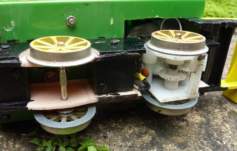

Post by DaveWatkins » Tue Sep 04, 2012 11:11 am
It was motorized with the works cut from an old toy car intended for toddlers. The gaudily coulored R/C handset can be seen in the pciture below.
Side frames are plastic sheet; I didn't bother with bearings. Wheels were bought from a trader at a 16mm convention. They had LGB size flanges which needed trimming to run on Peco SM32 track.
