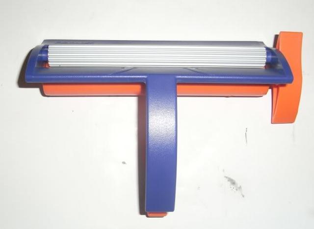

They are called paper crimpers. Available online, if the local craft shop doesn't stock them (all three in my area didn't). Make sure you get the type with extruded aluminium rollers, as the all plastic rollers are useless for anything thicker than paper.Keith S:67104 wrote:Peter, there are rollers that will do the job. They might be available at craft stores.
I found it was unsuitable for what I needed as it came. You need three hands to use it for a start, one to hold the device, one to turn the knob and one to feed the card or aluminium sheets. The knob didn't have much leverage for crimping something like drink can aluminium and the plastic body flexed as well.
I followed the advice of the friend who showed me the one he built for making scale corrugated iron and built a corrugating machine out of wood, using just the rollers.
Having nothing else to do at the time, this one also has an infeed table and guide to keep things straight. There is a cleat under the base that can be clamped in the vice so it doesn't slide around on the workbench and only need two hands to use it. The bolts holding it together allow the top roller to be shimmed, to ensure both rollers are exactly parallel and also allow adjustment for different thickness sheet material.
